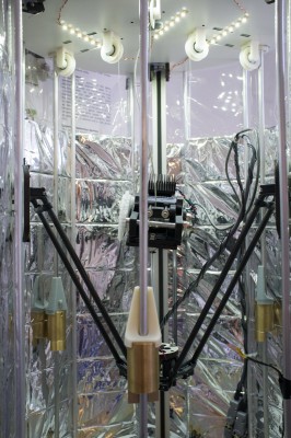

I am considering doing something similar, but instead of rubber bands, did you try doing it using just counterweights ?
If you need some elasticity, maybe the counterweights could be attached using a spring ?
Does it make sense ?

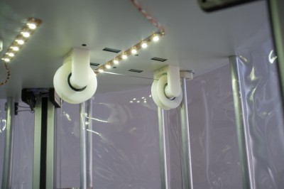

The rubber band solution was working great at the beginning, but they wore out over time, so I upgraded to the counterweight solution.
A plastic coated metal string is running over two ball bearing down to a moving weight.
The extruder is now really "flying" - negligible force influences to the end effector no matter at what position!

Is that a space blanket heated build chamber?
Re: The "Flying Extruder" Mod
Yes, it is. Get it above 40deg Celsius now.
It looks a little bit like a plant growing box.
