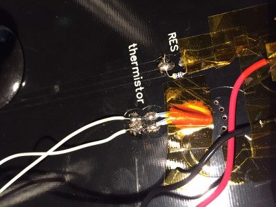

I don't really understand the readings I'm getting when I put a multimeter on the thermistor. I took the bed up and poked around the underside checking for a short and measuring resistance.
I checked the resistor and it gives me 4.7k as it should, but the thermistor is a different matter. Then again, I'm no electronics buff.
I get different readings depending on which side of the thermistor I put the red lead, different from what I understand of resistors in general, which is that it doesn't matter what direction the current flows. But on to the actual readings taken from the 2 solder points of the thermistor, not the points for the white wires.
red MM lead on thermistor + side (meaning the same side as the + for the 12VDC label on the bed, for reference)
5.12 on MM 20k setting
-4.3 on MM 200k setting
Then switched around so the black MM lead is on the 12VDC + side
9.9 @ 20k setting
21.9 @ 200k
These are just all different readings that make no sense to me. I repeated the tests and always got the same results, so at least it's consistently confusing.
I hope someone can tell me either what I'm doing wrong or if this is just a bad thermistor.
Also, should there be continuity between the 2 pads of either the thermistor or the white wires?
Thanks all.

Jimminy wrote:I get different readings depending on which side of the thermistor I put the red lead, different from what I understand of resistors in general, which is that it doesn't matter what direction the current flows. But on to the actual readings taken from the 2 solder points of the thermistor, not the points for the white wires.
9.9 @ 20k setting
21.9 @ 200k
The reading across the thermistor should be the same regardless of which meter lead is on either side. The thermistor is not a polarized part. Take the measurement with the thermistor lead unplugged from the RAMBo!

Ah, that changes things. Switched to the 200k setting I get a reading of 98.3 which I think is right.
