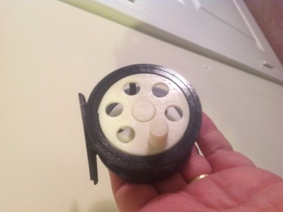

Here is my print of Michael's new version. Thanks for the file, I enjoyed making it today.
Re: 3D Printed Fly Fishing Reel
Looks great techstorage! Black and white is a classic combination. I'm guessing you sliced with Slic3r?
I just got some of the copper filled PLA and bronze filled PLA from ColorFABB (via PrintedSolid in the US). It is very interesting looking stuff. I can't wait to try printing a reel with it. It is very heavy. I think it is something like 80% metal powder filled.

mhackney its 90/10 metal to PLA i think... Its pretty hard to print with on the rostock... There are a lot of little things that need to be done... Most notably PTFE in the feeder, and slow it down.
Im running a new printed feeder, with 10-15mm/s for my copper and bronze.

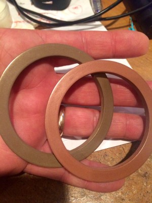

I am printing some test coupons of the ColorFabb bronze and copper to break test. I won't be surprised if they are quite strong, I've tried tweaking the rings in the photo above and no sign of cracking. It will be interesting to see the failure mode - clean break vs jaggy break.
I have the rings in a flow through vibrator with medium pyramid media. It will be interesting to see how that works. Everyone I've shown these parts to can't believe they are 3D printed. I'm really hoping I can use it for these reels.

I'd say great success. These parts look superb. No one believes they are printed.
I just got my roll of CopperFill this week so I am good to go now to print a reel in copper.

And they are heavy, like metal! I'm making a reel in cooper fill with graphite composite PLA side plates. High Tech!

I have Gene and the copper fill is very tough. It does not fracture like normal PLA, it sort of bends and then fractures. But I had a VERY difficult time breaking it.
Not scientific I know. The good news is, I have 2 friends that work at or for Instron so maybe I can get some testing done!
