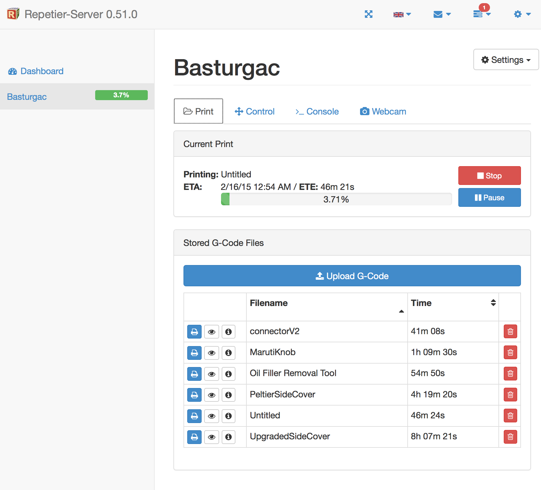

This is what the webcam view of repetier server looks like.
It seems that for the webcam view to be functional i need to remove the ring light and add lights to the sides, behind the camera. So new G-codes will be necessary.
And here are some other views from the software.
