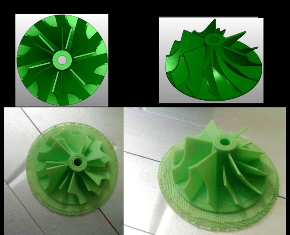

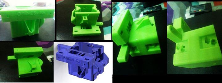

I did this with latest version of Marlin Firmware . so far so good...never tried Repetier...

Khalid Khattak wrote:I did this with latest version of Marlin Firmware . so far so good...never tried Repetier...
Hey khalid can you share your slice settings? Those prints look really good. Are you actually using the compressor pump print? Or whatever those bladed things are?
