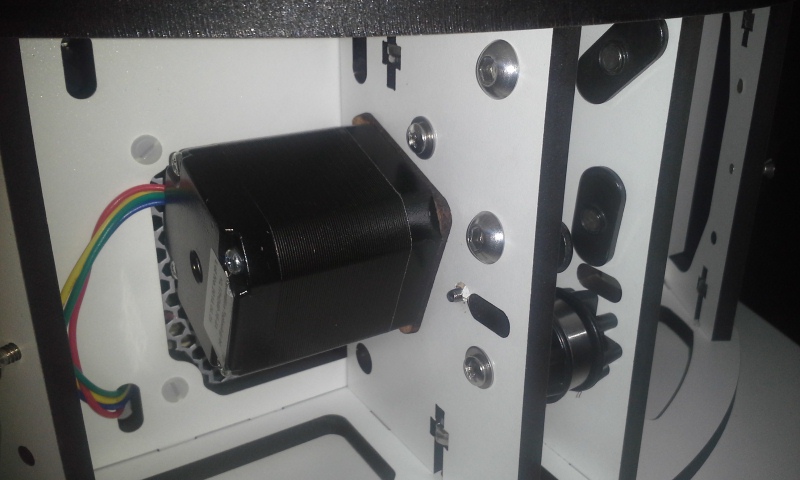

Got some burgers. Back to work. Got the Trick Laser stepper dampers installed. They compressed more than I thought. I had to readjust the depth of the belt drive gears. Next the top went on. Got that on pretty easy without even screwing down one side. Pretty slick kit so far. I am impressed.

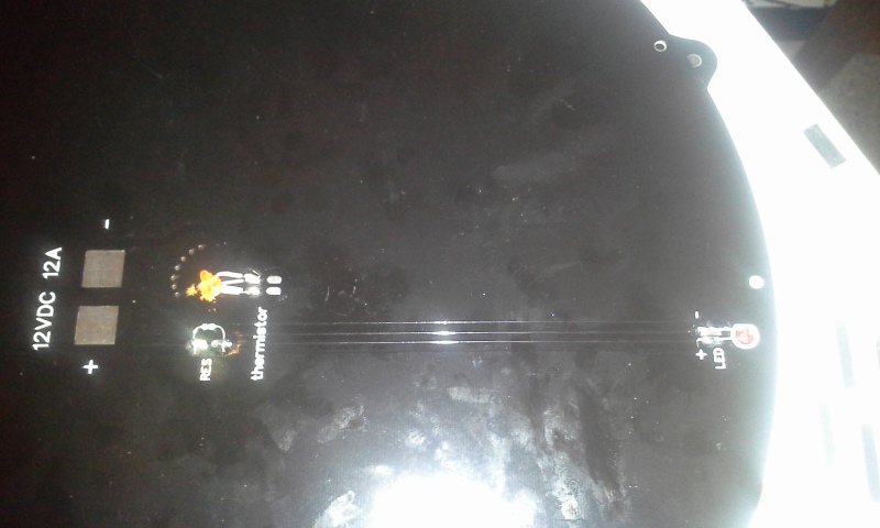

I was tripping there for a second. I put the glass plate on the heated bed and it was all wobbly. about 1-2mm on one side if you pressed the opposite down. I looked and looked going W.T.F. The damn kapton tape on the bed thermistor was folded over sealing it up just like it is supposed to. It is not even tacky yet. I put the glass away...

It seems that my heated bed is domed in the center from the get go. How to fix this? No its not the kapton tape this time.

Check to make sure the wires between the snowflake & the base aren't bundled up and pressing up on the back side of the Onyx plate.
If the Onyx plate is removed from the snow flake, is it still domed when unmounted?

I will check the wires under the bed. I suspected it might be something like that. I put a small zip tie on the wires under there. With the spacers it shouldnt be bound up but it might be I guess.
Re: drunkenmugsy's build thread
If you put on the glass and clamps around the edges is the doming still present?
