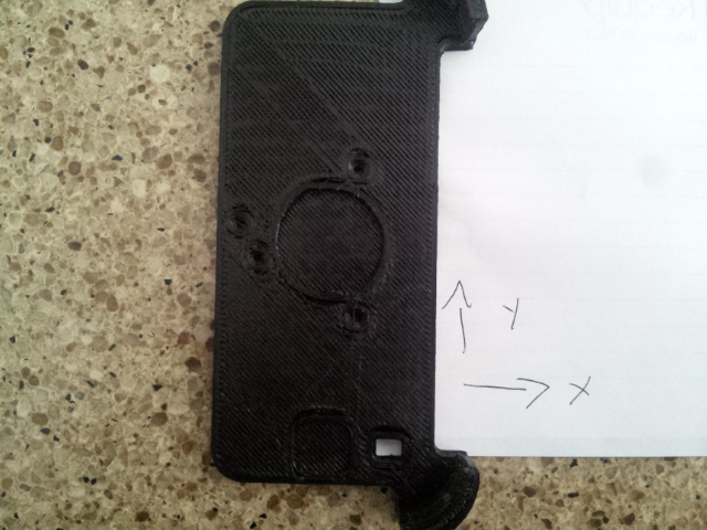

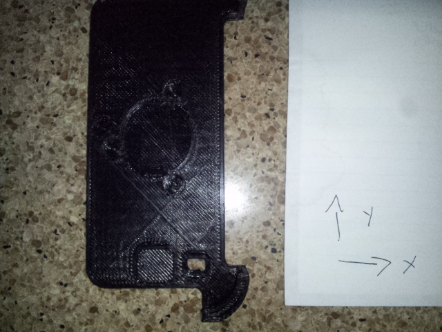

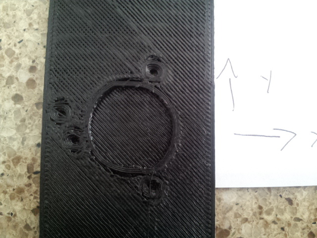

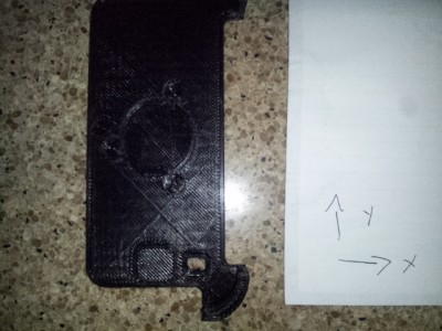

so i have trouble calibrating my h1.1. i am not sure at this point what my issue is. i am using sprinter and repatier host for software. when i put my calipers on the x and y axis and measure how much it moves for a 10mm command it actually moves 10mm. but when i go to print things they come out larger then they are supposed to. also it doesnt make perfect circles. i know it is never going to make a perfect circle but it should be alot closer then it is. i print ovals:( i have included pictures of a galaxy s3 car mount. the car mount came out about 3/8 of an inch too long in the y length. also if you notice the holes are not circular. any help would be great. thanks.
Re: trouble calibrating the h1.1
The circle issue is classic backlash, looks to be worse in Y than X, you're Y bely is either too loose, or it's rubbing badly on something, probably the former.

so i tightened the belts and it definetly helped. now the question is how nice should my prints be coming out. i see the prints of the rostock max and its amazing? should i be able to produce prints of that quality? what are some tricks to getting the best prints possible?
