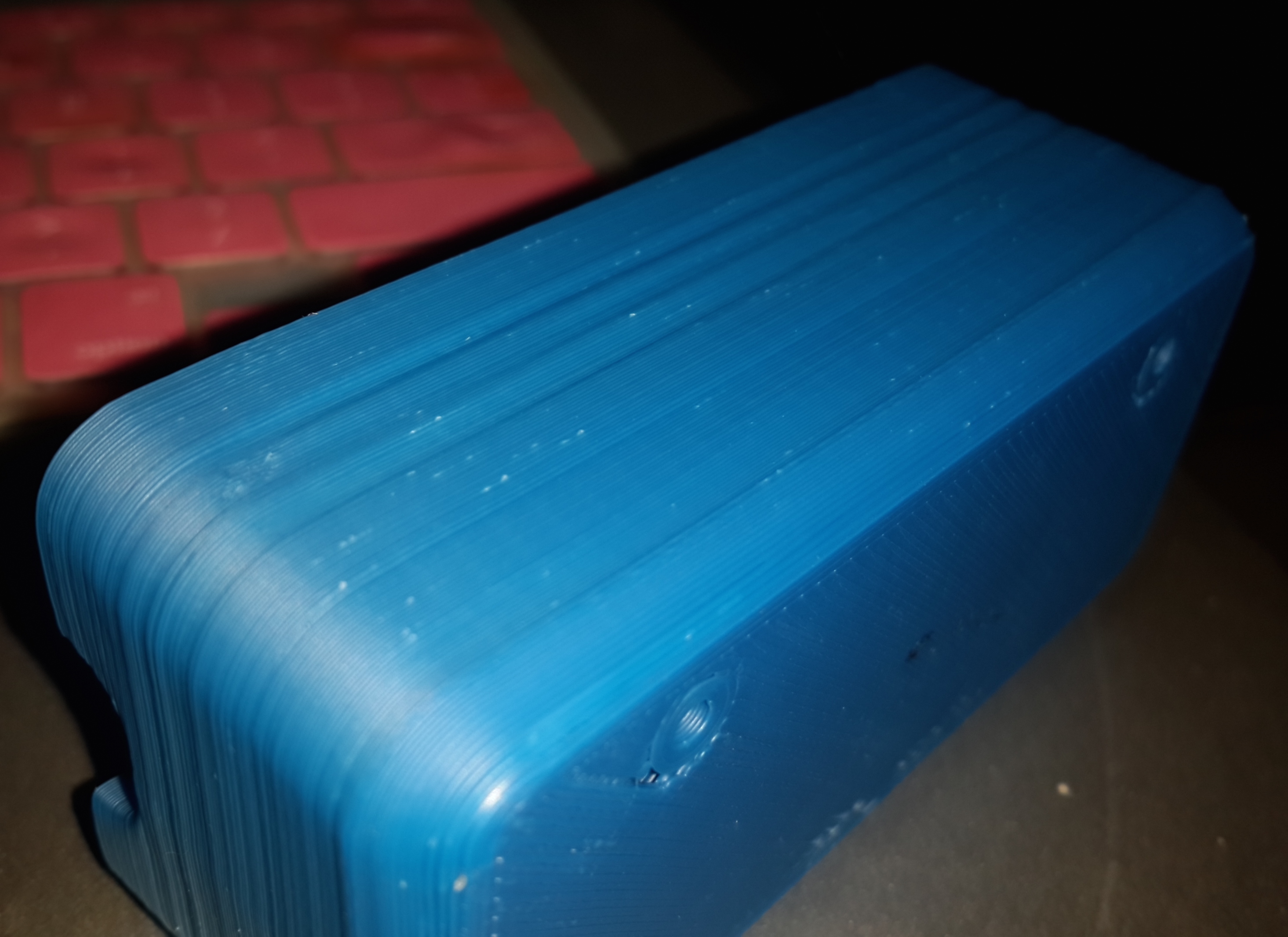

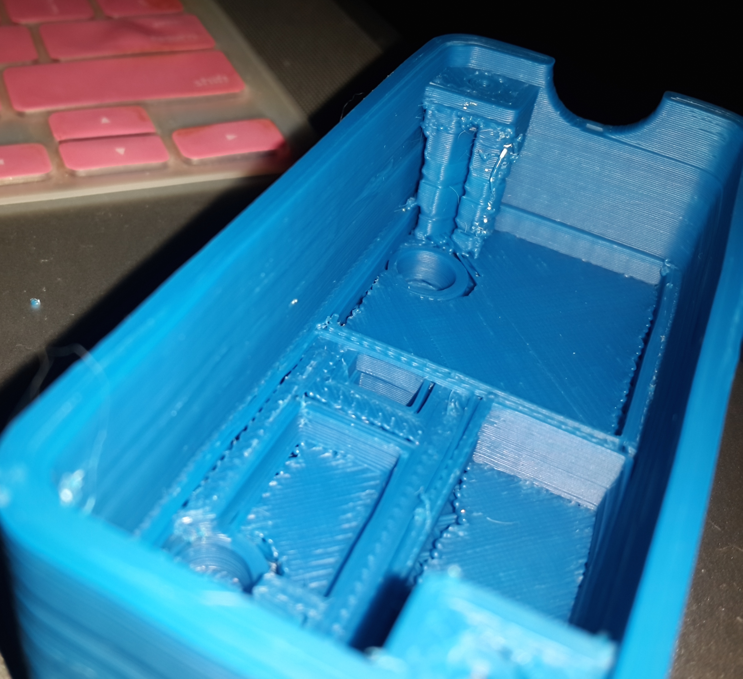

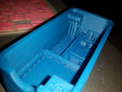

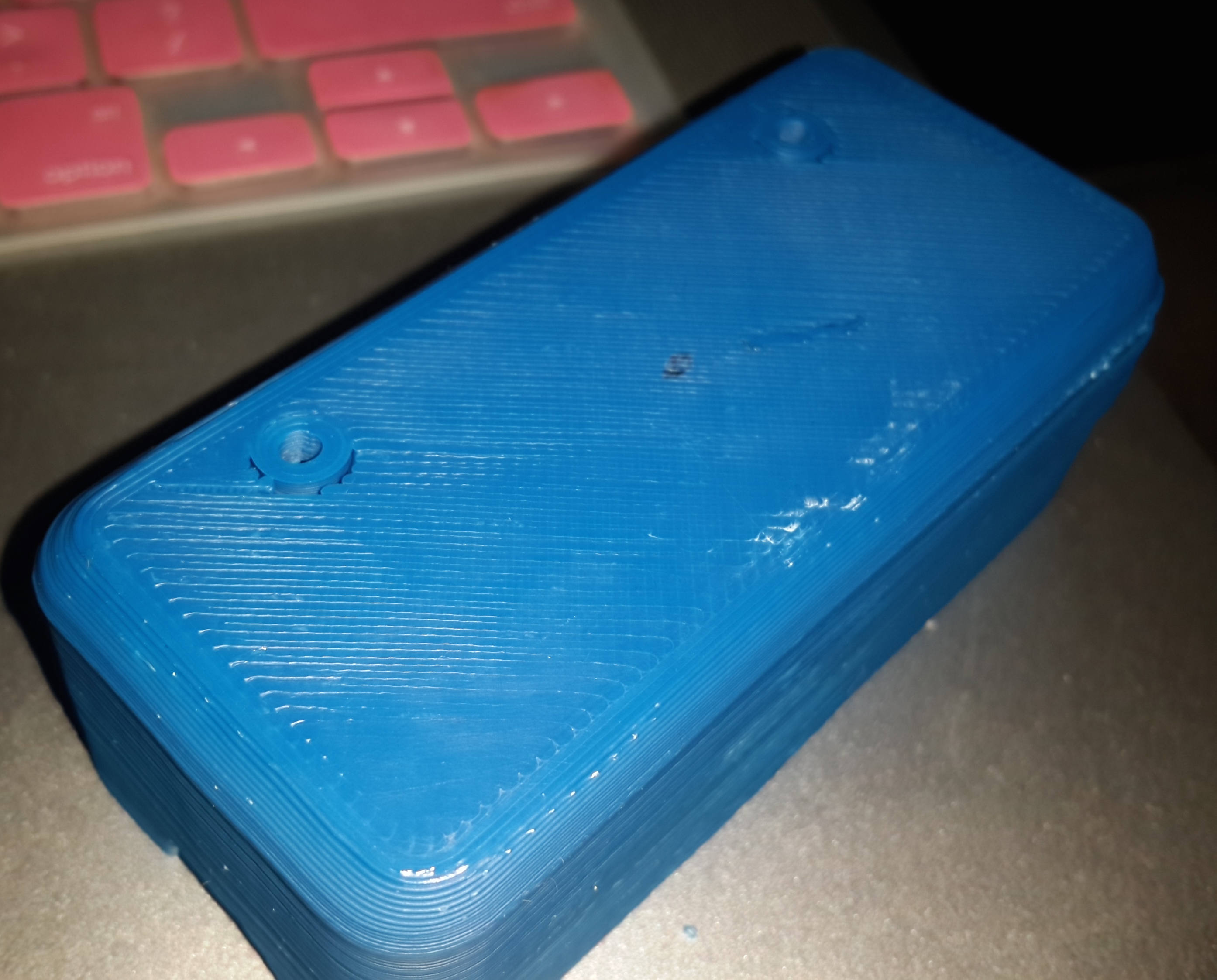

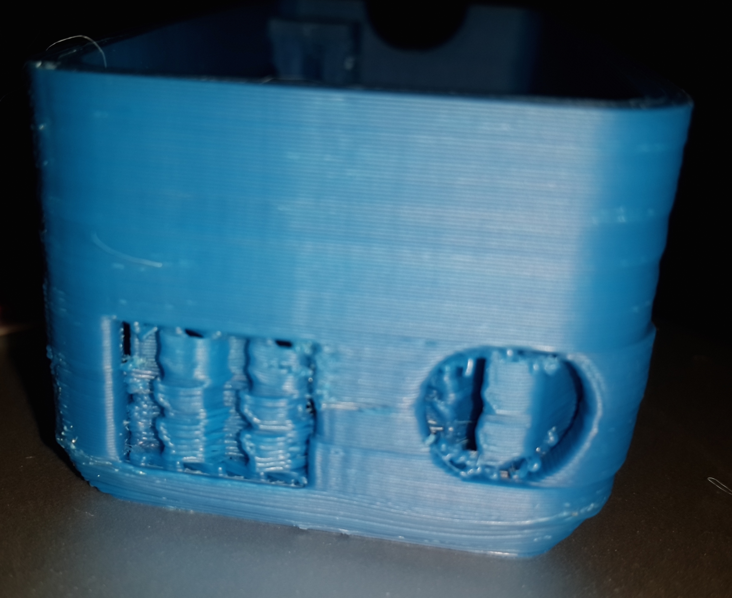

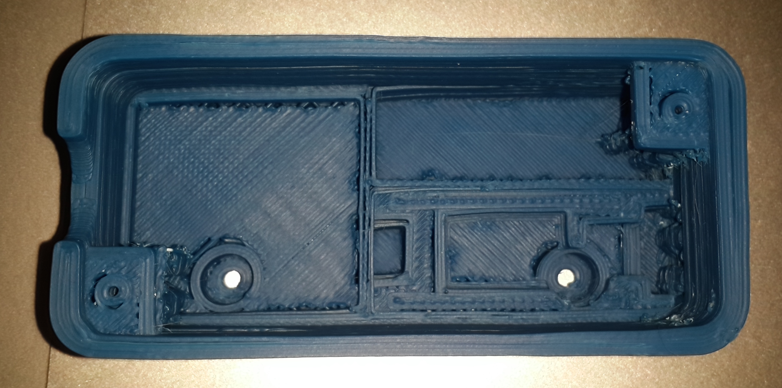

I am having some issues with printing lately.
Hollow calibration cube of 40mm x 40mm turned out very nice.
On more complex parts, it looks as if the circles and square like features are hand drawn. Some solid layers do not reach the perimeter and there are some shifts that propagate to the outside "shell" depending on layers inside the print.
I discovered that the motors were loose. Fixed that but it did not improve the problem.
Belts look to be tight.
The cheapskates are on tightly enough.
Same results with matter control and S3D.
So I am a bit puzzled here.
Things look like hand drawn.

Check your belts, pulleys, cheapskates, Ujoints, anything that moves. If you have the metal joints there's a possibility that they could be binding. You seem to be getting the extreme side of delta arm blues. Do you have the aluminum u-joints? There is a good chance they could be binding, it happens quite often.

Try lowering the flow rate, it looks like you might be over extruding.

My u joints were all a bit crunchy and one was even completely seized.
2 hours polishing each rod with metal polish and then the insides of the aluminium pieces with a toothpick an then putting engine oil on the shafts made the movements much smoother.
I often check the end effector movement. But maybe i check it too often as MY calibration has also shifted with time. :)
Fired up a print. I shall see tomorrow how it turna out.
