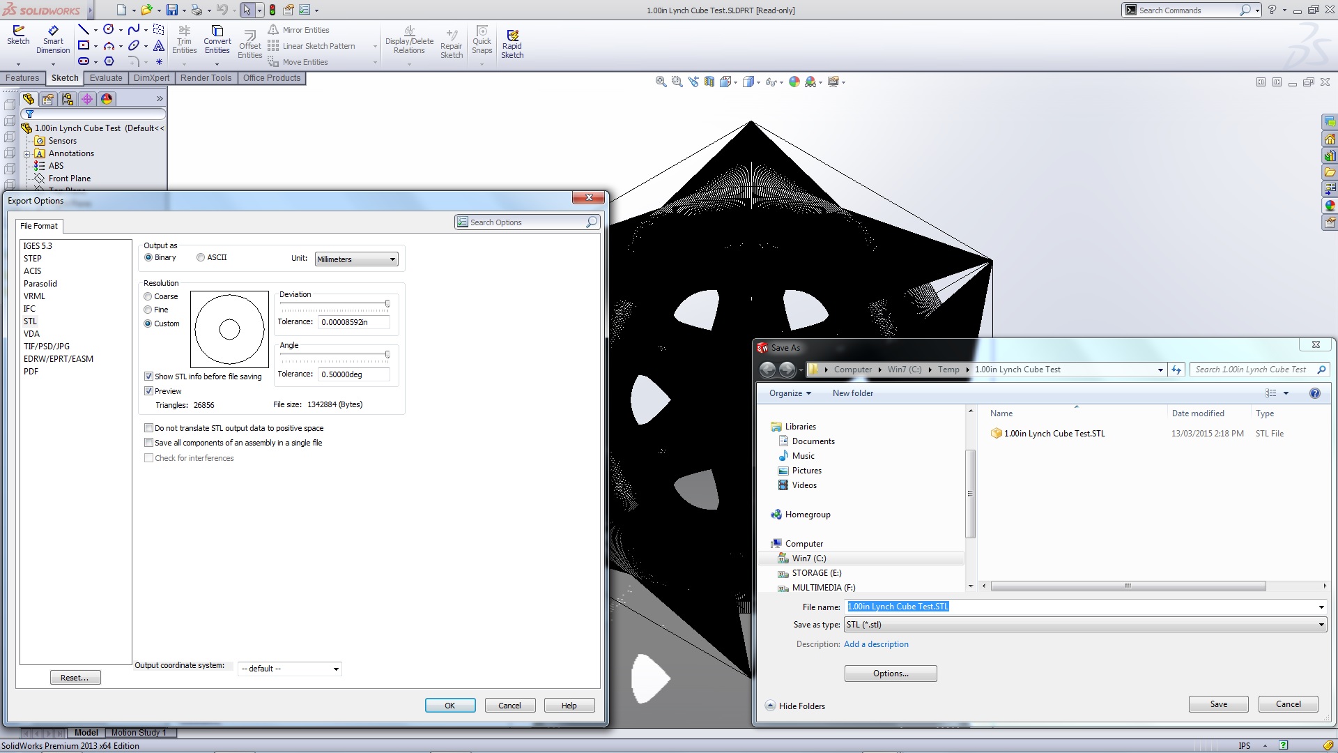

Can someone please help with this? Maybe I'm missing a setting somewhere??
Whenever I slice in MatterControl's MatterSlice I get very bad/weird circles/arcs... It's like it's making "large" straight lines to make up a circle. I understand that it won't use G02 & G03 (not very smart!) but the triangles created are so small that it should look descent as it does with Sli3r, Cura and S3D.
Using SolidWorks, exporting at the highest possible settings for .STL and setting them up with the same (and tried different) settings in MatterControl's MatterSlice, MatterControl's Slic3r, MatterControl's Cura and Simplify3D.
In Simplify3D I get beautiful circles/arcs.

Here are the screenshots of the part and the export settings to .STL from within SolidWorks.
SolidWorks File:
1.00in Cube Test - SolidWorks
SolidWorks Settings for File:
1.00in Cube Test - SolidWorks Settings
I've noticed before on other "round holes" come to think of it from downloaded things from Thingiverse, that there was this "basket weaving" action taking place only using MatterSlice withing MatterControl.
Is there a fix for this? Export at a much lower resolution??
Thanks again for your advice/help!

Given your images of the export I'd say it's a MatterSlice issue, it's probably re-samplng the geometry, I don't use it so I can't comment on if there is a setting to fix it.

I also run very high resolution exports from Solidworks but I haven't run MatterSlice. I'm guessing its a tolerance thing in the slicer, whether an option or hard coded.
A quick hint for STL export - click the 'do not translate...' check box, it'll make it easier to export multi-body parts.

Quick Update - This issue have been identified and addressed in MatterSlice. The fix will be included in the next MatterControl update.
More info on the problem here:
https://github.com/MatterHackers/Matter ... issues/204
To quote:
The final analysis of this was that this model was exposing a very subtle bug in clipper. If there were a very large number of edge points on a relatively shallow curve, one can't just merge each as they walk the curve in order or they can collapse curves that have small enough inter point deltas but a large total curve.
Imagine a very tessellated circle. As we walk the edge, each triple we find can be collinear within our error and so we remove the middle point and move on to the next point. The new middle point is very close to the new third point and so we collapse and remove the second point. We can remove and create a large flat on the edge of the circle.
