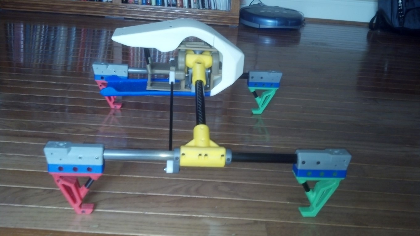

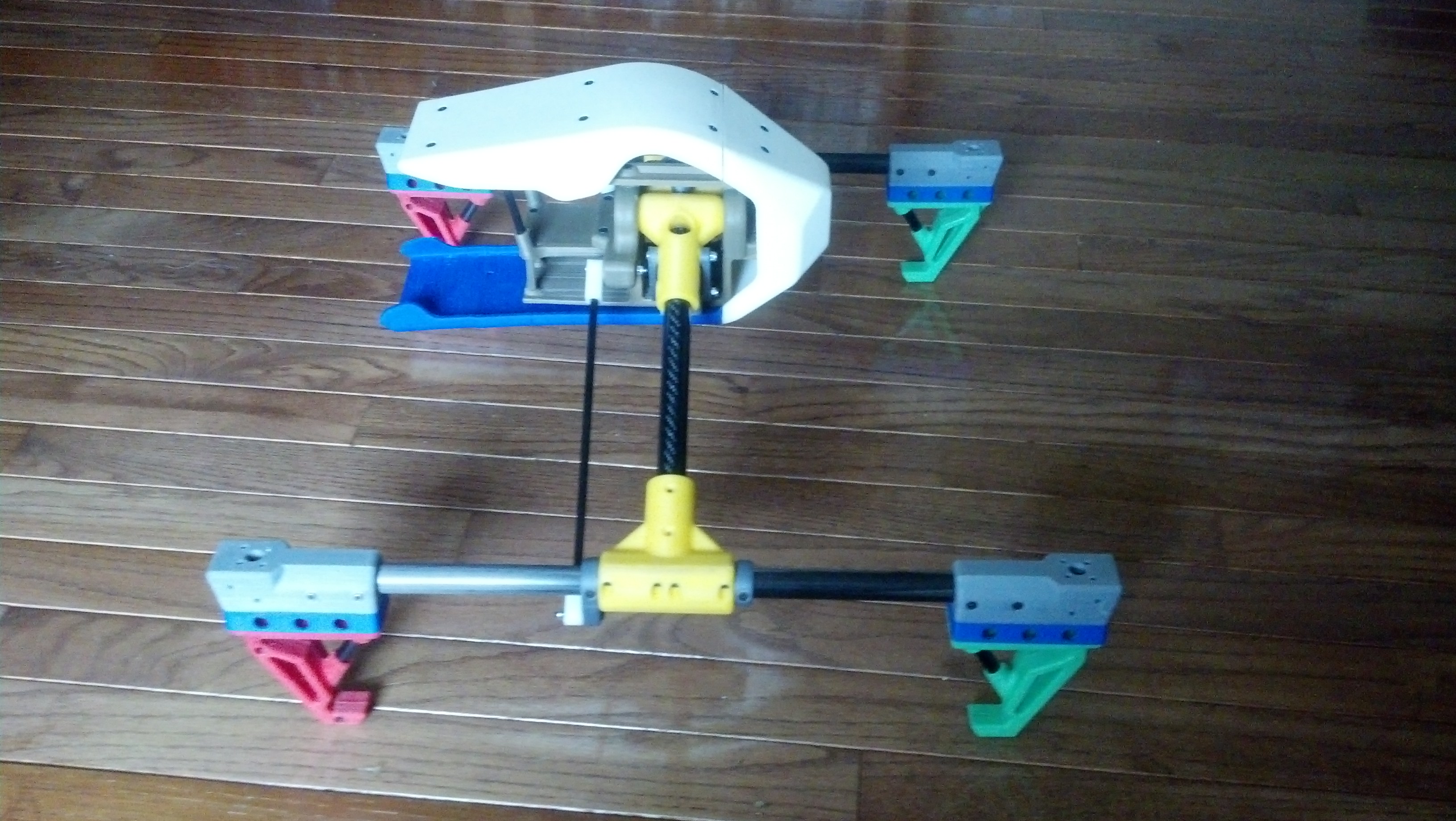

After sitting on the fence for a while I have decided to build a QuadCopter. I was really attracted by the DJI Inspire 1 when it was introduced but the $3000 price tag made it not a possibility. I then saw rchobbiesuk.com version of the machine and saw that it was designed to be entirely made by 3-D printing with a smattering of Carbon Fiber and other expensive bits.
Purchased the .stl files and away we go. The design is very well executed with parts fitting exactly after printing. Parts like the Tail Canopy bridge three printed parts with 6 screw holes and line up perfectly.
So I am printing the air frame primarily from HIPS. Weight so far is about 600 grams but the final weight with a battery on board is likely to be in the 1900 gram range. The arms rotate to transform between landing and flight and pivot on the same bearings used in the Cheap Skates.
Hopefully it will fly as good as it looks. One change I will likely make is to add a battery pod below the existing frame and canopy. The space inside the frame is just too close to fit in a 6S battery of ample size.
The photos so the state of the air frame this morning. There are several more parts to print including two more motor pods, the arm linkage and remaining canopy parts.

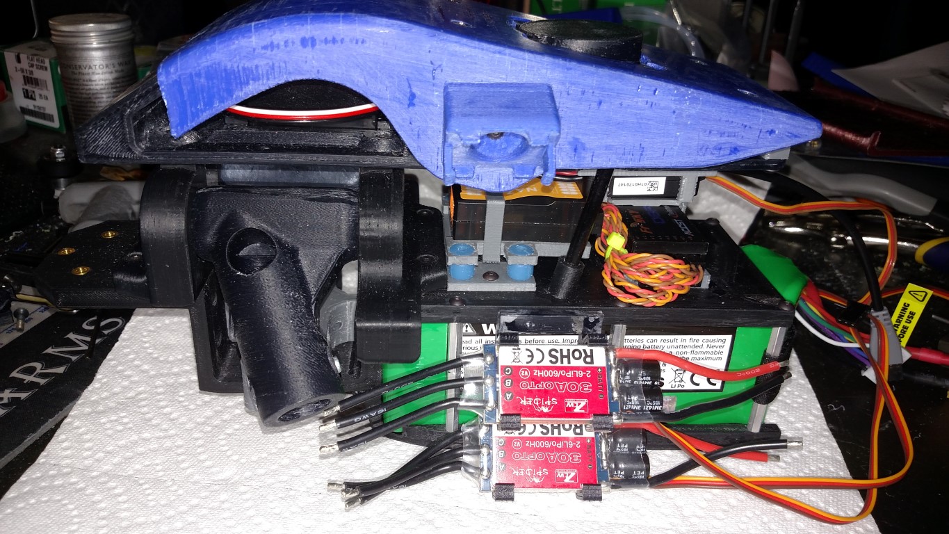

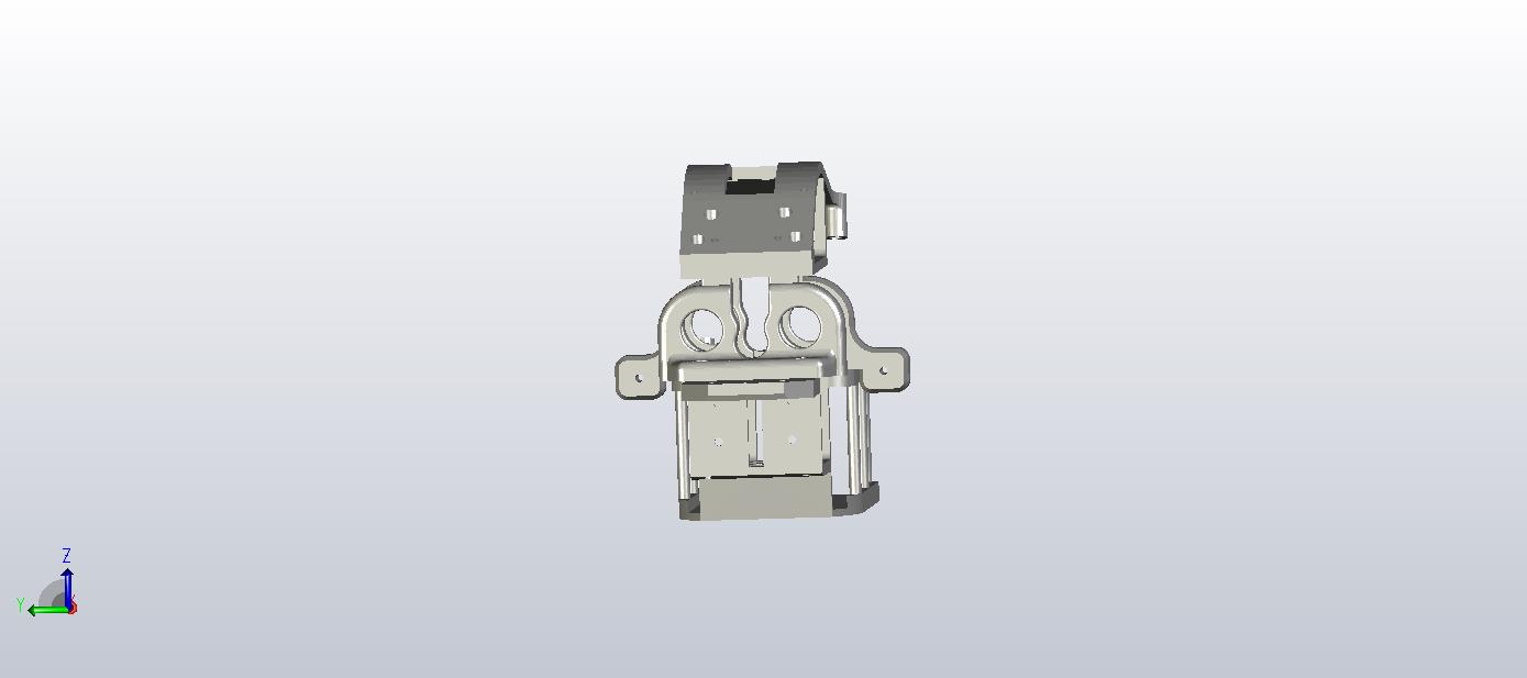

A little more progress. It is now apparent that there is not enough room in the frame for the "stuff" required. The current battery bay is 35mm high x 35mm wide x 65mm long. I have redetailed the frame to expand the bay to 55mm high x 65mm wide x 145mm long while keeping the same canopy outline.
The pictures show the as-furnished frame. I am now starting to print the 3/4 Ton - Long Wheel Base Model.
It is coming together. Looks like the AUW will be 2750gr +/- with an 6S 8000mah battery. With 3508-380kv motors and 1447 or 1550 props the available payload should be about 1300gr. We will see.

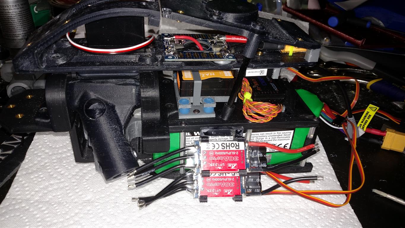

Thought I would update my progress status. Travel has kept me from making as much progress as I would like but it is coming a long. The first prototype was printed from whatever was in the printer when the time allowed. Because of the mix of materials and colors, it was nicknamed "box of crayons". After evaluating the prototype, several areas requiring attention showed up. Primarily there was no room for the required electronics and the battery area was VERY small.
So many parts have been resigned/modified by me and several others to improve the breed. The lower deck has been widened and extended to accommodate an 8000mah 6S battery. The second deck has been expanded to provide room the require electronics, a NAZA V2 Flight Controller and Telemetry Receiver. The third deck was extended to provide space to mount a Power Distribution Board and the NAZA Power
Module. ESC's have been rack mounted between deck 1 and deck 2 and will be later cover by a printed cowing. The arms have been swept 20 degrees to compensate for the CG shift resulting from the added battery weight. Booms and Arms have been extended to allow the use of props up to 16". The diagonal Motor Center to Motor Center is 690mm. All Up Weight is 3.2kg, I am using Tarot 4114 330KV motors with 15.5" props and eCal predicting a Payload of 2+kg.
I have a large box of rejected printed parts, these include obsolete parts, design iterations and not so good quality parts. Many parts have gone through several iterations. I have replaced the rigid landing struts with landing gear made using a spring coil over shock. The printed parts are on rev.10 and the design on rev.16.
This has been a lot of fun, however, if my time was considered to have any value, I could have bought a DJI Inspire for less.
I have several days to a few weeks to finish depending on travel, I am in Perth now and return to leave for Amsterdam but the quad will finish this summer.
Now just hope it will fly.
