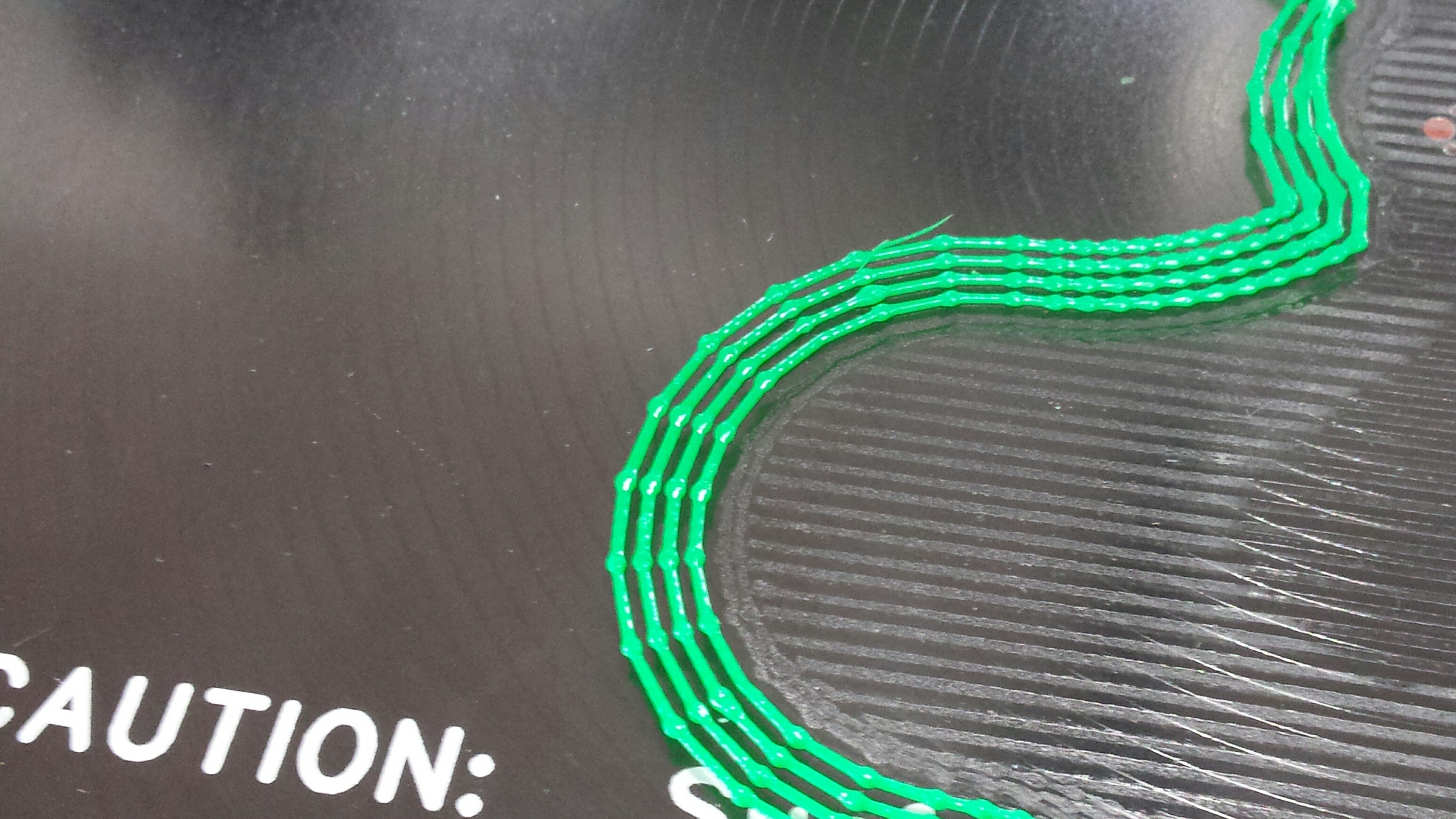

hi everyone,
seems my slicer (mattercontrol) likes to put little dots of material every few MM when I print a radius, any size radius. I have tried different settings, coarse standard and fine, it does it printing perimeters also, and the print, is there a Gcode setting I can add to the start G code,.... MHackneys prints look amazing, and I have gotten my stringing issues solved thanks to his work, just need a bit of a tweak to the code and I think I will be golden.

here is what it looks like, it is on all the radius of the print small or large even long radius show the dimple. it almost looks like an extrusion after retract dimple, or should I say a bump. the printhead stops deposits move stop deposit. it does this when drawing perimeters, and for the entire radius of the print. I did a set of the tensioners for the max, all the radius look the same. seen this mentioned somewhere else here I just cannot seem to find it.
randomize start point is not on, at least I have not seen it in mattercontrol, I thought it might be a good idea to prevent lines in the print, sound like it is not.

I haven't seen anything exactly like that, but If I had to guess, I start by checking you extruder calibration, you can sometimes get an issue where plastic get's backed up in the extruder then released in blobs, but to get what you have, you'd have to have a lot of over-extrusion.

Does it pause at each of those points?
Mine does that while printing skirts for some reason.

it does pause at each point and move on, you can see by the linearity of the spots it looks like it is programmed to do this. I have tried several objects including ones I drew myself in 123Ddesign. I am printing off usb. I will try it off a SD card.
@polygonhell:
I did the extruder calibration you posted a while back. and just double checked it 2 days ago. I know it is not perfect, I use the extrustion multiplier printing at 1 on the bottom few layers, then bumping it down as the print moves up, at the top of some prints where its just printing edges, like the guano fan blower, I moved it all the way down to .90 it made all the stringing go away at the end of the print. printing 2 of the object helped a lot also. it stops and prints like it is doing an infill or when you see the printhead feed after a retract and move.

You can make repetier pause like that if you mess with DELTA_SEGMENTS_PER_SECOND_PRINT, this is available in the EEPROM.
Can you take a look at what you set it to?

Those pauses will do exactly that, the pressure in the nozzle will dump excess plastic out and make a blob, then not have enough pressure to extrude full width after that.
This happens to me only on skirts, and I'm not sure why. Its worse when I print from USB(repetier server or octoprint). Printing from a windows PC has always been very hit or miss for me and I won't even bother anymore.

Its at the end of every line segment in g-code.

I do not see a delta segments for print I do have a setting that is segment/s for printing set to 180

180 is reasonable, so I'm going to guess it's noise on the USB cable, have you tried printing from SDCard?
I'd grab a different USB cable and try that as well.

it is doing the same thing to the perimeter off the SD card.... it must be in the Gcode.
