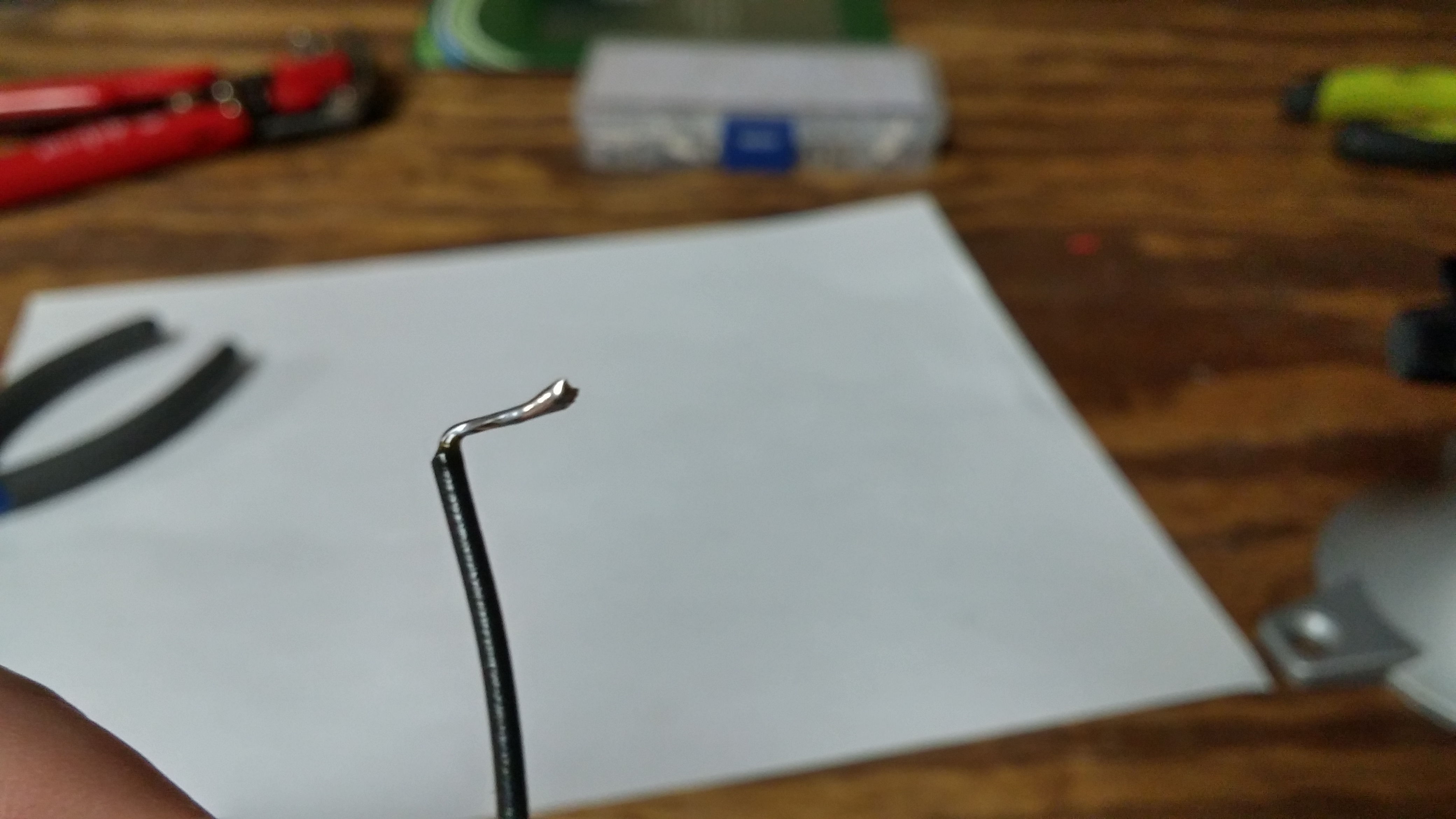

Take your fuse holder and strip about 1/4" of wire off of each end.
Then bend the wire at a 90degree turn.
Go ahead and heat up your soldering iron. Once it is heated up, tin the ends of the fuse holder. For those of your who don't know what that means, it means put a thin layer of solder over each end.

Once it is in the vise, take your soldering iron and put a bit of solder on there. You want a little bit of a glob. With one hand grab a wire from the fuse holder and place it directly on top of the metal portion of the fuse(left or right side, it doesnt matter). With the other hand, grab your soldering iron and press it on the wire(with the glob of solder on the iron touching the wire). It should very quickly melt the solder and flow to the fuse. Do a stress test to make sure it is pretty strong and that it is not a cold solder joint.
Repeat for the other wire.
