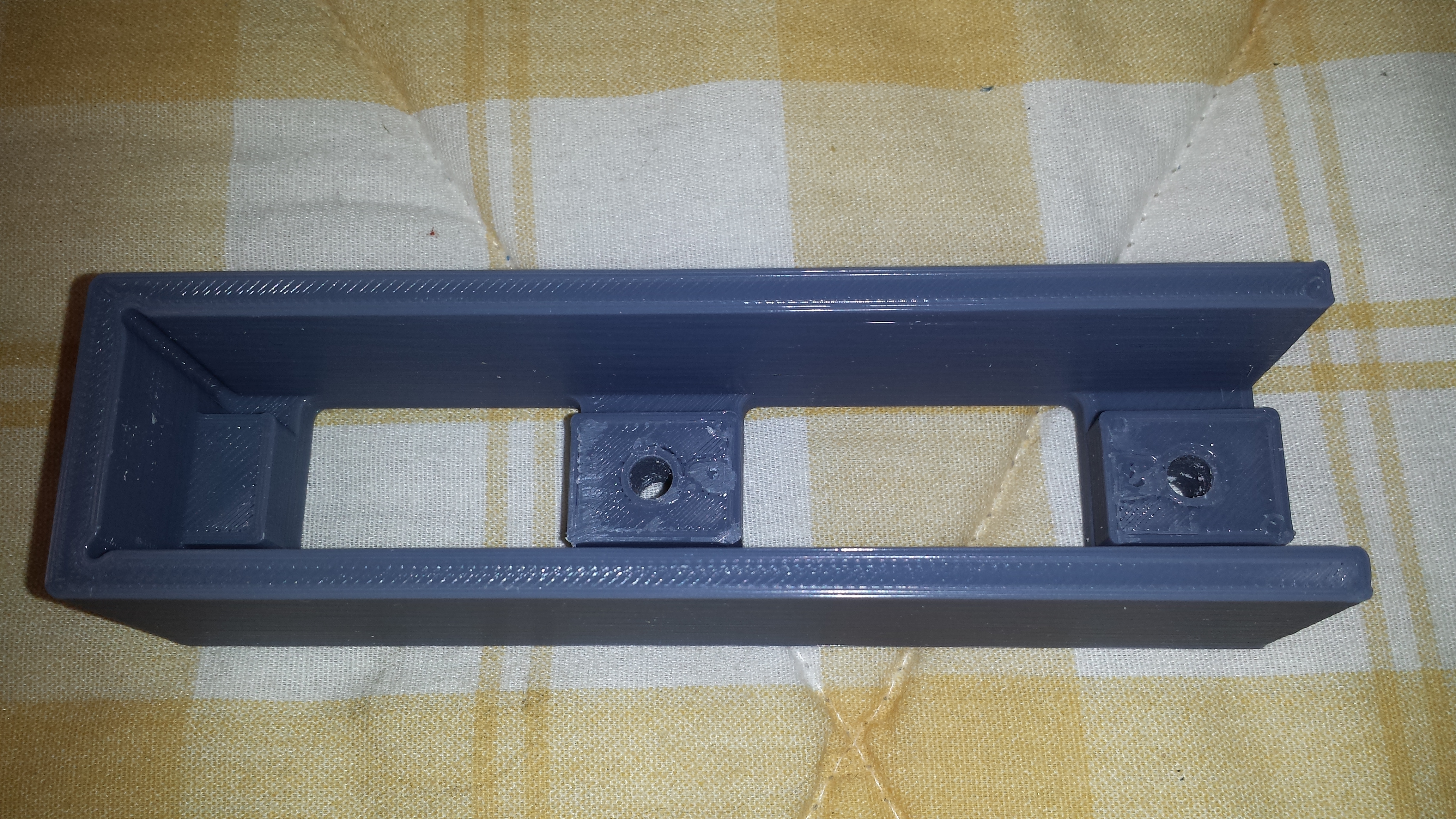

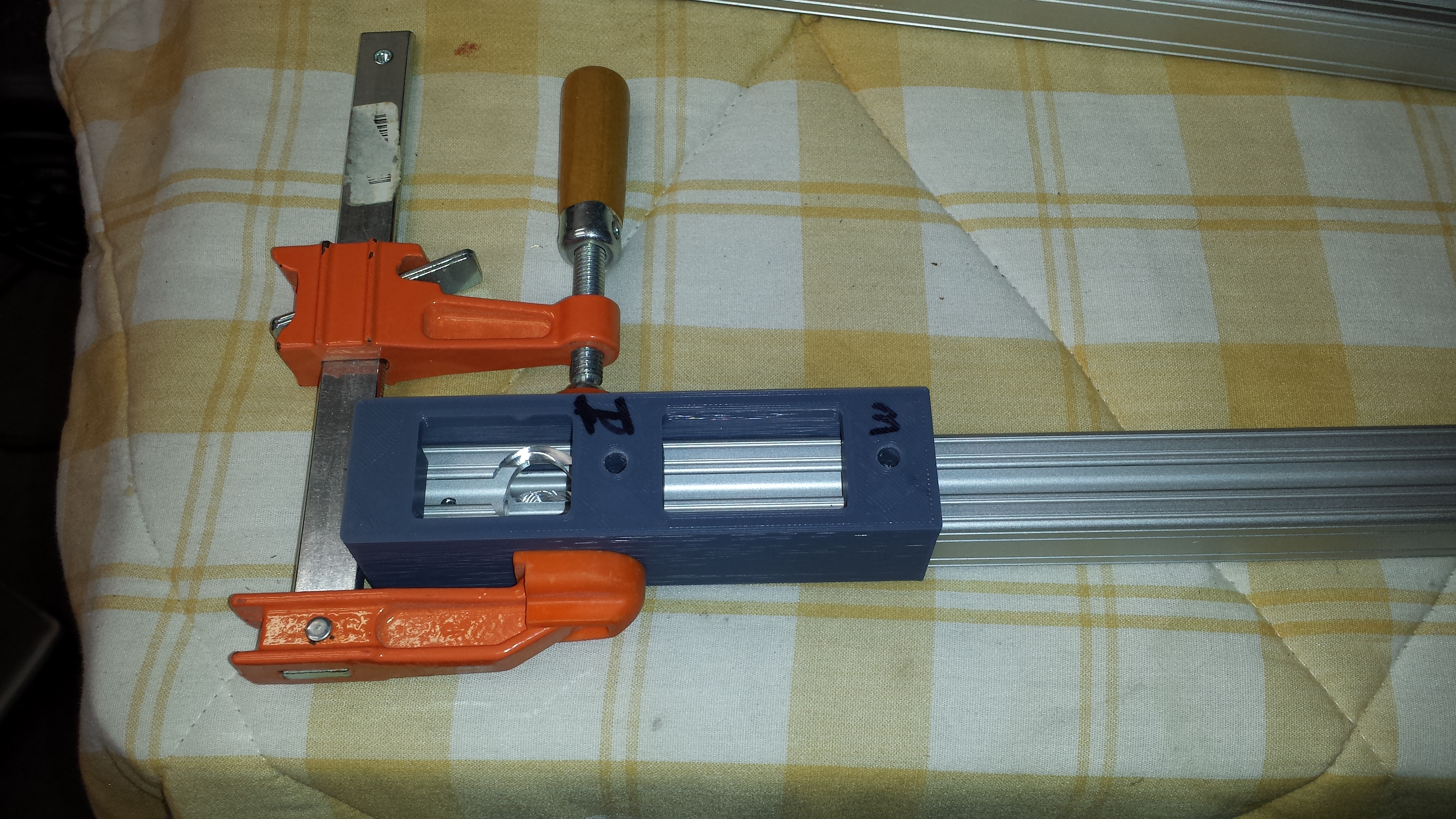

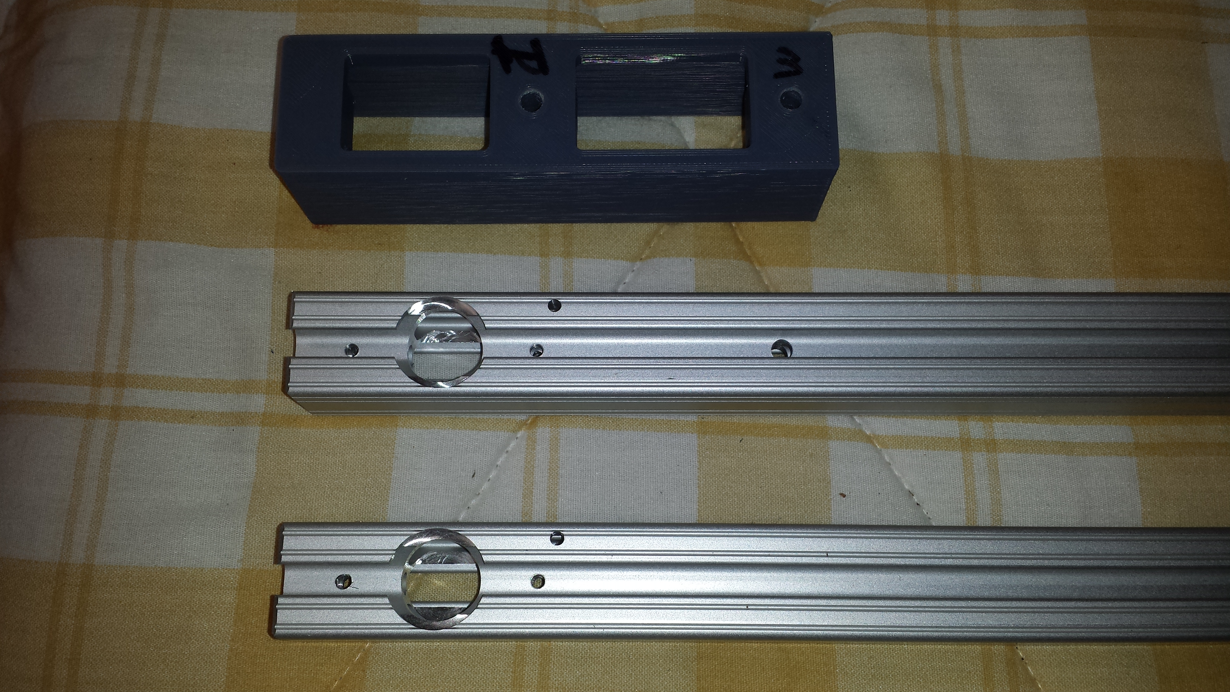

The physical build begins.....
I wanted an easy way to locate the drilled holes to run the end stop wires through the extrusion without making an ugly mess. Better put the 3D printer to use and print a drill jig!
I simply clamped it in place making sure it was registered on all surfaces and used the drill press to poke .201 holes through the extrusion. The jig has two hole locations for the motor end and the idler end of the extrusion.
The drill guide has been added to GitHub.

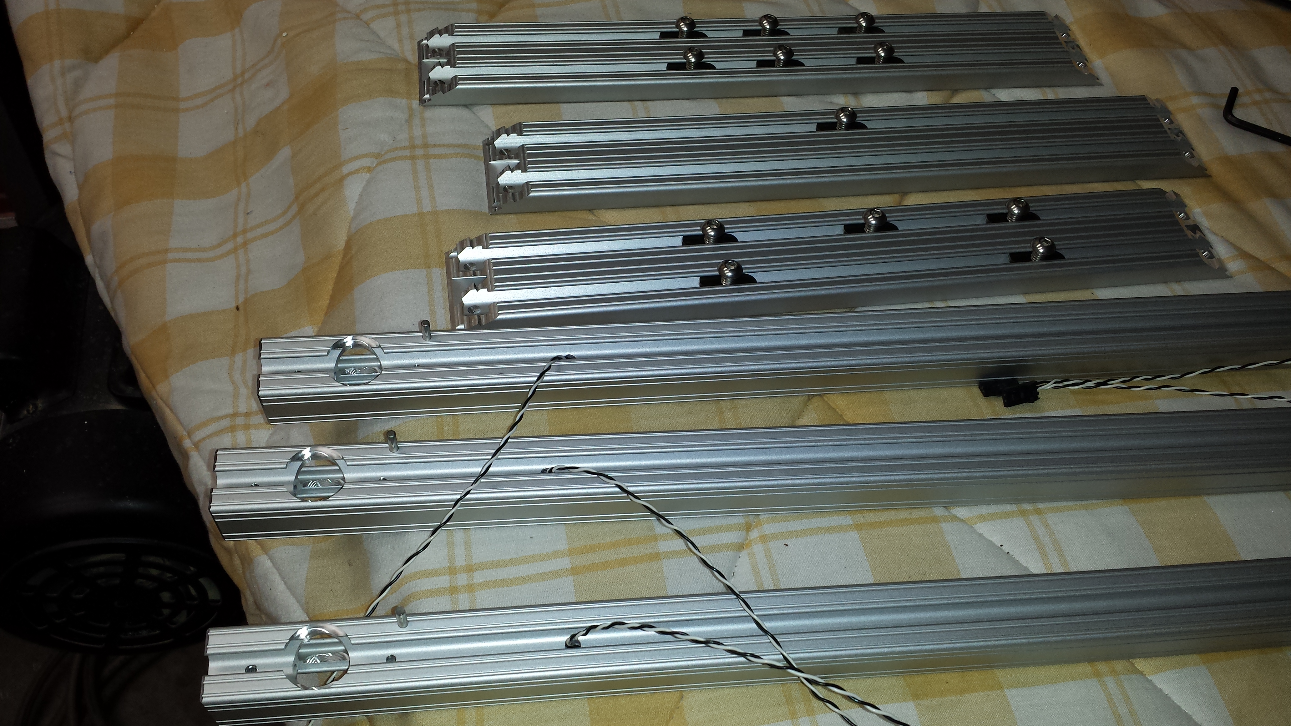

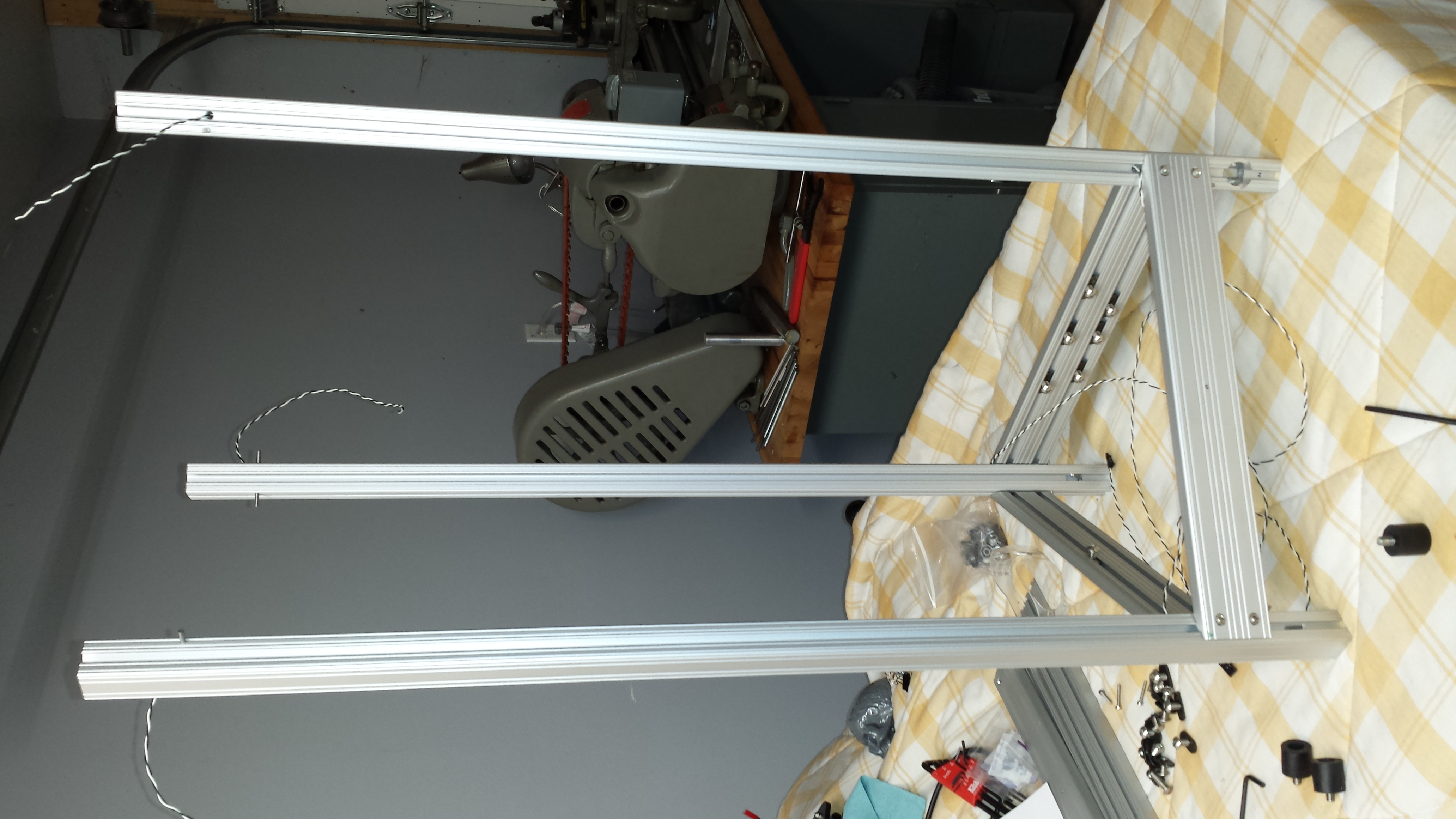

Before I routed the wires, I pressed the locating dowels in place.  I don't have an arbor press, so I closed the chuck on my drill press and used it to press the dowels.
Be very-very careful you do not press the dowel in too deep where they will interfere with the belts or you will not be happy.... I would avoid use of a hammer at all costs. Just go slow and careful.
After the dowels were installed, I routed the end stop wires. The drilled hole size was small enough the pinned ends on the end-stop wires would not make the bend. I elected to cut the spade terminals off and feed that end starting at the motor end of the extrusion. There is a fair amount of excess wire, so I will "end" of shortening those anyway. I avoid messing with the little pins which is why I cut at that end, but you could cut the other end as well. If you use Brian's suggestion of the packing strap or use the external wire conduit, you can avoid cutting and drilling altogether.
I'm a bit sensitive to EMI issues as it's part of the day job, so I prefer to use twisted pairs and distance it from everything else if possible.
I placed the reclaimed t-nuts and screws into the frame and snugged them up so they would not slide out during assembly. Disassembling the frame will take a persuader, so don't forget your nuts! You can get the drop in style at a cost if you need to add some later.
When assembling, work your way around and tighten enough to hold the frame together, but not enough to draw it tight. Get everything together first to allow it all to seat squarily and then snug it all up. Bottom horizontals and verticals together, but not snugged up tight. I should receive the idler brackets today if the post-lady does not deliver my parts to the next street over again and will resume the build.

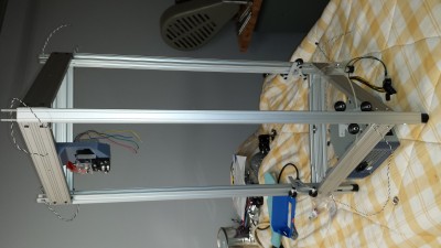

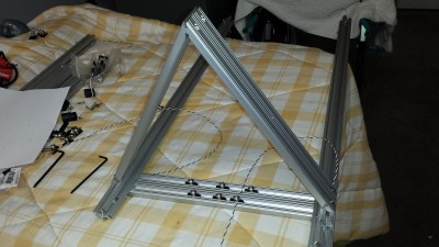

Idler brackets showed today.... Thanks Brian!
Frame is together and tight. I've checked square using my Wixey digital gauge as well as drafting triangles. Top and bottom horizontals are all parallel to each other. With the glass plate set across the horizontals and used as a reference, everything is square.
The distance across all corners is within .0025".
I am ecstatic with the build and accuracy of this frame!
Assembly tips.
Assembly tips.
- Make sure the horizontals are firmly seated against the dowels before tightening
 - Use some anti-seize on the stainless bolts when they thread directly into aluminum. Aluminum and stainless can gall on rare occasions.
 - Slowly work your way around the frame and snug a turn or two at a time. Keep circling and alternative top to bottom until tight.
ccavanaugh wrote:Idler brackets showed today.... Thanks Brian!
Assembly tips.

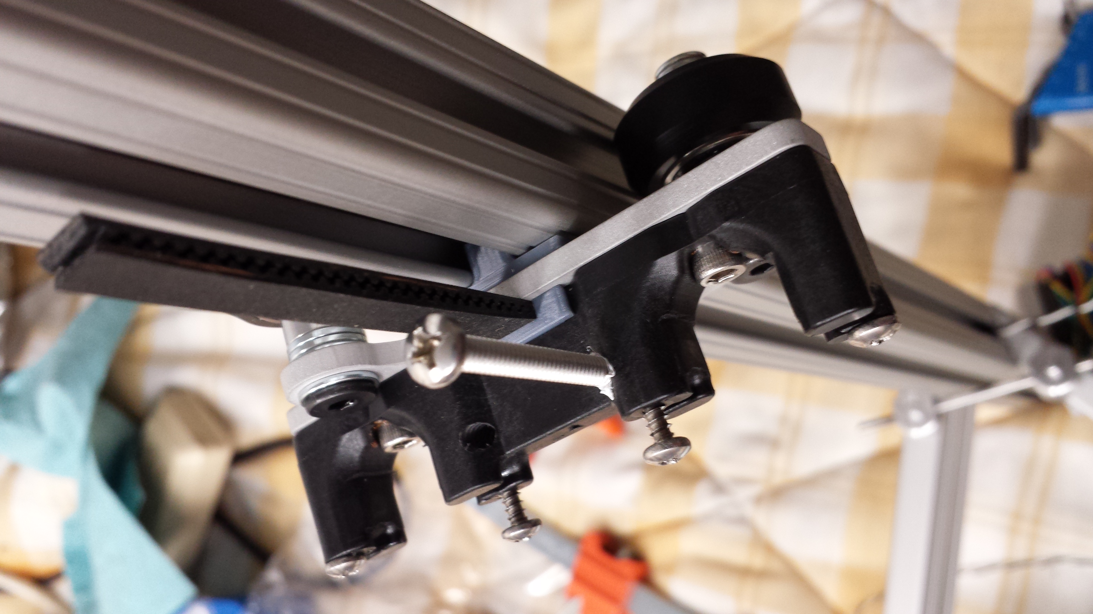

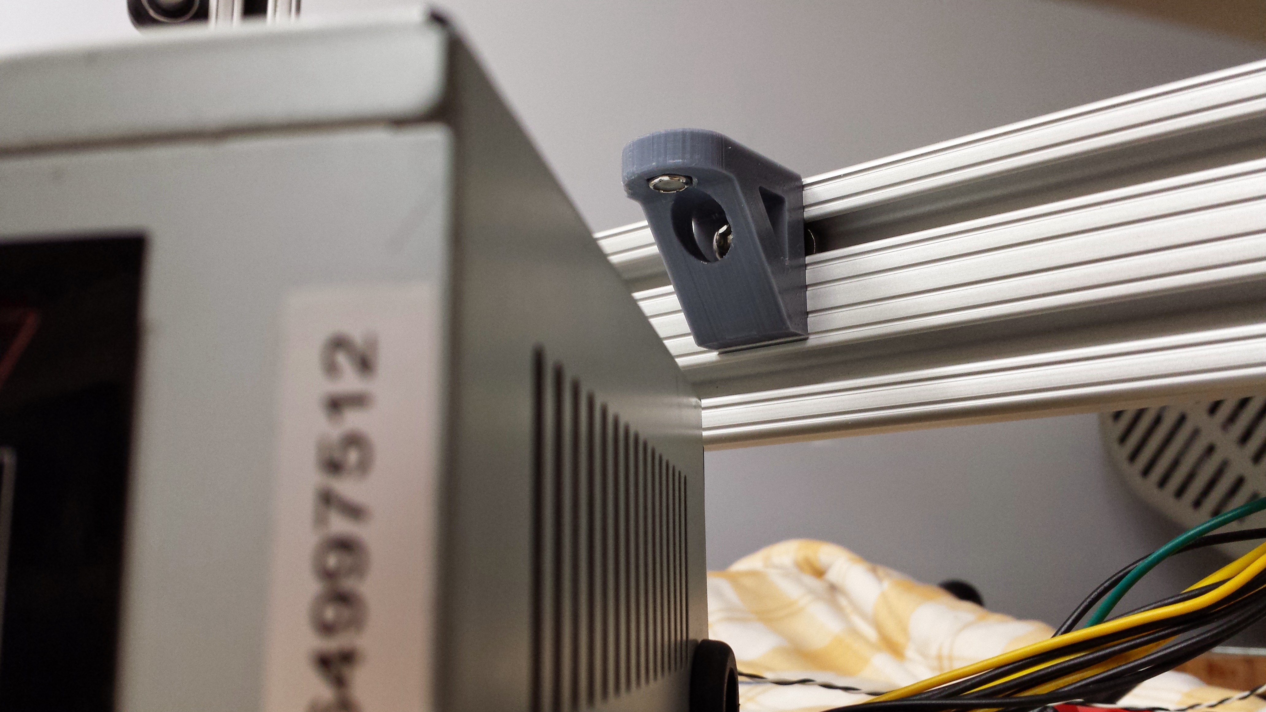

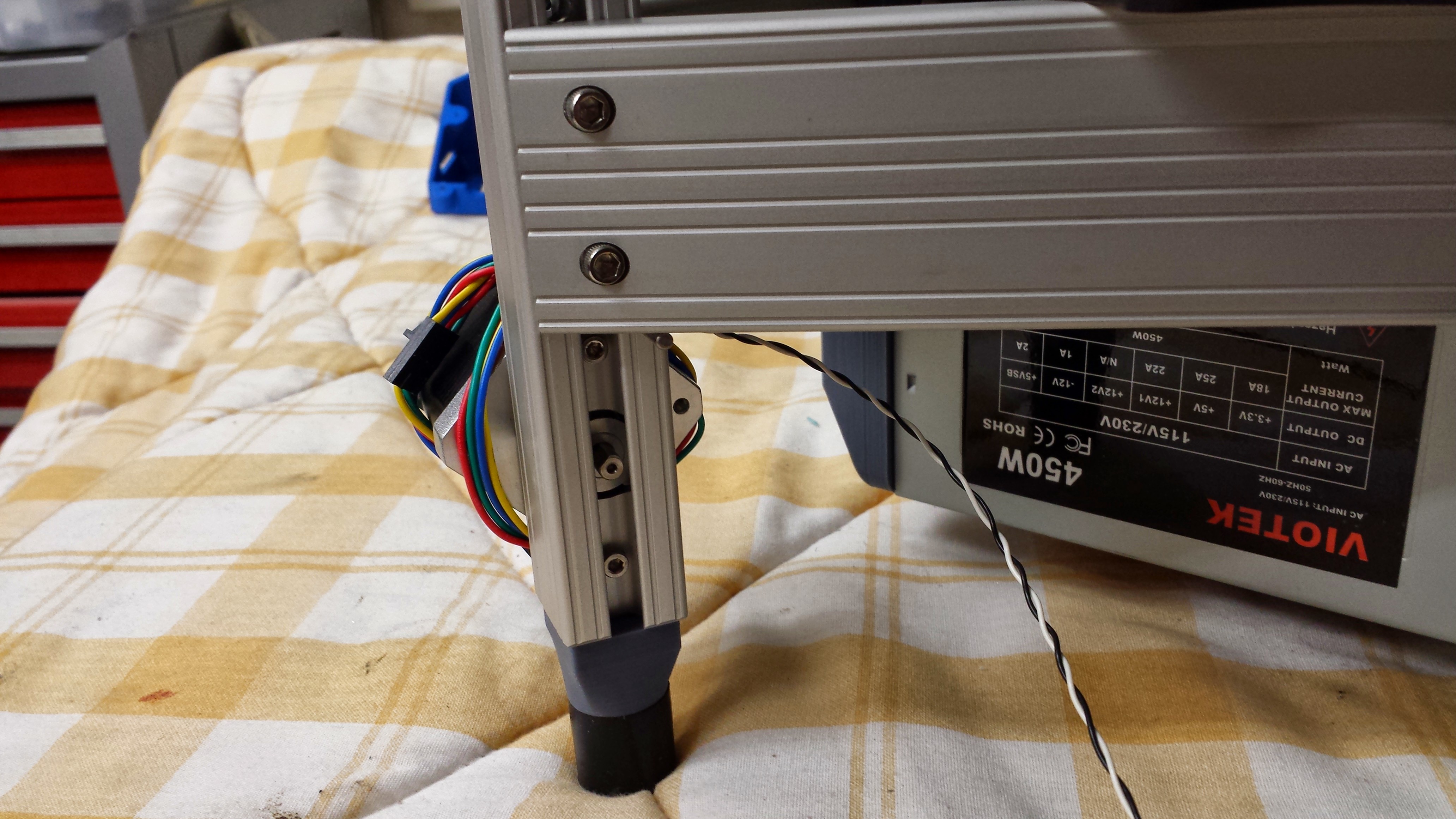

A bit more work.  The Trick Trucks are assembled to the frame along with the belt spacer to ensure parallelism of the system.  I sniped off a fair amount of old belt to get rid of the crushed ends from the v1 assembly clamps and still have quite a bit left over because this frame uses so much less.
I had to shorten the height of the belt spacer by .5 mm to bring everything into parallel.
I've decided I need more clearance to vent the power supply. I've designed up some risers and will print those and what I believe will be the final brackets for the stock v1 heated bed insulator.

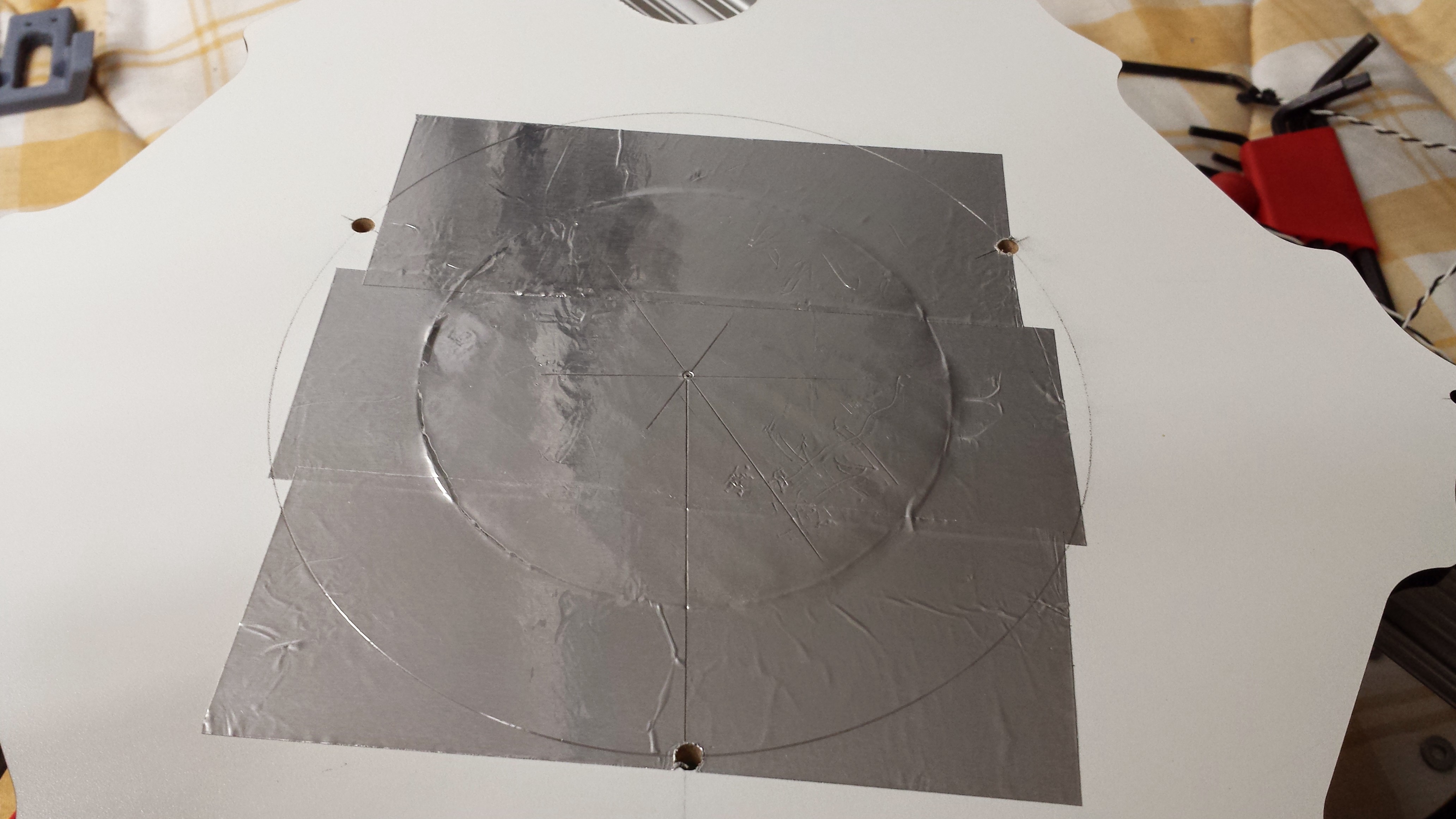

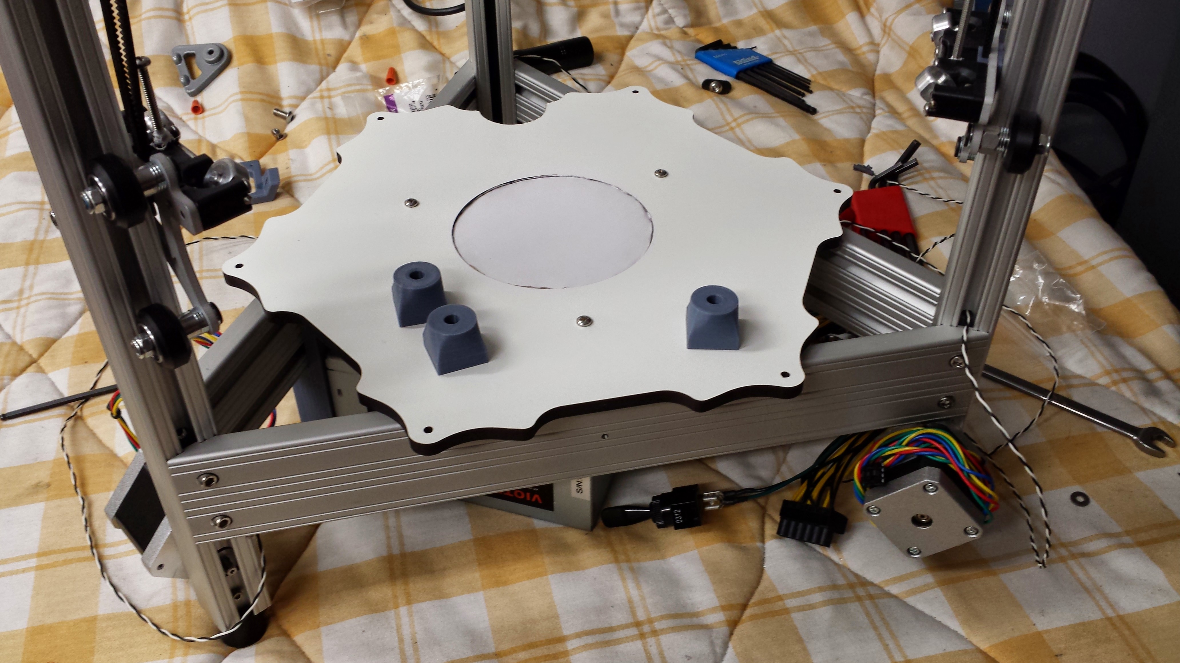

Heated bed brackets tested and completed.
The stock insulator needs to be drilled for a 6.0" dia hole pattern as shown. I had filled the hole some time ago to keep drafts off the heated bed with a couple layers of cardboard and was able to use it to stick a compass point.
1. Find center by drawing 2 lines between heated bed holes.
2. Draw a 6" dia circle with your compass.
3. Use a protractor or 30 degree triangle to construct the intersection of the circle.
4. Punch and drill close fitting holes for #6 screws.
The latest bracket on Github will look a bit different, but will print much easier. The brackets use some of the 6-32 nyloc nuts from the v1 and some 6-32 x 5/8 or 3/4 screws. And... the insulator assembled onto the brackets. Everything fit the first time! If you printed the first version, it won't work with the 6" dia. spacing. Last but not least, some risers for the feet. I wanted extra clearance to ventilate the power supply. I will be tweaking the power supply bracket so the 4th screw is accessible to easily remove the power supply if it needs to be removed. Otherwise, you will have to pull the heated bed to access the bracket from the top. Final check prints of the limit switch brackets are in process and then onto the electrical enclosure.
