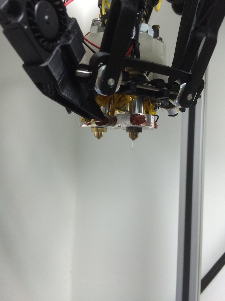

I'm newbie. I have Rostock Max V2 and I got this 3d printer full assembled.
I would like redesign to dual extruders, but I don't know how set firmware.

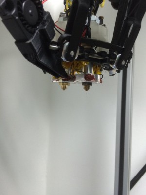

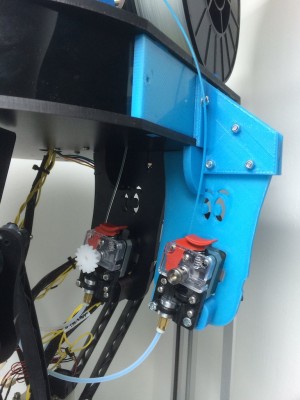

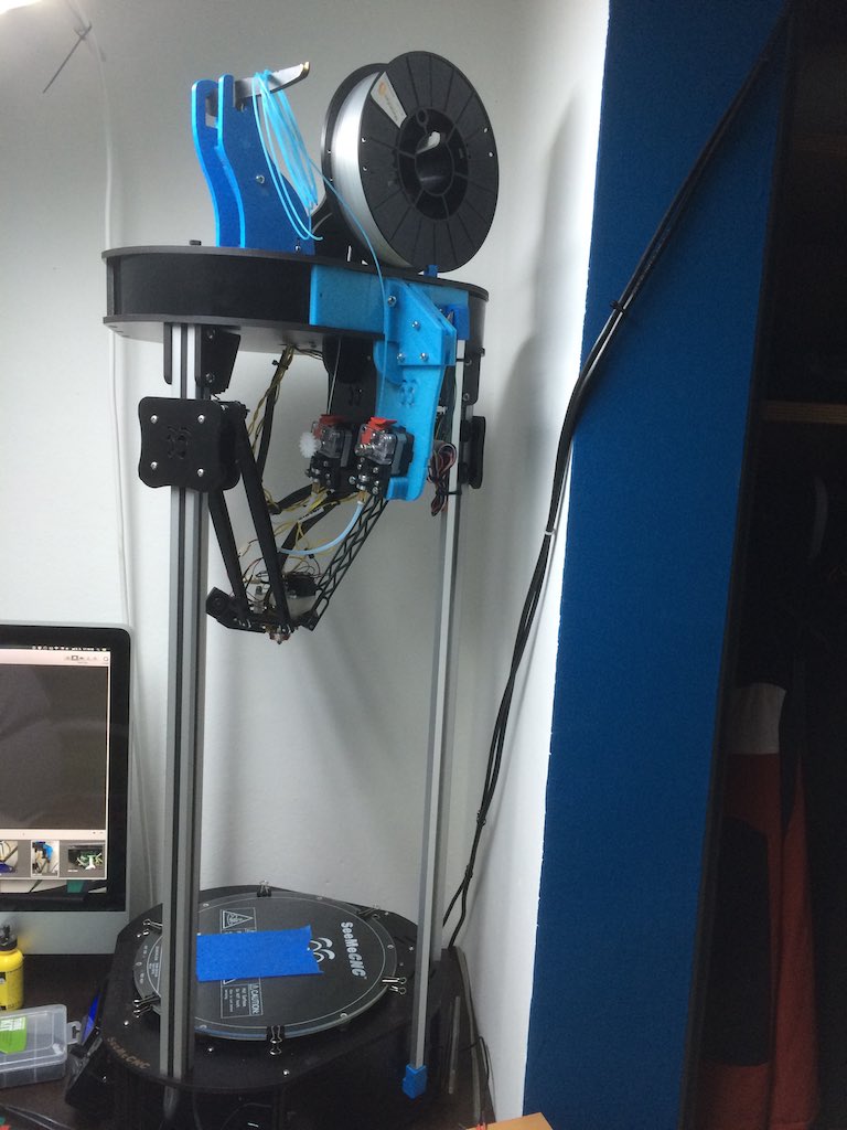

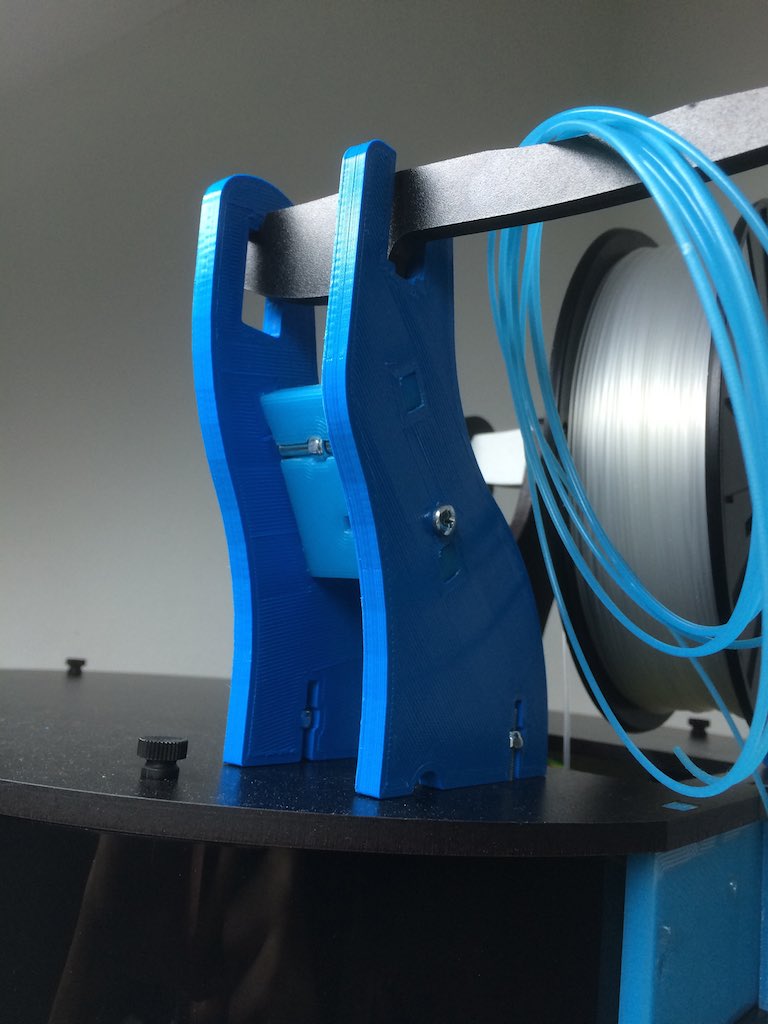

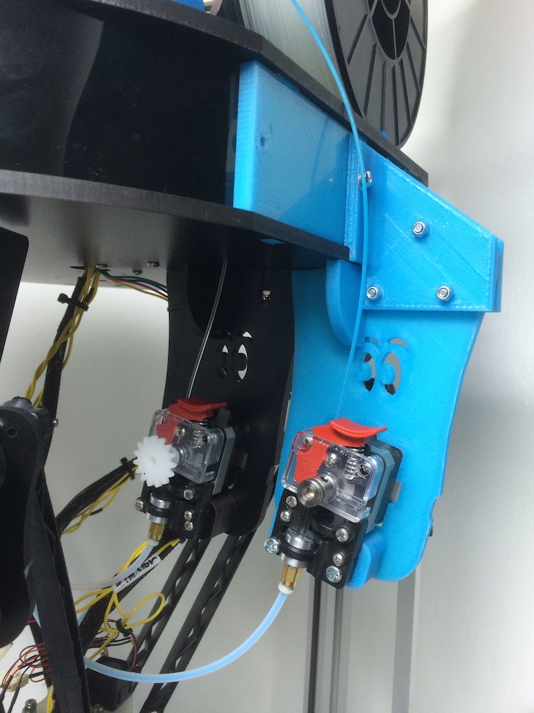

I modified my 3d printer Rostock Max V2.
I used hot end holder http://www.thingiverse.com/thing:214536 and original 3D models for rostock, which I modified.
I have to edit position for second hot end (2nd hot end is higher about 0.12mm), then I will load firmware for dual extruders.

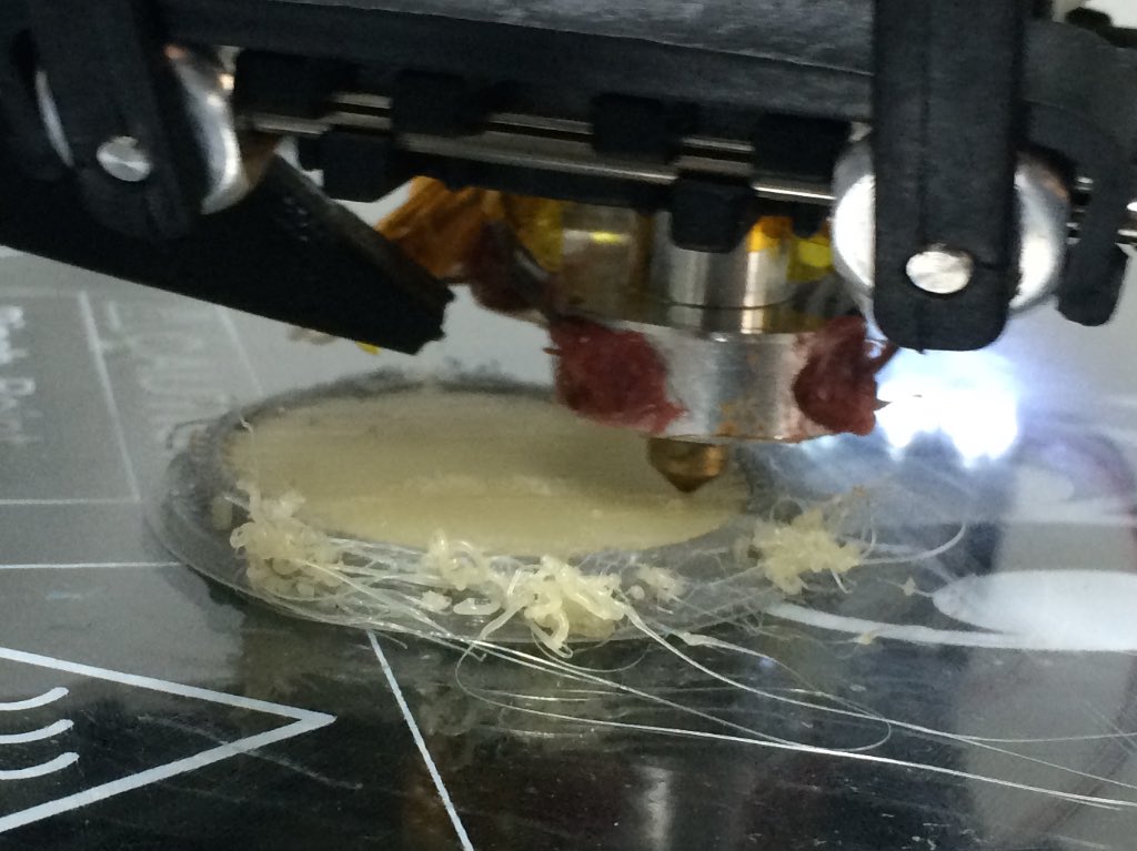

Hi all,
Thanks for link.
I'm finished with modification. All run very well, only I have problem with setting in Simplify3D with dual extruders. From second extruder flowing filament. I'm set custom gcode in tab Tool Change G-code E-8.4 F800, but second extruder with PVA filament flowing.
Edit:
I had to stop printing, result is very poor, part isn't clear.

I believe Simplify 3D is not the software you want to use for dual extrusion.

plasma wrote:I believe Simplify 3D is not the software you want to use for dual extrusion.
s3d works fine with dual extrusion.
