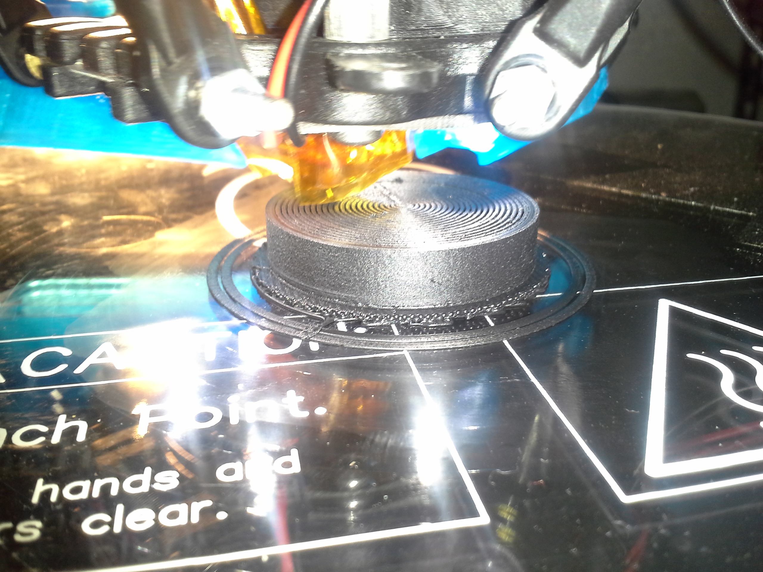

I just started the print, with S3D.
On a side note, get to try out some new black PLA with awesome temperature ranges...

Looks like mine is about the same. I can feel the banding on the flat sections more than the circle.

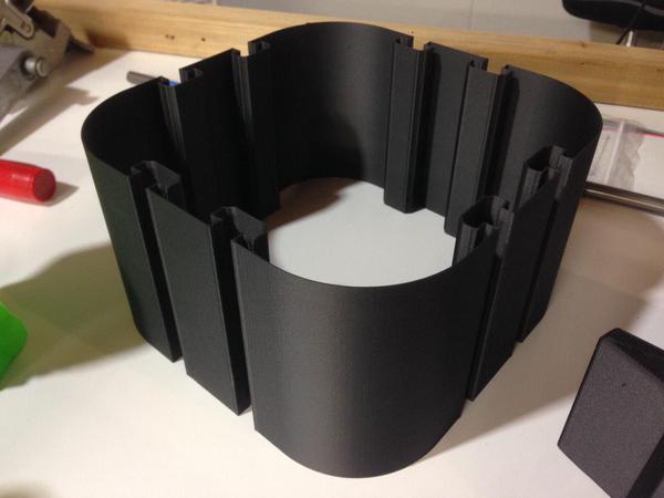

mhackney, Awesome "BandAid" model to test this problem, especially the hexagon offset with the square!
I will print this later when home from work.
Jimustanguitar, great link on how you can see the effect of how a stepper can be manipulated. More and more this seems to fit with how the controller software and motherboard handles the steppers and what the mathematical modeling/programming/output is for linear and curvilinear movement. This pattern would be exacerbated by all the parameters and variables of print settings, printer calibration, and printer speed as everyone has mentioned.
It would be interesting to print a single layer and look with a scanning election microscope, at this layer relative to the X, Y, and Z-planes as well as 30 degrees off of each axis. I bet the patten we are seeing would show up and would reflect the movement of the head which is a very fine "Z" pattern with a variable frequency pending the position on the print bed. This Z pattern would be affected by the angle of the print line relative to the X,Y and Z-axes and the precision of the print settings, printer calibration and speed.

Here are two pictures of my print. Note the line in the middle of the hexagon - happened when I close the keyboard drawer of my desk too hard! :-(
Back to the test print....... What I noticed was that looking straight at the print (as it printed - second image looking straight at the square) you can see that the top square layer has banding which is deeper and a higher frequency than looking at the front edges of the hexagon which are 45 degrees off if the square. The edges of the hexagon which are parallel to the edges of the square has the same level of irregularity as the square but as noted the frequency is less. The circle has banding but is less than the straight edges. With the circle, the frequency is even less than the hexagon.
This was printed with MatterControl using MaterControl Slicer. I am printing another one now using Cura Slicer with MatterControl since I noticed the steppers sounded different with the Cura print.

This is with the stock ezStruder and normal stepper. Running 32 microsteps on an Azteeg X3 Pro Repetier 0.93.3 firmware printed via repetier host on a mac
Interestingly, there is an obvious diagonal banding on the hex and square on all sides but none on the cylinder. I'll switch over to my geared stepper ezStruder and print another. Time is tight this weekend with Easter preparations and I head to Rochester, NY early Monday for my first day on the new job. Hopefully I can get this print done before then, otherwise it will be next Friday.

I don't have any difference in any of the flat surfaces, matter of fact it even lines up when you reflect the correct way when looking from above.
That's really the trick. The parts don't look bad in person, it's just aligning it a certain ways so the camera picks up the variations.
Ultimately, I'm trying to make it look as bad as possible.

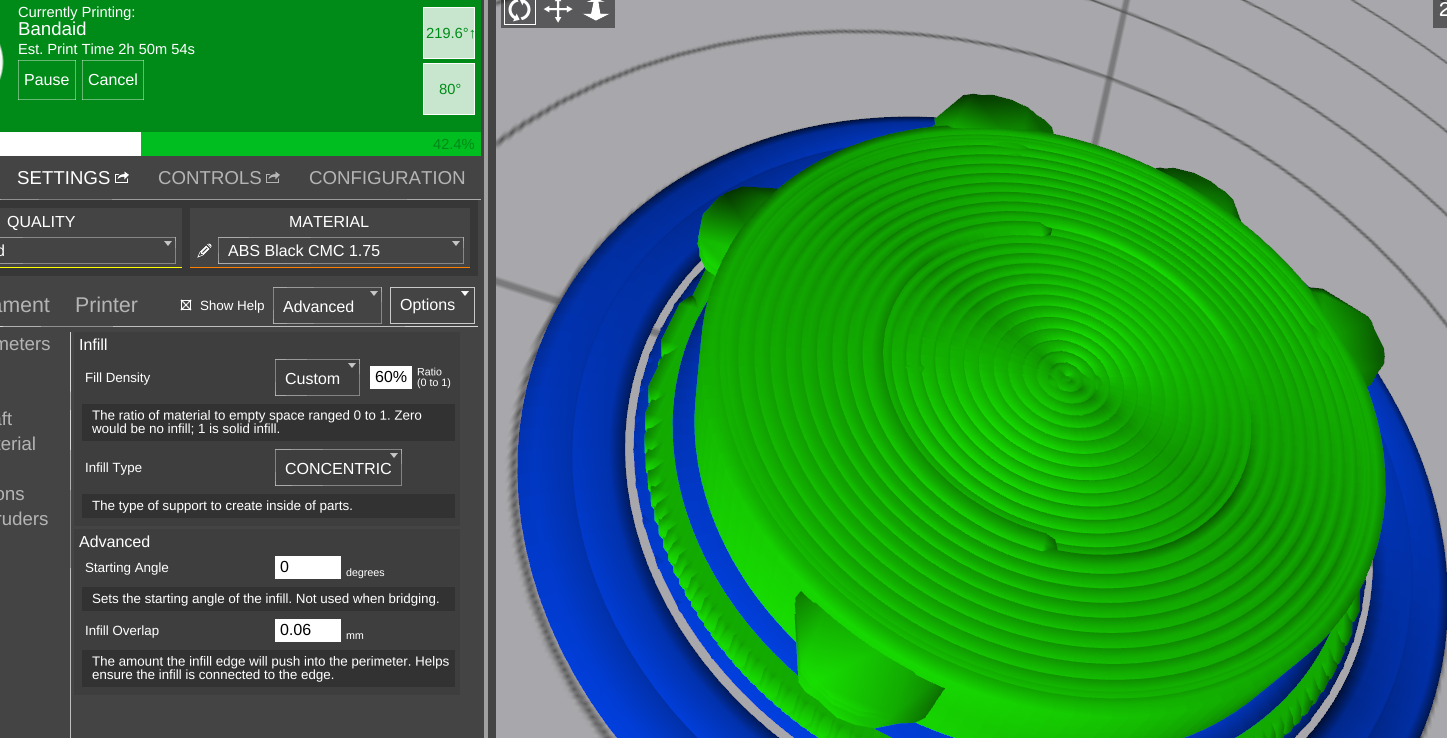

I am printing one too just for the hell of it. I am seeing pretty much 100% infill though. My settings are 60% concentric, Matterslice/control.
ABS 217 Bed 80. Speed is between 20-25mm/s and 30mm/s for infill.
This actually turned out pretty good on mine. You can see some of the banding on the middle but not much on the other sections. I tried to get it to show in the light reflect but this was a bad as it got. I am still in the 'print it slow' stage. Yes slow does work... Its just well, slow. 2hrs 50mins to print.
This is actually one of the best prints I have done on my printer.

drunkenmugsy wrote:I am printing one too just for the hell of it. I am seeing pretty much 100% infill though. My settings are 60% concentric, Matterslice/control.
I had better luck in MatterControl using Decimal values over percentage. .60 versus 60%
Edit, sorry was at work and couldn't see the image. That's weird how MC shows it solid but it's printing with gaps.
