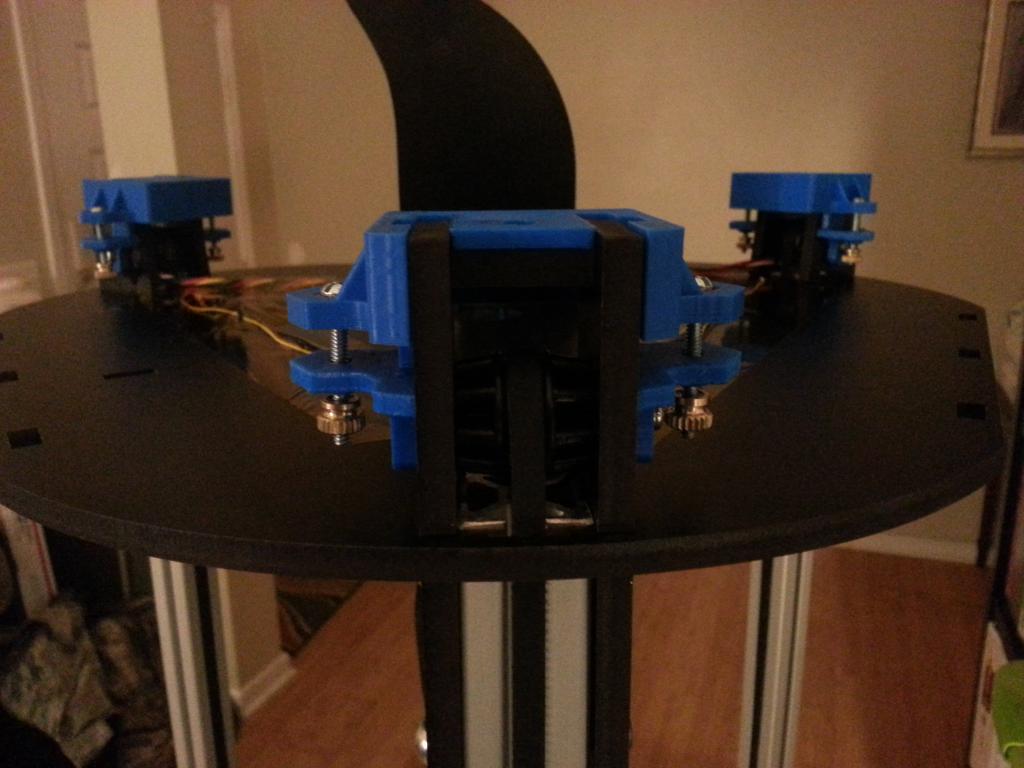

Well, once you get your printer working properly, you should print a set of these to help with future belt tensioning...

[img]http://sosandtrappers.com/upload/tensioners.jpb[/img]

I saw that picture and was like, cool I did that too. wait a minute... that's my house!

It was that picture that caused me to print a set for myself, so thanks for letting me into you home

I'm actually working out my own version of those that have captures for #6 locknuts.
I somehow ended up with a lot of those after sending my wife to home depot to pick up some fasteners for the Orion's overhaul.
I don't know how well this system will work, but I'm including graduations on both sides to have a crude but maybe effective way to balance the tension.

I've noticed that even with the tensioner like above, it's still the screw/nut going through the support and pulley that holds everything firm. It does make it a tad easier to level the top pulley so the belt tracks in the middle of the bearing.
If you don't mind, post up your design when you get it done.
