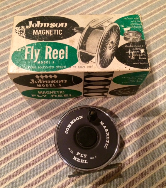

Just came across an interesting idea on Thingiverse, a reel incorporating magnets as a drag system .... http://www.thingiverse.com/thing:759561
Re: 3D Printed Fly Fishing Reel
Yeah, there was a company that manufactured a magnetic drag fly reel back in the 1950s and early 60s - Johnson Magnetic Fly Reels. I own this excellent example in its original box:
It is a simple check and is silent. Tis reel worked nicely but the magnetic is at the center in line with the spindle. The reel on thingiverse has 3 magnets 120° apart. This would give a pulsating feel when retrieving and when a fish runs with the fly.
