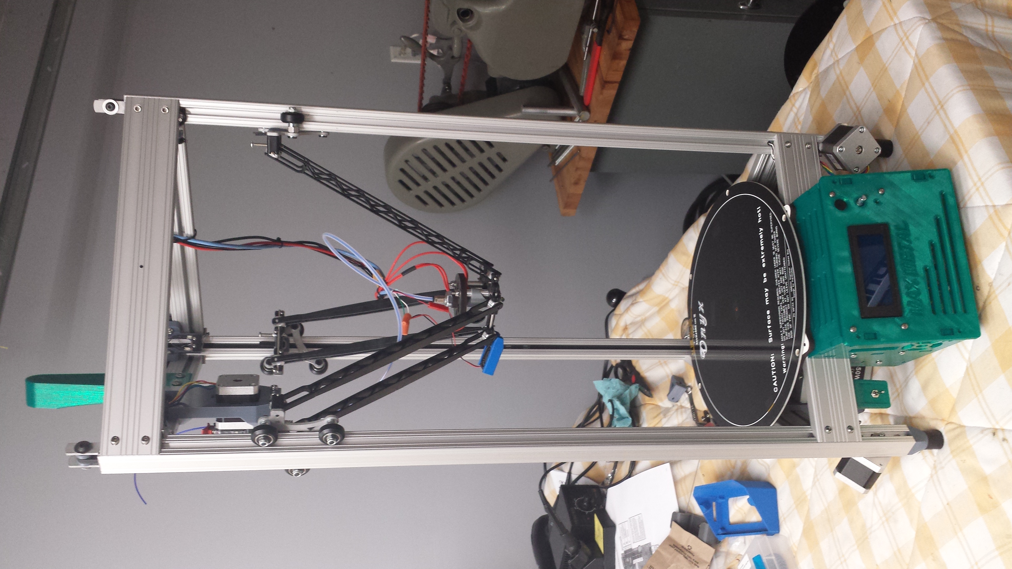

Significant progress this weekend.

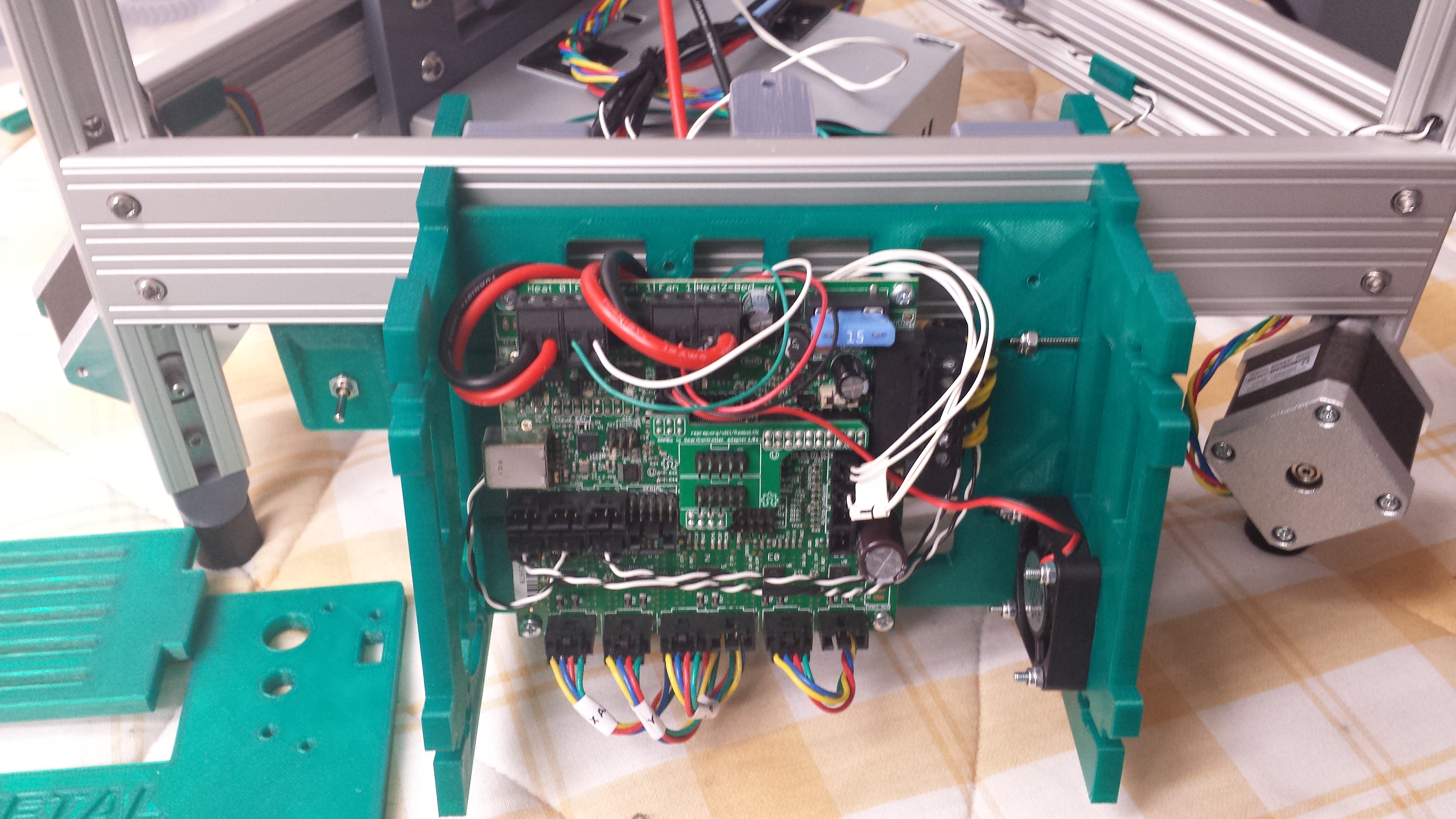

The electronics housing as designed needs some tweaks. I need to deepen the housing about a 1/4" to clear the LCD controller.
When assembling, reclaim the 4-40 t-nuts from the v1 skates or the plate the heated bed threads into and install those into the underside of the snowflake. You can then use 1/2" 4-40 screws to secure the heated bed.
This is such an impressive project. I had been thinking about designing my own delta, but one of the things that held me back was that I wasn't sure how to make the alignment perfect. I think plenty of people who don't even have a Max will end up buying this frame and using it to build their own custom deltas.
I believe the alignment pins are an example of kinematic couplings. Am I right about that?

Yes! It took only a couple of raps with the palm to seat the horizontals to the pins and the assembly squared itself. It was almost too easy!626Pilot wrote:This is such an impressive project. I had been thinking about designing my own delta, but one of the things that held me back was that I wasn't sure how to make the alignment perfect. I think plenty of people who don't even have a Max will end up buying this frame and using it to build their own custom deltas.

Hit a "little" snag.  Everything was moving, homing, heating, etc.   Went to flash the Rambo to the latest firmware and now, no movement from any of the steppers.  I can still see the switches, heat, layer fan control etc, but the steppers simply refuse to move.  I reverted back to the prior firmware without any luck and tried the SeeMeCNC release and same issues.  I've tried the eeprom clear tricks, checked fuses, etc.
I lost the the output for the peek fan awhile ago, so was just going to wire it to the 12 VDC side and move along. Maybe an indicator of walking wounded? This is a 1.2 board, so I'm thinking it finally gave up to ESD when I plugged it into the laptop to reprogram.
I've got an old Rambo 1.1 board with 1/8 microstepping. I'm going to put that in when I install the new housing pieces to see if that gets me up an running. I'm curious to know if anyone was using a 1.1 board and made a switch to 1/16 microstepping and noticed any print improvements. I may limp on the 1.1 board for awhile until calibration and test prints are complete and then order a smoothie board. The Azteeg X5 looks really nice for the money, but I'm concerned about the drivers and durability based on what I've been reading.
The SmoothieBoard is cheaper than the Rambo, so one way or another, I won't be purchasing another Rambo

I have the Rambo issue sorted out.
I installed my old Rambo 1.0 board, uploaded the stock SeeMeCNC firmware with micro stepping changed to 8 and.... no movement
Slept on it, and decided to install Arduino with a fresh copy of the firmware on a Win 8 machine. After jumping through hoops to get the driver installed, compiled, uploaded and success!! She's homing again. I will say there is a audible difference between 1/8 and 1/16 micro stepping.
So, me thinks my 1.2 board is just fine and between using Dropbox for my firmware and bouncing between a couple of machines and Arduino 1.05 on one box and 1.63 on another too quickly, I ended up with some stale compiled files somewhere that the IDE did not catch.

A quick, but significant update.
I spent Saturday morning installing a "new goodie" and began calibrating and printing.
The "new goodie" was a set of Trick Laser carbon fiber arms Brian graciously donated for the build. My stock arms had some wear that I think rubber straps would have addressed, but his arms were the ticket. The platform is now nice and tight and it helped ensure accuracy of the build. He also included v2 of his lash straps that made assembly easy.
I'm still currently setup with the old Rambo 1.0 and 1/8 microstepping. It's a bit noisy and it will be quieter once I get back to 1/16 stepping. I am using Repetier 0.92.3
Printing consisted of a simple cube to get my extruder e-steps dialed in and then a right angle calibration piece I found some time ago. After printing, I knocked down some corners for accurate measurement and I was very pleased with the results.
The long lengths are within .04mm and the widths are all within .02mm.
The 90 degree angle is darn near perfect. There is a barley detectable gap at the end.
This was achieved by careful calibration per the Geneb's process using a piece of paper has a height gauge.
Also, I am still using the SeeMeCNC stock hotend that has quite a few hours on it, and some very irregular PLA that is egg shaped by 1.72 / 1.79mm.
I'm in the process of printing an adapter for the Prometheus I purchased from Brian. I'm going to do a separate write up on the v1 Prometheus and lessons learned as I setup the v2 for this machine.
Also, a Smoothieboard has shipped. I went with a 5X and will be using an old Arduino to adapt to the existing ReprapDiscount LCD.
For those who are sticking with their Rambo, check out the 0.92 dev tree. It includes some new error mapping options that might allow you to adjust out the parallelism errors if you are calibrated flat to the table and are still having accuracy issues.
All-in-all, I'm extremely pleased with the combination of the Trick Laser parts and the accuracy of the build provided.

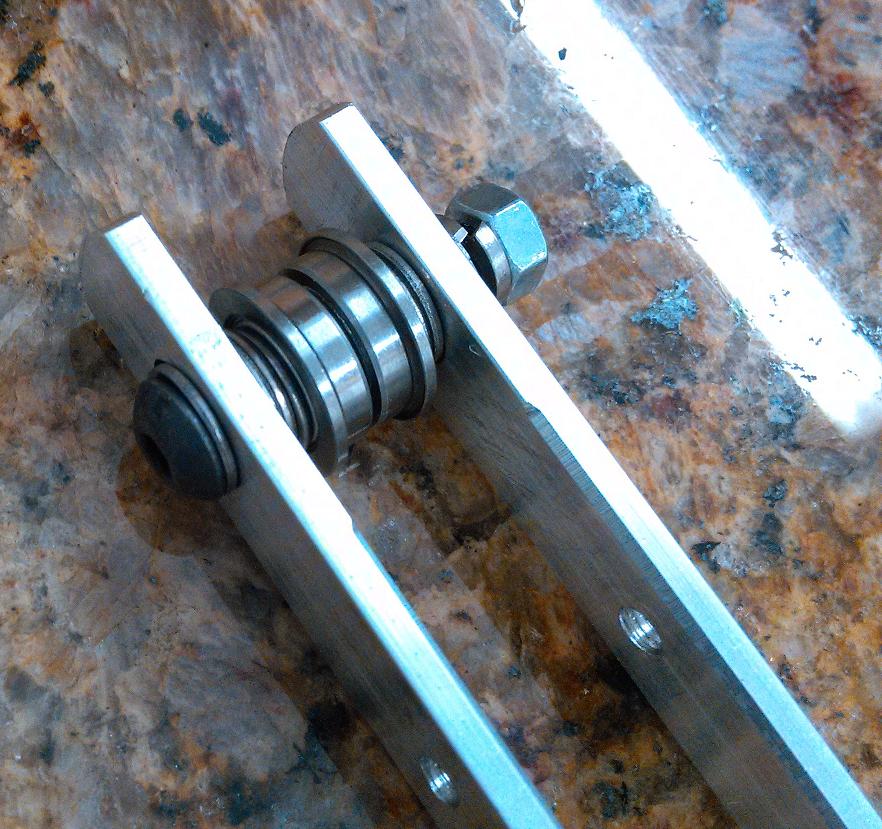

I sourced smaller diameter idlers that are closer to size of the GT2-20 motor pulleys. They finally arrived Saturday.
They are a pair of flange bearings. They work great!
The first 2 frames used larger idlers from Openbuilds, they really where bigger than ideal.
Another bonus is you can adjust the width by adding or removing washer between the two halves. Some belts are a full 1/4" wide (6.35 mm) others I have used are only 5.5 mm wide.
All the frames are shipping with this improved idler size.

Very nice on the idler change Brian!  I like the idea of being able to adjust for the width.
Having trapped the belt width, it makes for rub free operation. When I assembled the stepper motors, it was a simple exercise of measuring the pulleys, doing some match and presetting the pulley position of the bottom of the hub to center them in the frame.
My belts were the full 1/4" wide. Has SeeMeCNC changed, or are the 5.5mm just from a different source?

My old Rostock MAX belts are full 1/4" wide. The Orion I have is 5.8 mm, belt I got from Openbuilds (I think) is 5.5 mm, some cheaper stuff from some ebay seller is only 5 mm wide. I do not know how wide current belt from SeeMe is.ccavanaugh wrote:Very nice on the idler change Brian! I like the idea of being able to adjust for the width.
Just depends on where you get it I guess. Must be why some is cheaper than others.
I do not like the narrower stuff.
Actually I would like to find wider for my NEMESIS printer, like 8 - 10 mm would be nice. Don't know of source, but I have not looked really hard.
Why not offset the top pulley so the belt is parallel on the side that clamps onto the carriage? That will give you your parallel belt on the side that needs it, the other side won't matter, could be doing S curves the whole way up.
