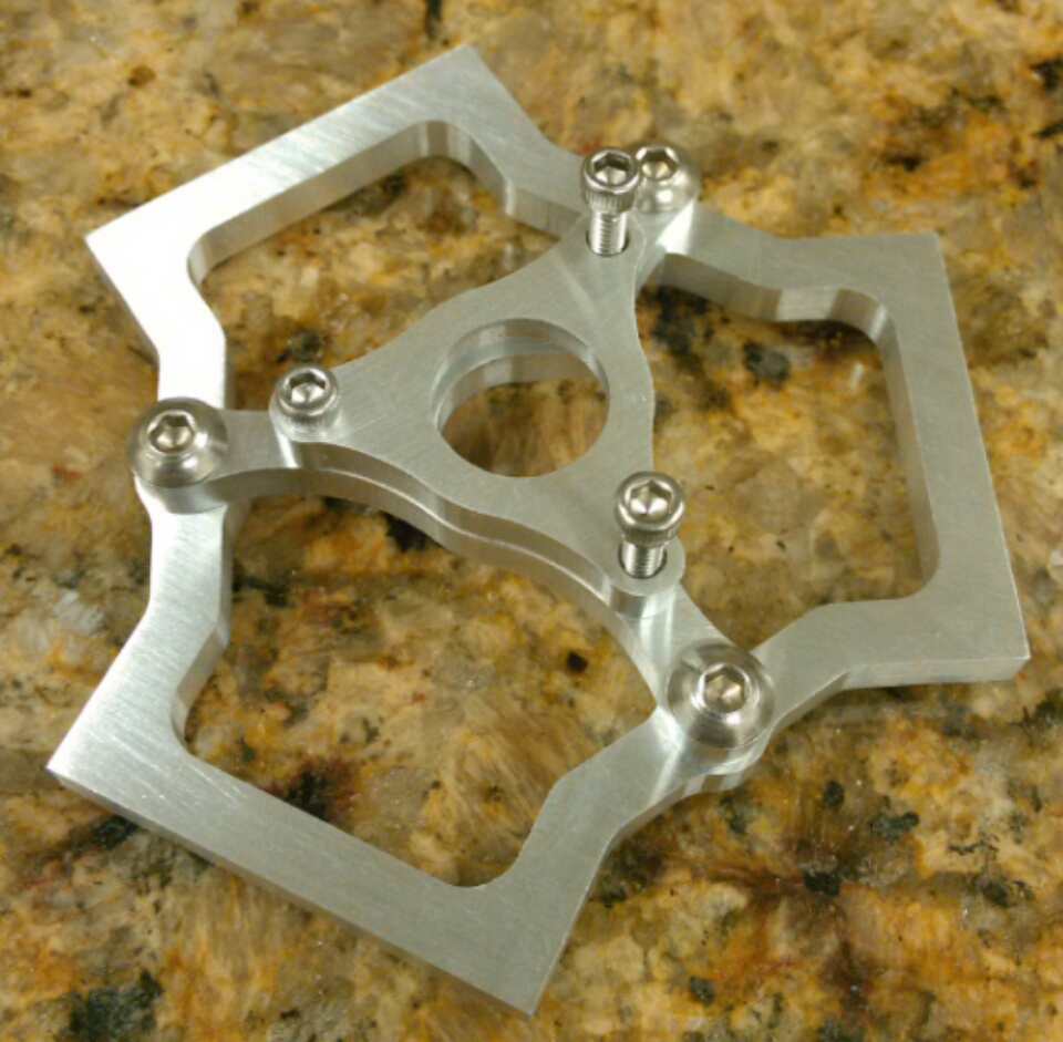

- bvandiepenbos
- Posts: 923
- Location: Goshen, IN
Here is a little peek at something else I have been working on.
I laser cut the design mockup from wood over a year ago... just could not stand it any longer, had to make some aluminum chips this weekend just for fun. Now to find the time to test it out on my MAX.
