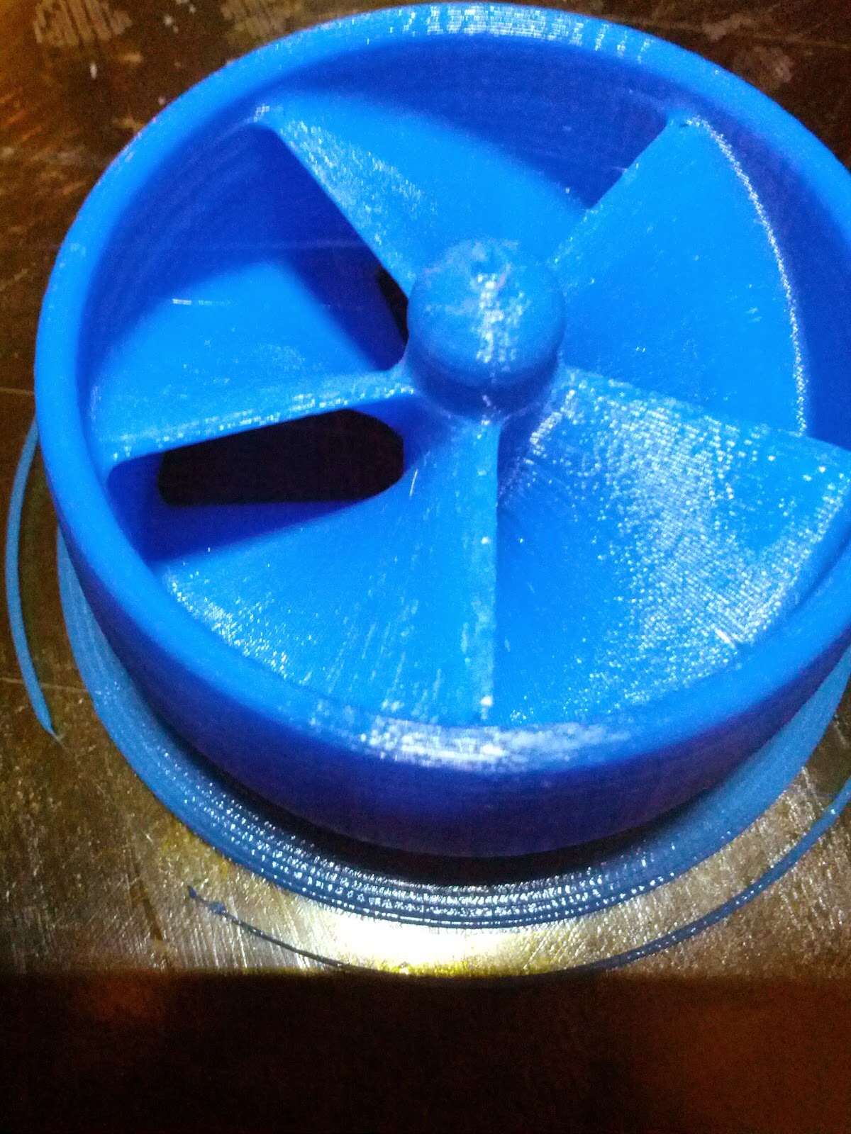

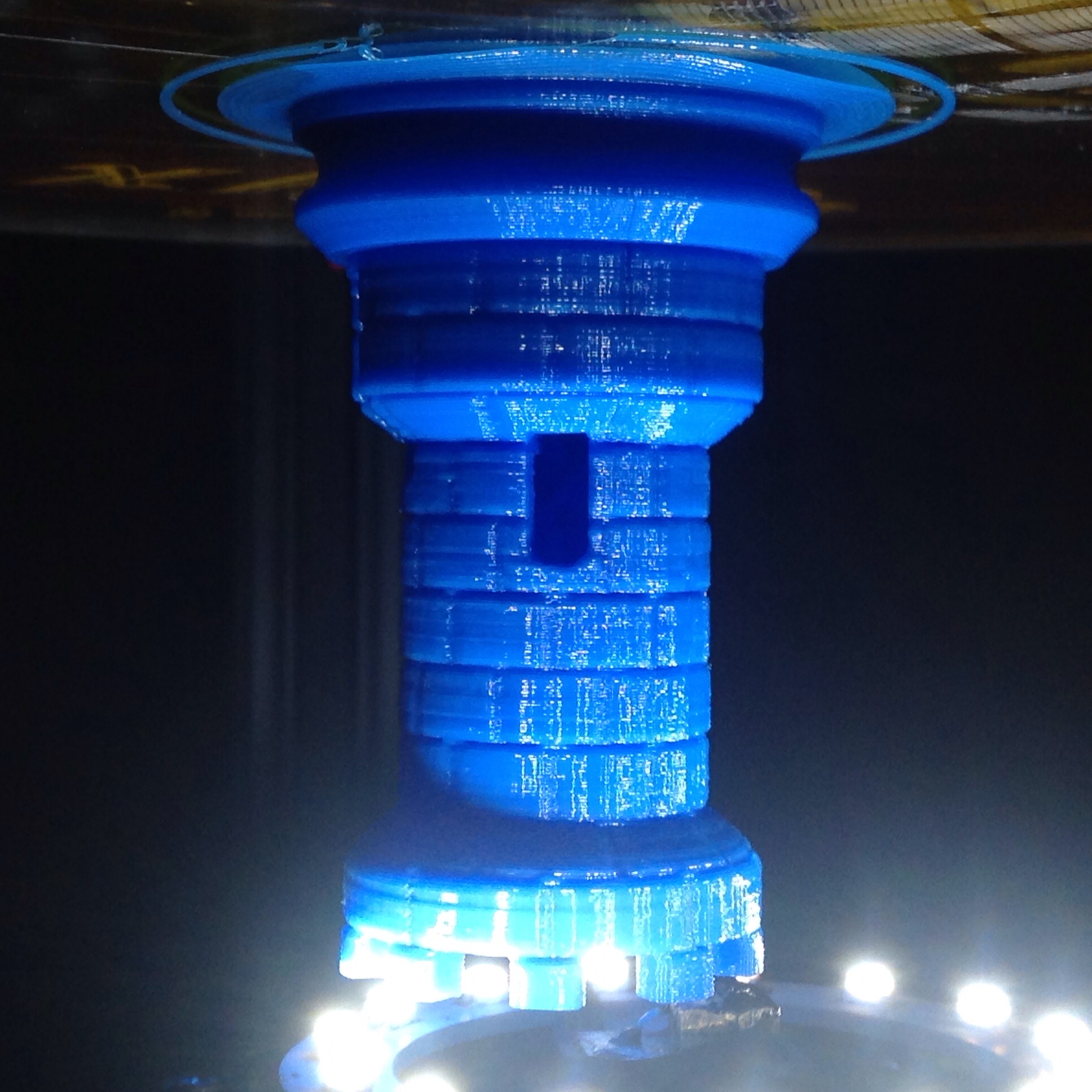

Damn those are some good looking prints, would you mind divulging your settings and nozzle and such?

I'm at work today but I promise settings and pictures of my dry box setup tomorrow.DavidF wrote:Damn those are some good looking prints, would you mind divulging your settings and nozzle and such?

Also, what are you printing on? Looks like a sheet of PEI based on the yellowish tinge, but wasn't sure.MrPTrog wrote:I'm at work today but I promise settings and pictures of my dry box setup tomorrow.DavidF wrote:Damn those are some good looking prints, would you mind divulging your settings and nozzle and such?

Probably a sheet of Garolite. Nylon sticks nicely to it.

TRIMMER NYLONDavidF wrote:Damn those are some good looking prints, would you mind divulging your settings and nozzle and such?
260C Extruder
80C Bed (I am currently using 75C for the bed per Cope413 settings.)
gluestick (UHU because I had some.)
E3D Hot end
.4 mm nozzle
.2 - .4 mm layers (rook was .2 wheels were done at .2 .3 and .4)
6mm retract eliminates just about all of the spiderwebbing. COPE413 uses 12mm if I remember right. He uses a larger nozzle so that makes sense.)
If you need anything out of my slic3r settings, let me know.
Let them hydrate. Nylon gets tougher after it absorbs water. One of our injection molding techs told me several stories about his experiences. At one of his former jobs they would "simmer" parts at 90C for an hour. Living in Florida I just leave them on the back porch if strength is a concern.
