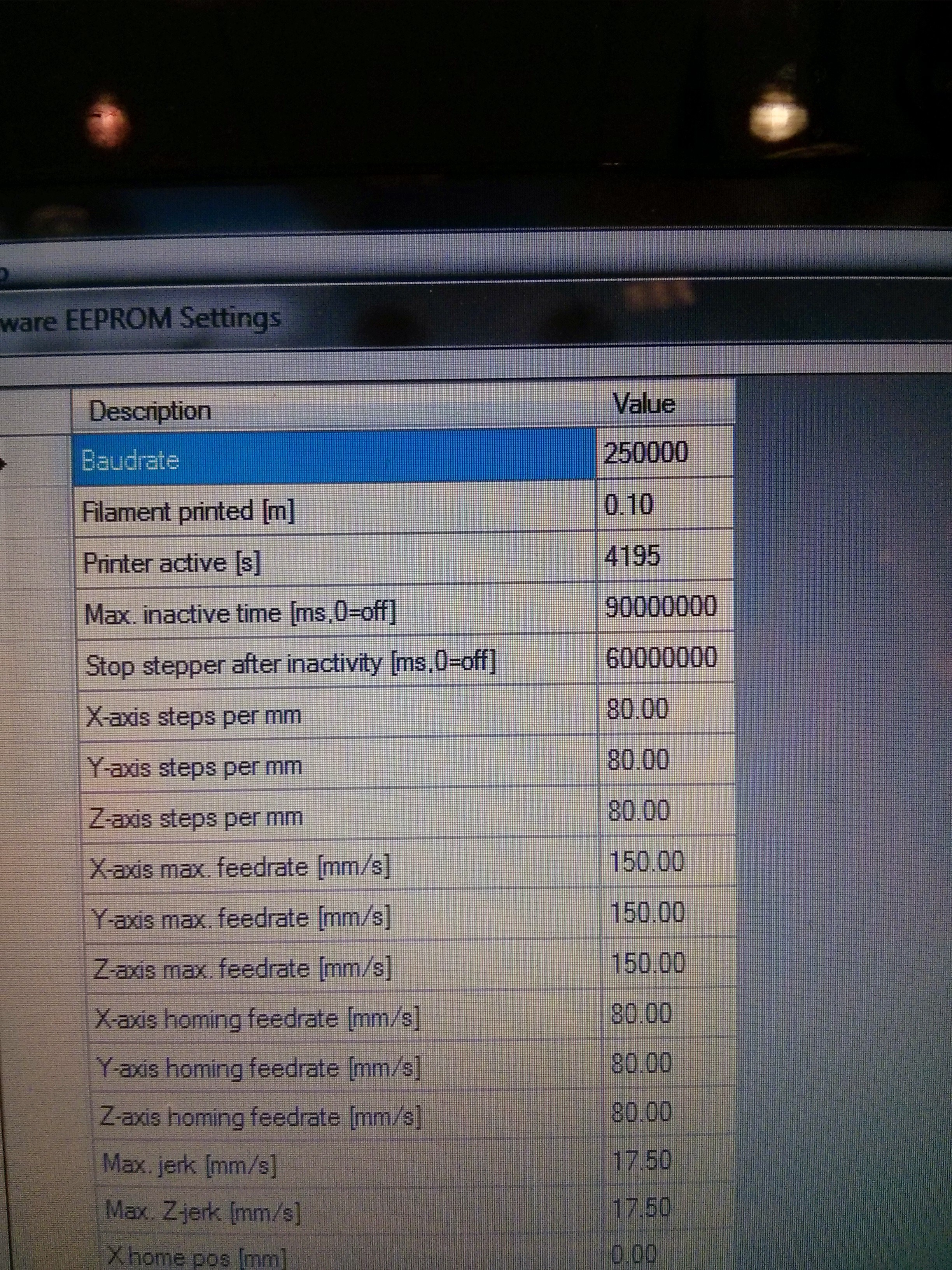

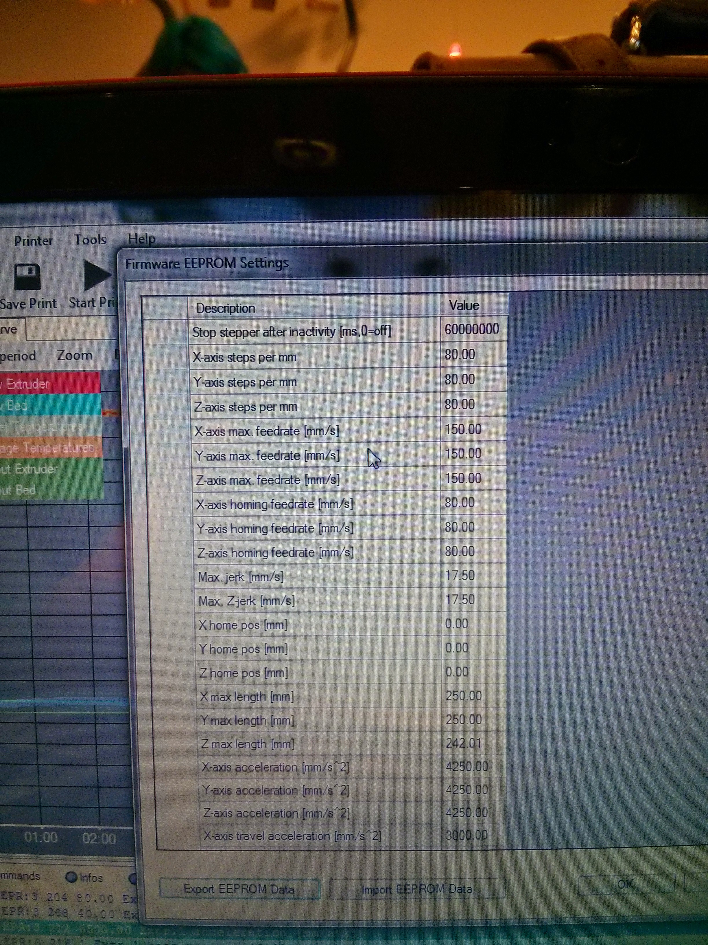

When calibrating the Orion there is no option showing for horizontal radius. We've gotten the towers in the right position but when testing the center the nozzle is significantly above the build plate. When opening the EEPROM settings there isn't a section for the horizontal radius to adjust. I took pictures with the cell phone to try and show what I'm talking about. This Orion isn't ours we're helping a museum fix it so the best I could do was quick snap shots with the phone camera.
Is there something we may be overlooking? Do you have any suggestions what else to try. Thanks so much!

What version of firmware do you have?
Max v2

That is a great question. I'm not sure what version the firmware is. I'll have to check next time we are there. I took a look at Seemecnc's github repository and only saw a "firmware old 83" file. Where could I locate the Orion's newest firmware?

drwho wrote:That is a great question. I'm not sure what version the firmware is. I'll have to check next time we are there. I took a look at Seemecnc's github repository and only saw a "firmware old 83" file. Where could I locate the Orion's newest firmware?
Hi, here:
https://github.com/seemecnc/Repetier-091-ORION

Awesome I think that is actually exactly what I needed thank you so much Tincho
