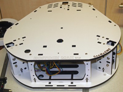

After weeks of research and now some spare time available I started my build.

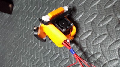

I'm incorporating a E3D V6 from the outset along with some other small mods - also building stock head as a spare. Didn't currently have a printer so got a proper mount for the E3Dfrom sculpteo with some custom aluminium rods courtesy of my Bro's Lathe.

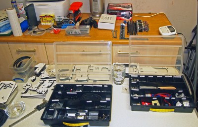

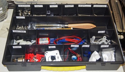

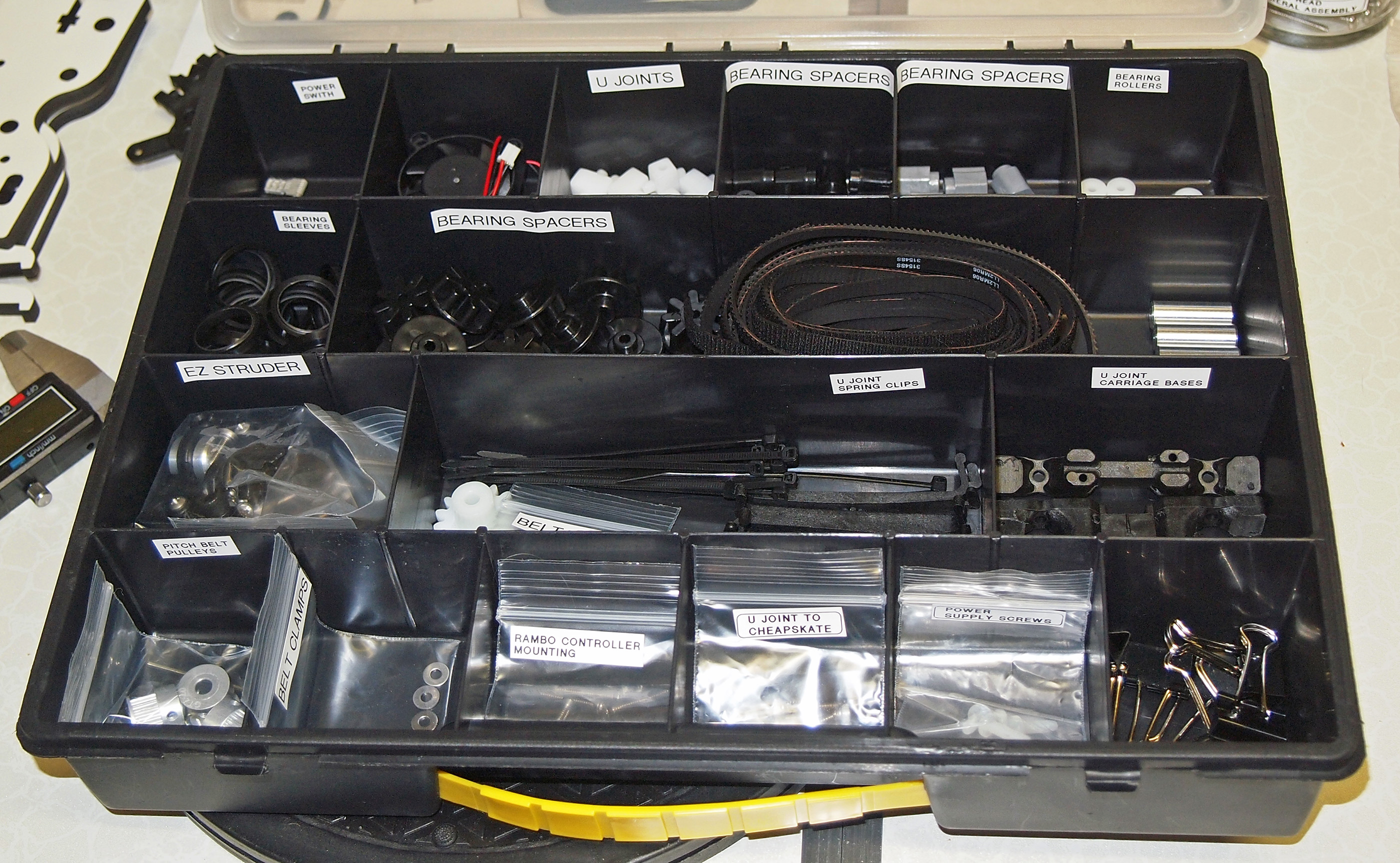

preparation: I opted to label everything - it certainly made the job easier for me and I'd recommend it to other new builders

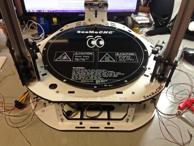

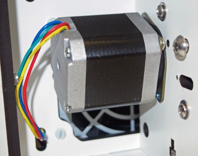

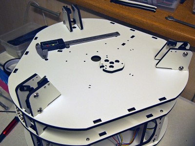

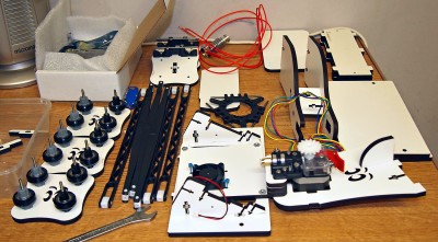

After 5 hours on day one of the build I go to this stage: As I was fitting the nema astroysyn dampers from the outset there were no screws needed for the fitment in the kit - However I have kept all my PC bits and pieces from builds over the years and I can inform you that hard drive enclosure screws are perfect for the job of fitting the dampers to the motors
Day Two: Another 3-4 hours:

solder station turned up which allowed me to crack on this weekend - I managed to get the major assembly done on Saturday along with a little tool I acquired to make my life easier - try as I might I never got rid of the 0.1 degree!
then Sunday I managed to get all the wiring and the Rambo and LCD panel fitted:

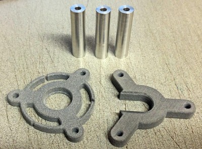

I got these made up for the E3D alumide parts from sculpteo and the spacers from my brothers lathe:

Looking very nice. Is this the E3D V6 mount you used? Im thinking about getting one but just looking into mounting options now.

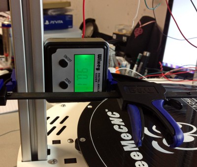

I used this level with my bed and also couldnt get closer than .1 degrees off. Maybe if i had a second set of hands to hold it and tighten it, but so far it dosent seem to effect it.

This is the one I got and used -AlphaLima wrote:Looking very nice. Is this the E3D V6 mount you used? Im thinking about getting one but just looking into mounting options now.
http://repables.com/r/296/
Yeah I'm not going to worry about a tenth of a degree - in engineering terms that's well within tolerance and is, as we say; only a gnat's spherical genital out!AlphaLima wrote:I used this level with my bed and also couldnt get closer than .1 degrees off. Maybe if i had a second set of hands to hold it and tighten it, but so far it dosent seem to effect it.

if your thinking of using an e2d try this form there are several modified mount you might like
http://forum.seemecnc.com/viewtopic.php?f=77&t=6081
this is the one im using, it works get even with pla

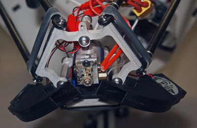

Wow - lots has happened since I last had chance to post here:
It was apparent to me after a while that although Some mods weren't strictly necessary - I definitely wanted to address some issues personally that I had.
So I ordered Trick trucks - max metal platform and the carbon fibre arms. These took about 3 weeks to turn up and I had to pay even more for customs and so I fit them to the printer..
They weren't difficult to fit at all and I added the 4mm extra radius setting that the makers suggest and set about recalibrating the printer from scratch.
The ultimate result is that I am so impressed and happy with these upgrades that I immediately ordered spares of the only parts that could be broken and that was the Carbon fibre arms.
Everything got so tight and accurate I had to work through my S3D settings again as perimeters and the like were now not touching during prints when they were fine just before the upgrades - just now got it dialled back in again nicely..I never realised there was so much 'invisible' slop in the standard setup - highly recommended upgrades these..
Were these upgrades worth the money - definitely!

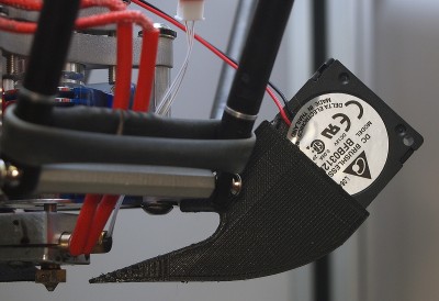

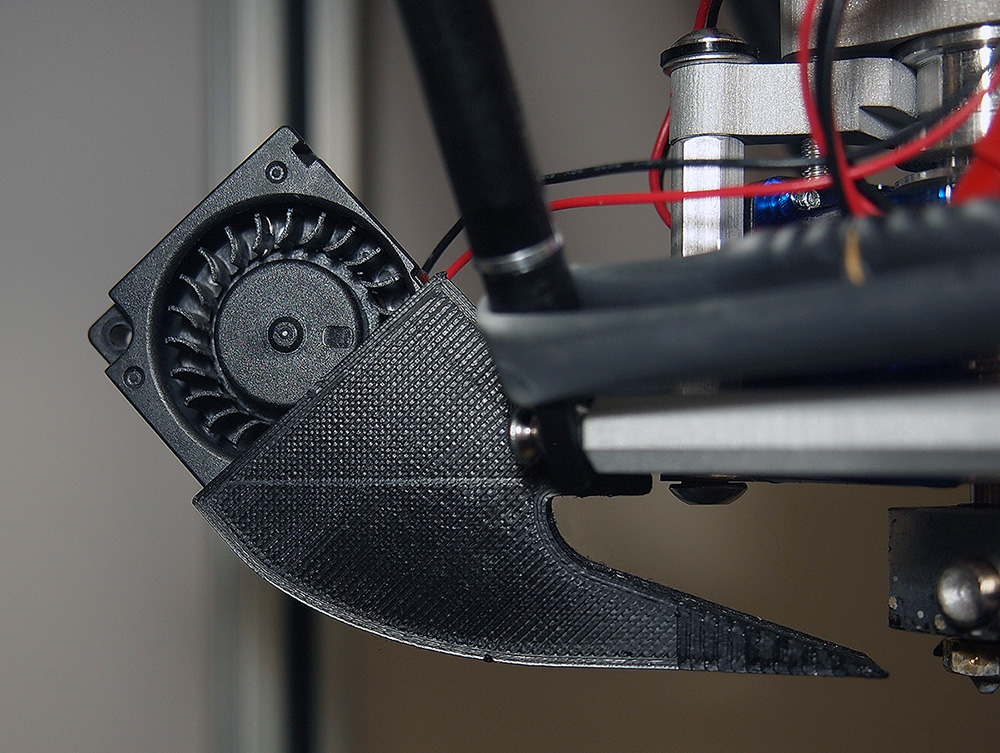

Another issue I was encountering was curling and slight lifting on PLA prints due to uneven cooling from the single layer fan that I had at the time.
I waited until I fitted the new kit and then designed and printed two layer fan holders with slight modifications to fit the E3DV6 head and max metal platform properly and to direct the air flow to just at the tip of the nozzle and to see if I could get good cooling coverage from just two fans by having a distorted mouth on the holders. I now get to use various levels of fan cooling through the slicer for specific layers and types of prints. much more flexible.
Works superbly! I have not yet noted the need for an additional front fan. these two perform great.
Members who may have seen my other posts may note that i had a lot of problems with the heat setting due to a dodgy thermistor supplied with the E3D - I got hold of a M3 studded therm' and fitted it using the recommened therm' table and now it works superbly - verified by a thermocouple for more accuracy and I can now print PLA from 185 through to 206 C depending on brand and type with no hassles.
With these upgrades and a bit of experimentation oozing and stringing have been practically eliminated except where it's totally unavoidable...

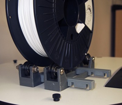

Another thing I noticed was that the Extruder trying to overcome the mass and friction of the Spool holder assembly was sometimes giving me lots of problems periodically.... jams - chewing up filament etc....
To eliminate this altogether I downloaded and modified and existing STL from Thingi' and set it up with V Bearings and now it's totally sweet and feeds beautifully and trouble free through even the longest prints.
I have a problem with the extruder motor causing issues if it's not cooled - at the moment I have a small desk fan pointed in the direction of the motor from a shelf and it works great - I will fit a permanent solution soon to it with a heat sink and printed fan holder on the motor - and possibly may leave it until after I upgrade to a geared stepper - not sure yet.
