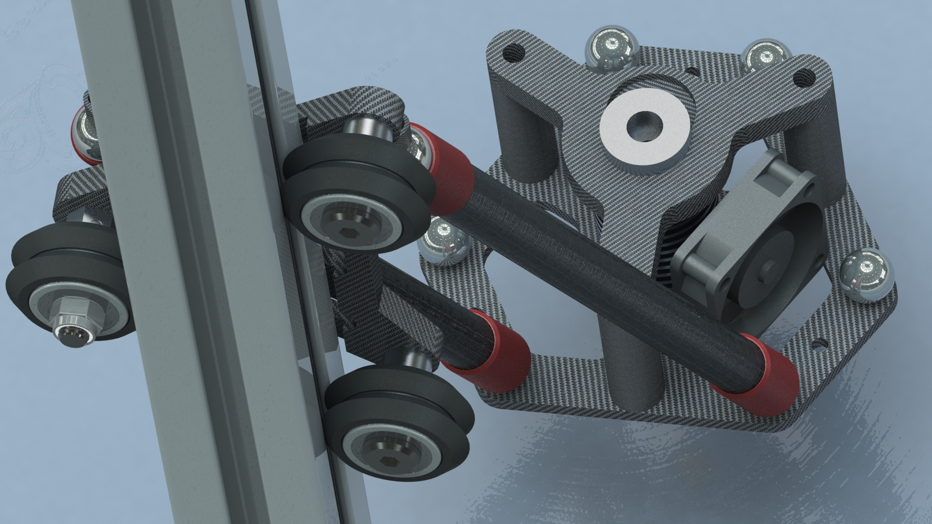

My Max Metal frame arrived in Germany. Looks fantastic. Thank you very much Brian!! Really nice work.
As far as I´m home again I will start to build it step by step.
First I designed my Trucks. Planned to be made of Carbon Fiber, hope they will be under 70grams completly with Steelballs for the magnetic arms.
But we will see. Have to do some other stuff first, but fun begins as far as I find some minutes to work on the cnc router.
Here´s a first draft. Any feedback welcome...

The ball mounting point on carriage needs to be angled, the way it is the cup might contact mount point and limit travel when arm is nearly horizontal. maybe?critical_limit wrote:My Max Metal frame arrived in Germany. Looks fantastic. Thank you very much Brian!! Really nice work.
Effector platform stand offs need rotated 60 degrees else arms may hit.
Cool looking design, I assume you are planning on CNC milling from carbon fiber sheet?
Thank you, good to hear frame arrived safely.

Hi Brian,bvandiepenbos wrote:The ball mounting point on carriage needs to be angled, the way it is the cup might contact mount point and limit travel when arm is nearly horizontal. maybe?critical_limit wrote:My Max Metal frame arrived in Germany. Looks fantastic. Thank you very much Brian!! Really nice work.
Ball mounting point doesnt need to be angled. I already checked that. I made the Carbon arms little bit longer to reach the edge of the 300mm building plate without going horizontal. Its working on my Rostock Max, so it will work on the Max Metall as well. But you are right for the standoffs. they maybe hit the arms. I will check it, but seems that they will hit. So I will rotate them. Thanks for that Brian!
Yepp, milling it from carbon fiber sheets. But not shure if it is working for the effector platform due to the heat from the hotend and bedheater. Looking at the specs the carbon fibre sheets are designed to withstand 180°C max. So maybe it will be a Problem for the effector. Trucks will be fine I hope.
