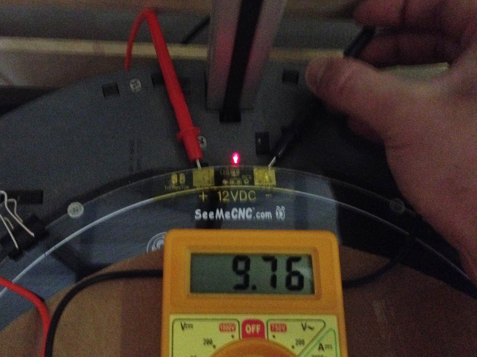

- Tincho85
 - Posts: 659
Re: Rostock 1 LCD problem
Yup, agree with Tom.
About the bed... checked the wiring with a multimiter? if not:
Turn the Heated Bed on (to 60ºc for example) and with a multimiter check the Heated Bed mosfet output of the board.
It should give +/- 12vDC. With hotend on could be less though.
Then check the voltage of the Onyx.
like this: Don't mind the value. It should be around the 12vDC
