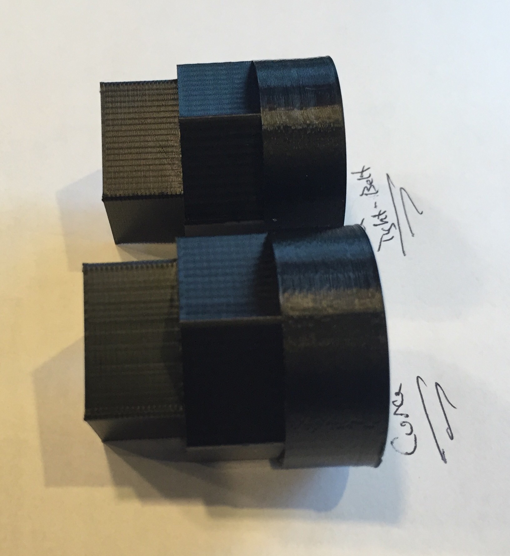

So... My belts were looser from the last round of modifications that I normally like, and I was suspicious that this had something to do with my print quality on the bandaid piece. Tightened the belts, reset my Z0, and bam - The print was absolutely identical. I couldn't tell a difference at all :/ I'll have to try a different slicer as the next test.

After I tightened the belts and cheapskates I reprinted and compared. It is much better but still present.

I reprinted using Cura. I dont think this is really any different!!

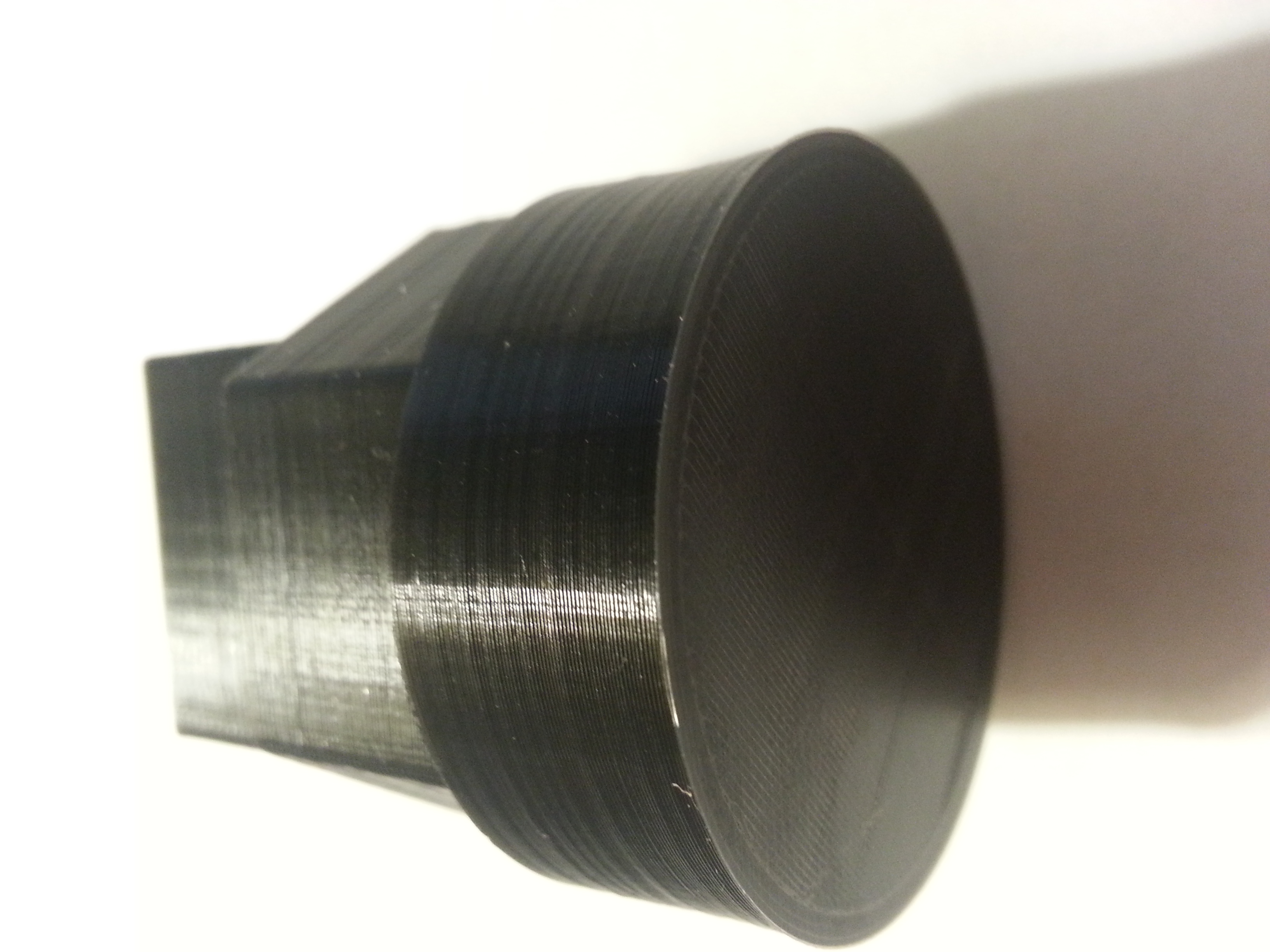

I wanted to bump this as I think it is very important, I was pondering this, and I wanted to throw this out there, I do think this is related to a problem I was having a few months ago with ALL of my prints, namely the printer would print in steps, stopping and leaving material and then continuing on. a reload of a clean configuration file solved it. here is a pic of what it looked like
if I did a print it showed the same thing is the radius of all the prints, this is the perimeter of a print. it would show extreme vertical banding which this produced obviously in the print
at first I thought this may be a problem with my extruder stepper not stopping its extruding when the head stopped, but working thru it with JJ seemed to suggest it was actually how the Rambo was interpreting the slice data as it did not matter which slicer I used. the hot end would stop and start as it made a radius, not on the straight sections of the print though.
