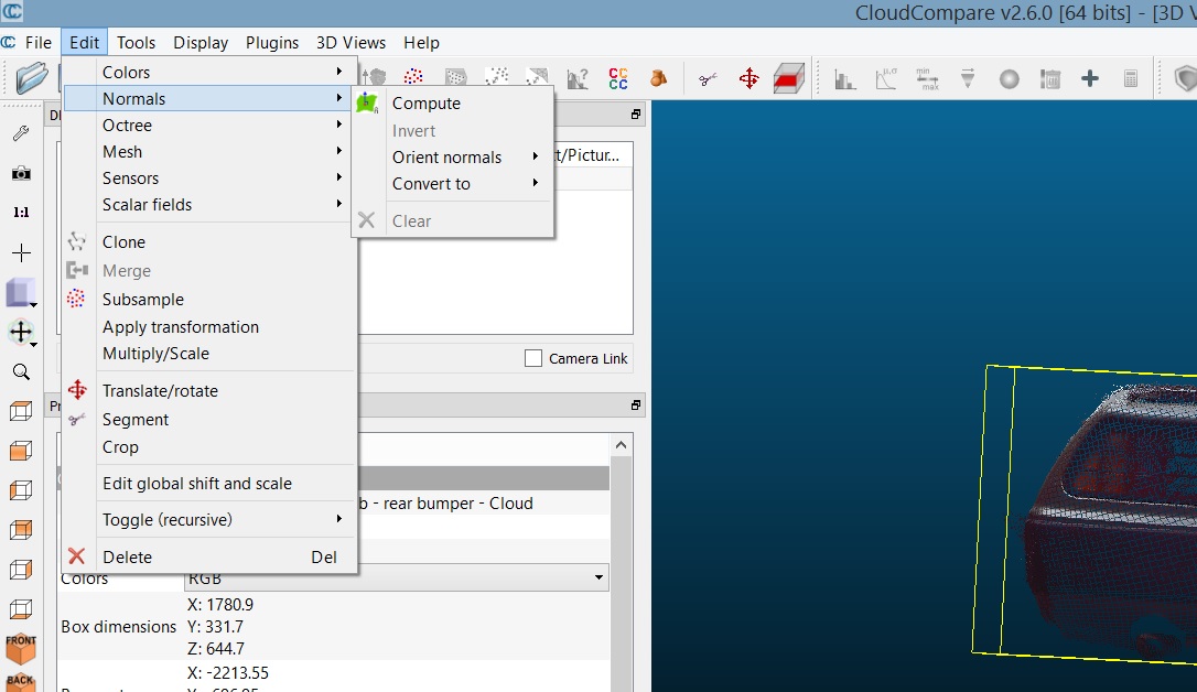

Re: Faro Focus 3D Scanner
Do you mind elaborating on how this works? I have my Faro scan project in CloudCompare right now and I see the Poisson Surface Reconstruction plugin, but it is grayed out. I don't know what you mean by building normals.schlrobe wrote:Actually, getting a printable surface out of SCENE is all but impossible. We have been using one for a few years now, and there is quite the involved process to make a printable file.
Go get Cloud Compare. This is free software for processing lidar scans data. You can load and register the raw FLS flies here, or import a ne57 file (which is how I do it). Once that file is ready you have to build normals (since SCENE doesn't use them at all), and once those are done just generate a Poisson surface from the point cloud. Export that and edit it in your favorite 3d modeling software to get what you want to print.
As an aside, we have been asking the software guys at Faro to implement a surfacing module for years. They keep asking why we want one. Apparently they don't quite understand why anyone would want a solid surface generated from scan data...

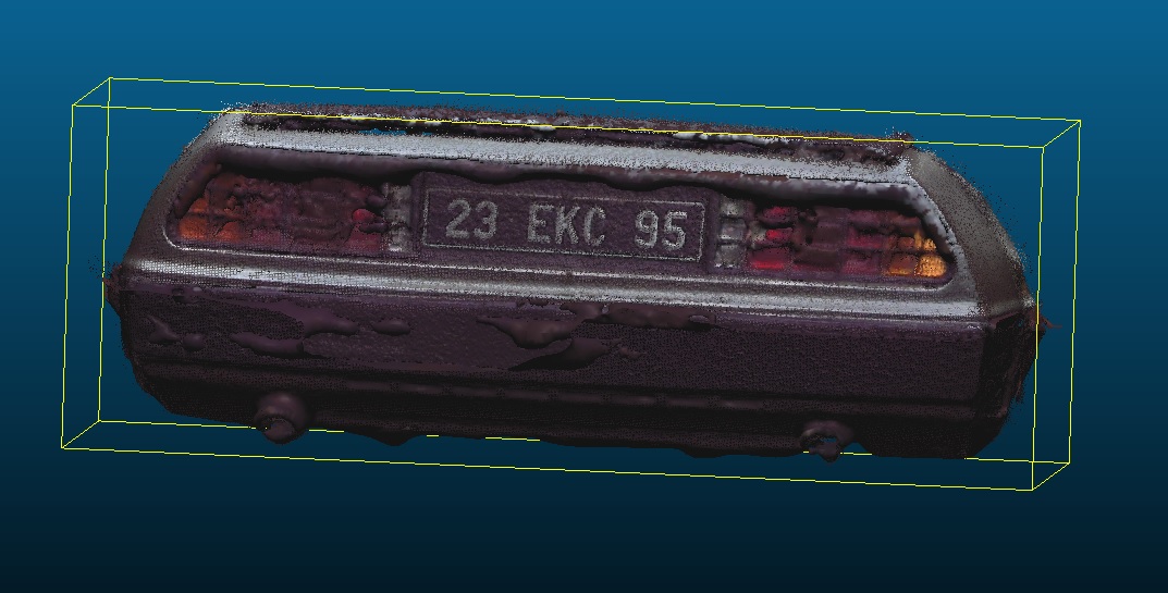

Normals (I think) means orienting the points in a unified direction. With both Computing Normals and Poisson Surface Reconstruction, you have to have the mesh or the Point Cloud selected. You can't perform the Poisson Surface Reconstruction without computing Normals first.soul_reaper_38 wrote:Do you mind elaborating on how this works? I have my Faro scan project in CloudCompare right now and I see the Poisson Surface Reconstruction plugin, but it is grayed out. I don't know what you mean by building normals.
Just set your expectations low with complex objects.
