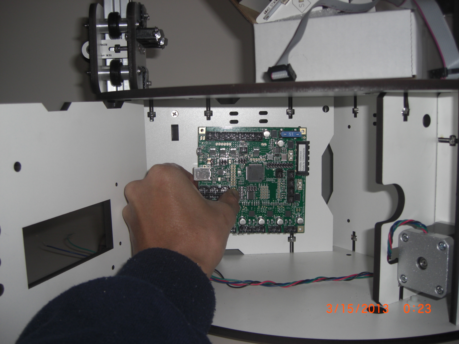

My lcd cables won't reach the rambo on my Rostock, And the box that the LCD came in says it cant be longer than 30cm.

The lcd is mounted directly across from the z stepper and the rambo is to the right of the lcd.... The connectors for the cable wont go through the square openings to reach the rambo and even if they did I wouldn't have the slack to open either door.....

I tried calling them but they are gone for the day and I was hoping for an answer today but I did leave a message. This is the lcd with the new connector. And the box it came in says not to go longer than 30cm bit I don't see how that would be possible. I will take some pictures if you like...
Bill
Re: LCD cable does not reach rambo
The pictures would be nice, none of us have seen this beast and there are no photos on SeeMeCNC's site!

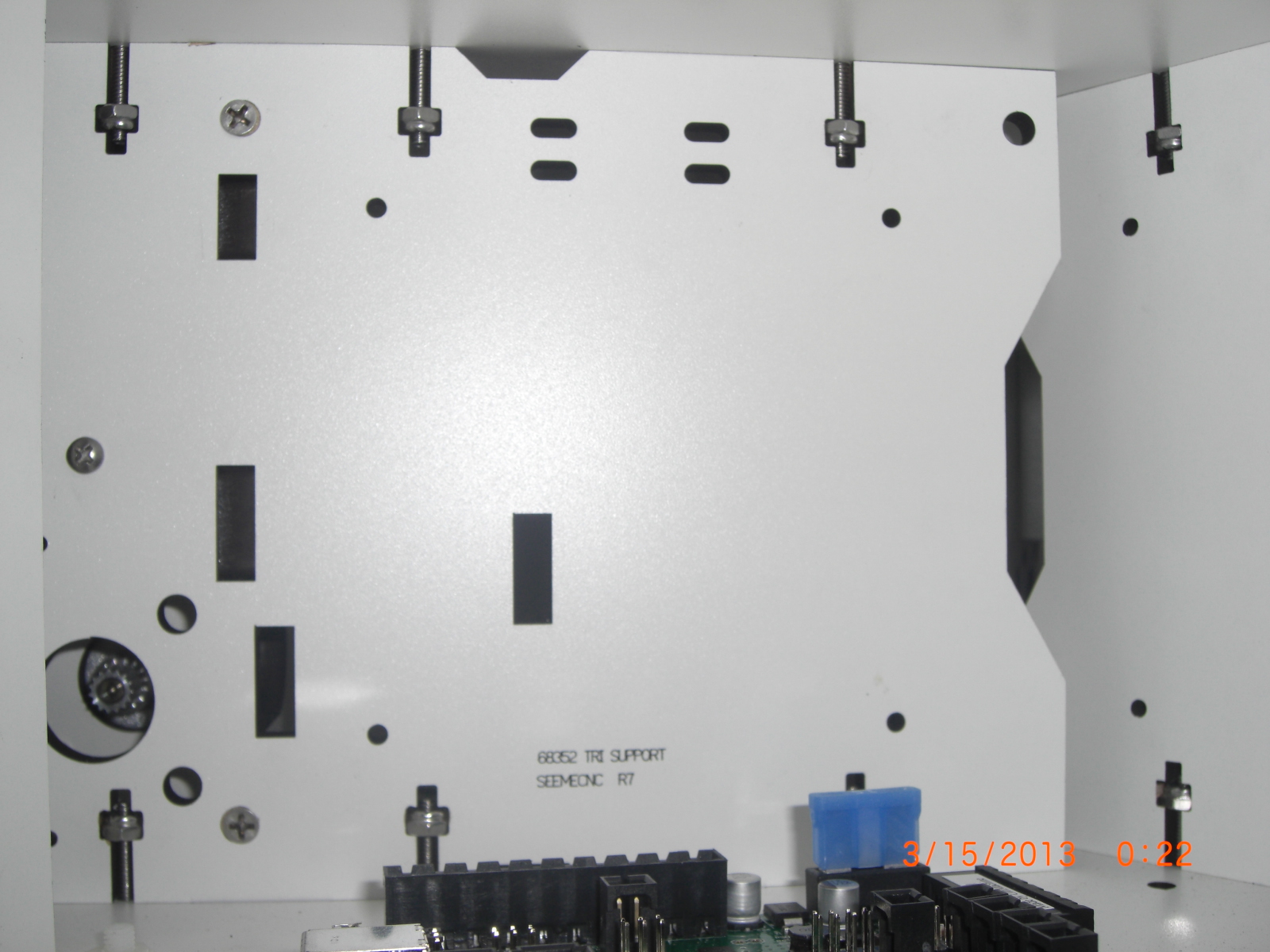

I see a spot to mount the rambo directly behind the lcd, I think that is the answer...

I think there are two ways to mount the LCD. One is flush which prevents acess to the SD card as bplemmons has it mounted. The second is to use the two brackets to angle the LCD. I did this on mine and mounted the Rambo behind it. Not a problem if you haven't run the wires yet.
I also used two standoffs between the Rambo and door to give me a little more clearance. Not sure if the wood version has the same holes.

Did you have to drill holes to mount the rambo on the lcd door? I have no holes for it on mine.
But i do have holes for it on the electronics door but dont have holes for the lcd

Based on your response it seems that the acrylic LCD door is different from the wood door. I only had to enlarge the holes for the LCD angle mounts. All holes were in the correct positions for mounting the Rambo board to the door.

this is where i'm mounting mine all the electronics in one location. the holes are already there.
Interesting, my white melamine kit is marked R7 too but does not have those holes for mounting the RAMBo. That would have been nice. I'll have to think about drilling a few holes and moving my board.
