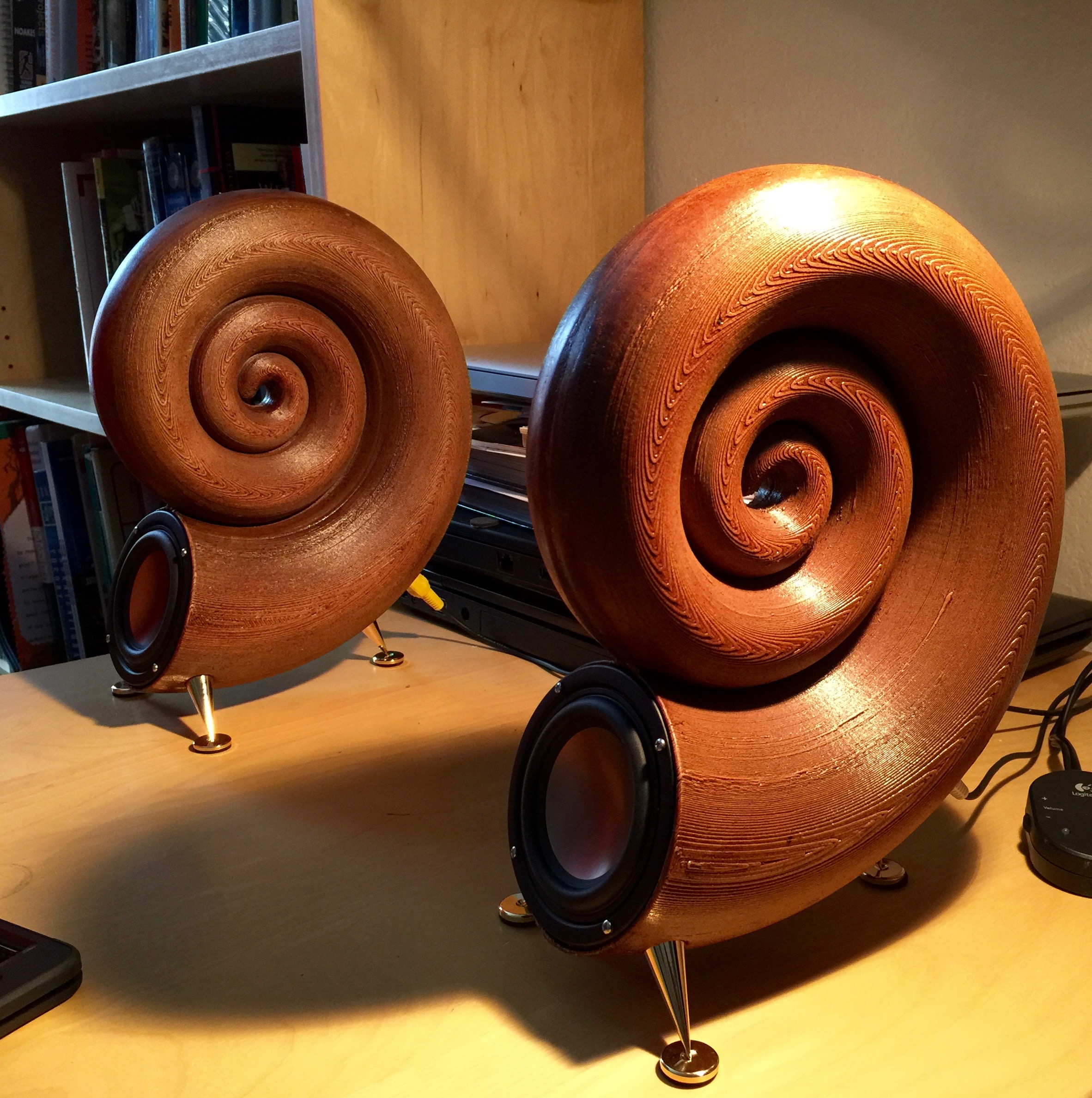

Post by artexmg »
This is how they look once finished ... they sound as great as they look :-)

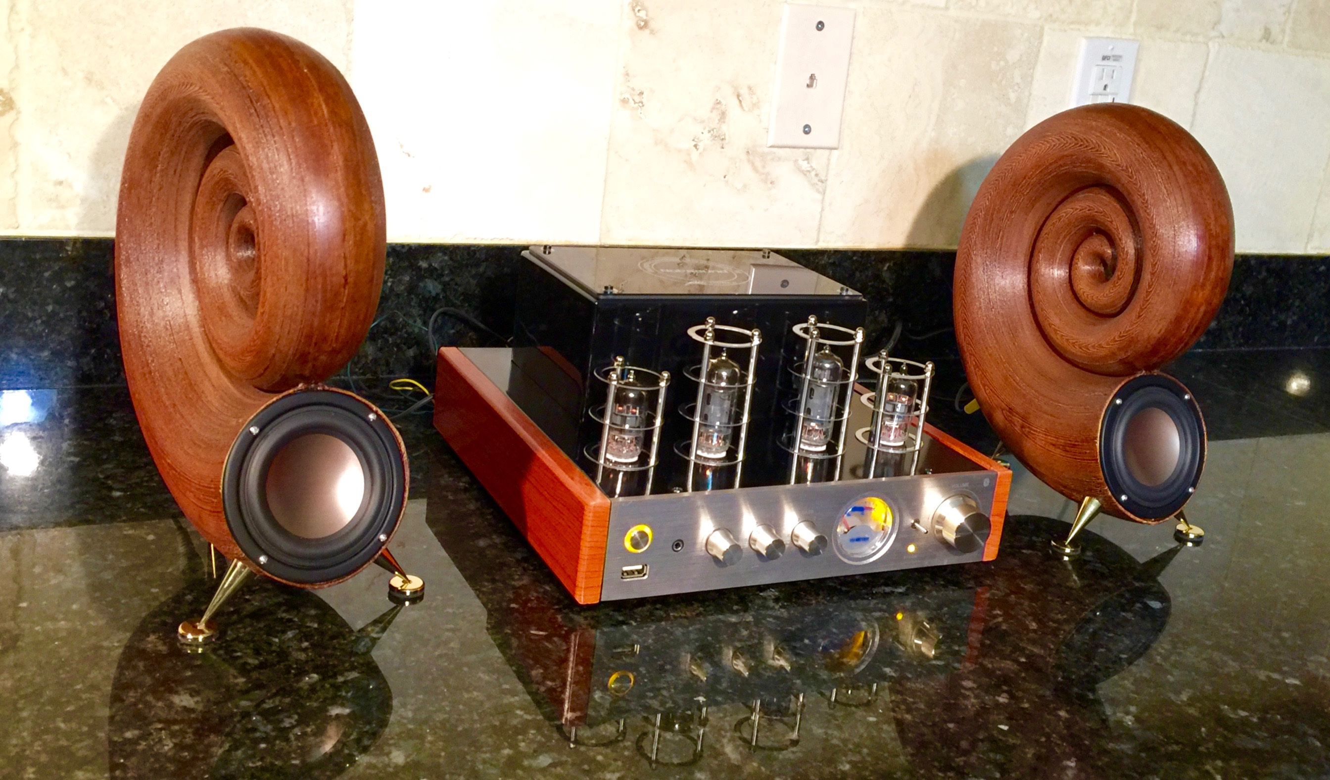

Re: Akemake Spirula Speakers
Post by artexmg »
And, if you pair them with a good, old, nice bulb-amp, then you got yourself an epic set!
