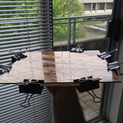

I just bought one of the 1/8 inch thickness sheets as you mentioned. It doesn't warp even at high temperature? I'm hoping to get away with it like this, without adhering to anything. Worst case scenario, I'm going to bond it to some polycarbonate.
*not actually a robot
Re: Ultem 1000 Polyetherimide
I just got my sheet in. It's completely bowed, but flexible enough to (probably/hopefully) be held flat simply with binder clips. I want to keep the sheet as-is if possible, to allow for easy part removal by gently flexing the sheet (if it ever becomes a problem).

Mine had a very slight curve to it, but it straightened out with the binder clips. I calibrated the machine after and it was almost spot on with the glass, only about .5mm in the horiz. radius adjustment and very minute changes in the axis stop screws. It prints accurately towards the end of the travel also.

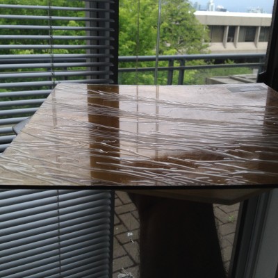

I had to stick mine on using a sheet of 12x12 heat transfer tape from 3m. The micro surface warping becomes VERY pronouce at 100c. It was even obvious with the tape on, but it helped tremendously.
So far it seems like it will work just clamped down. There is a tiny bit of waviness to the surface, but nothing that is worse than the variation of the nozzle to begin with.
My surface came smooth on both sides. I've done a couple prints on the shiny surface, but I'm going to sand it with some 1500 grit soon.

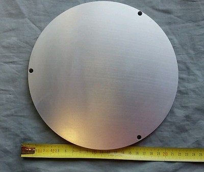

Ok. I've spent the evening googling with little joy. .... anyone know if there is anywhere to buy this stuff in europe?

OK, replying to myself, but I managed to find a very helpful guy here in Germany that produces custom PEI covered aluminium build plates.
Will report back when I have a chance to use it (still need to build my max v2....)
PM me and I can put you in touch if anyone is keen to buy from this guy

Ok - here is the pic from ebay. The guy is basically a one-man show (he is doing it for me over the weekend) so I'm not sure there'd be an option for group discounts... we could of course ask though. I paid 65 EUR for a 300mm plate - bit of a risk / unknown I know.... will take pictures of it and post as soon as I get it, which should be early next week.teoman wrote:Do you have any sample images??

Here is the link to the ebay listing that I found - I then contacted him to organise a custom size.... http://www.ebay.de/itm/Dauerdruckplatte ... 463be2ea88

Yes, including a coating of PEI. Exactly how thick I wait to see. He says it is "exoliert" with PEI, not sure exactly how that translates from German.teoman wrote:is that 65euros including the PEI?
My pei just cracked, and i need a replacement some time soon.
Edit: Exoliert is German for anodized....

Anodized? Then it is a few microns thick.

This is true. Do you think that will be an issue? My hope was that the aluminium plate would offer good strength and heat distribution.teoman wrote:Anodized? Then it is a few microns thick.
