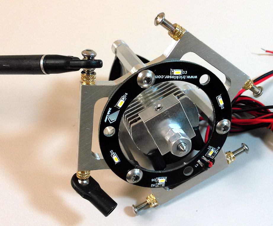

Brian - that looks suspiciously like the makings of a hotend platform?

Wow Brian, it looks amazing! Please tell us what is it exactly!
Looks like there are J-head hotends mount at the center, but i can't see mounts effector platform should have, so I don't know :?

bvandiepenbos wrote:Here is a little peek at something else I have been working on.
I laser cut the design mockup from wood over a year ago... just could not stand it any longer, had to make some aluminum chips this weekend just for fun. Now to find the time to test it out on my MAX.
Wow! I assume you are working on the mates for the Trick Trucks as well? I'm in for a set when ready!

bvandiepenbos
Posts: 923
Location: Goshen, IN
Post by bvandiepenbos »
Renha wrote:Wow Brian, it looks amazing! Please tell us what is it exactly!
more details...

bvandiepenbos
Posts: 923
KAS wrote:wow, when is that going up for sale?
Not sure when. Need to test it out first. And I need to meet with my local waterjet guy to discuss best manufacturing strategy.... Probably have him cut out basic shape in batches of 50, then I will do final precision machining, tapping, finishing, etc.
