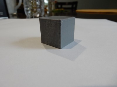

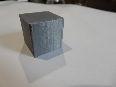

I was finally able to convert from Rambo to a Smoothiboard.  However after calibration my first test print leaves much to be desired.  This 20mm cube I printed with a .2 layer height, Material PET+.  The cube measures 20.03 x 20.07 x 20, indicating the the dimension is not an issue.  As you can see from the pictures I cant get the edges of the cube to be without the bulges.  Also some surface imperfections drive me crazy.  Any advice would be welcomed

I think you're over-extruding. Better processor or not, calibration still matters.

As I said the calibration was done, I did few prints adjusting the extrution, anything under this setting gave me gaps in the print.Jimustanguitar wrote:I think you're over-extruding. Better processor or not, calibration still matters.

It just looks "full". Especially in the second picture.
If you drop it to 95%, what's your print look like?

What's your Jerk setting and how fast are you printing?

The above cube was printed at 30mm/s speed. As far as Jerk Movement its based on the config-overide file.

You might want to try increasing your junction deviation, unfortunately it's not clear to me without sittling down with a pencil and working through the grbl code what that setting actually means in terms of absolute value.
With 90 degree corners the planner has to reduce speed to whatever the minimum initial speed is, if it's too low, the head will end up depositing extra plastic at the corners.
It also looks like you don't have enough cooling and I would tend to agree it looks a bit like over extrusion.

Actually I just read the article on grbls path planner (it's what the smoothie one is based on). It's similar to the Mach constant velocity algorithm, IMO it's not a good choice for a 3D printer, for a Mill it makes a lot of sense.
Your specifying the maximum deviation from the given path, your going to run into issues with rounded corners if that number is too high and if it's too low you'll run into an issue where you nearly stop in corners, which will likely lead to over depositing of plastic because of the hysteresis in extrusion.

It looks like you hit the nail on the head. I have increased the junction deviation from .01 to .05. The print improved dramatically, I'd say almost perfect. I wish I could calculate the proper setting without guessing, however the math is to over the head for me. For now I will keep on tweaking the Junction deviation until its perfect.Polygonhell wrote:You might want to try increasing your junction deviation, unfortunately it's not clear to me without sittling down with a pencil and working through the grbl code what that setting actually means in terms of absolute value.
Thanks Polygonhell
PS I also increased the acceleration from default 1000 to 3000

Quick update.  The final setting that gave me the best 20mm cube print was to increase junction-deviation to 0.35.  The edges came out sharp and on the same plane as the cube surface.  It would be nice to have a discussion where we can set up Smoothieware to be perfectly dialed in for Rostock Max 2.

It was 0.35. On the small print it gave me a perfect cube. However on a large print I dropped it to about 0.20, due to jerky movement over a large print. Polygonhell mentioned that there is a mathematical way we can get a precise number for junction-deviation for Rostock.
As per my conversation on smoothiboard IRC:
"[22:54] <wolfmanjm> plasma_: smoothie does not use jerk it has a different algorithm. If your corners are round you probably need to increase you acceleration.
[22:54] <wolfmanjm> BTW the default is 0.05
[22:55] <wolfmanjm> and has no relationship to whatever repteier uses"
[23:24] <wolfmanjm> I'd start with 0.05 and increase as needed
So I will try to experiment more with the acceleration while reverting back to Junction-deviation of 0.05. I'll post my results as I try to print some cubes with various acceleration adjustments.
