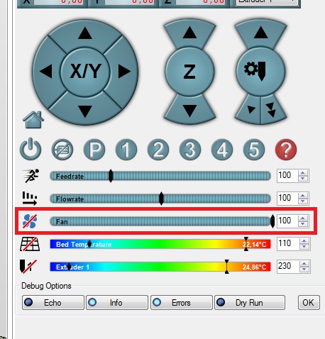

You can also turn it on/off using the manual control of Repetier-Host. Here:
You want to use that fan to cool the hot end or the layers you print?
If it's for the hot end, when you connect it to the mosfet HEAT0, it turns on automatically when the temperature of the hot end is above 50ºc
If it's for the layers of the print, when you connect it to the mosfet FAN0, it works with the cooling options of your slicer.

nope sry. repetier turns on and mouves the bar from 0-100 but i get no voltage out on either fan0 heat1 fan1 or fan2. thats why i thought my board was broken. but m42 p6 s255 turns 12v on fan1.
and yes. i am looking for a fan to help in layer print.
thx.
thx.
