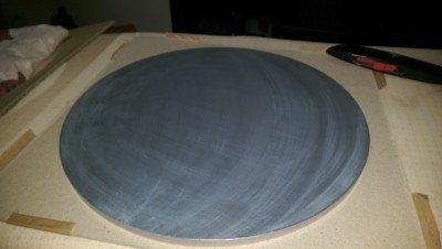

Ha! It arrived yesterday, along with my Rostock max v2 kit.... One long night (oh my God so much tape), managed to get a little past checkpoint 1.
Didn't get a chance to unwrap the aluminium/pei board yet, honestly from your first comment I thought you were being sarcastic.... Will post photos when I get home

Attached potato cam pic.... Looks uneven/dirty in the pic, feels incredibly smooth to the touch but you can feel that it is coated.
