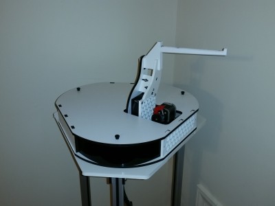

So I looked around for a way to move the extruder stepper to the top of my Max (preparing to build an enclosure) and while I swear it's been done before, I couldn't find any downloads for it. So I modeled my own and want to share.
First up is the actual bracket to print to move the stepper:
http://repables.com/r/453/
And next is the stepper feed knob, the one that came with the kit was too long to fit the whole assembly between the top hole of the melamine:
http://repables.com/r/454/

I was able to get part 2 of this modeled and printed - I wanted to point a fan at the extruder stepper motor, but I didn't want anything to get in the way of proper airflow. So I added a fan mount and vents to the spool holder and one of the upper faceplates.
I think since the new models don't really stand on their own (it would be silly to print these without having first printed the top motor mount), I just added them to my existing repable upload, http://repables.com/r/453.
Uploaded a few more pictures there too. I made a small oopsie and didn't consider the stepper getting in the way of spool placement, so that's why the arm is at a funny angle now... I'll get around to fixing that sooner or later, but it works for now...

Alright, the last part of this mod is finally complete! I modeled a new spool arm that's higher, thinner, and longer than the stock one. I no longer have trouble with oversize spools of filament, including the 3lb Amazon trimmer line that has such tiny little holes.
I haven't tested this arm without my cooling-fan-modified holder, but I suspect that it would not work well due to my side panel being 4mm taller.
Here are some pics to demonstrate how the final setup winds up looking. (But please ignore my in-process JFettig enclosure!) Same URL as always, http://repables.com/r/453.

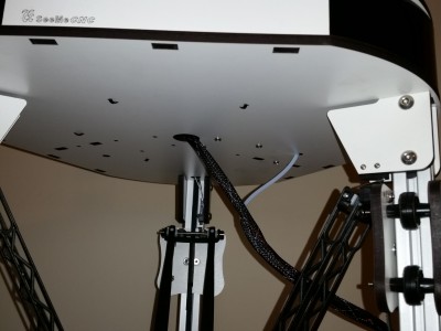

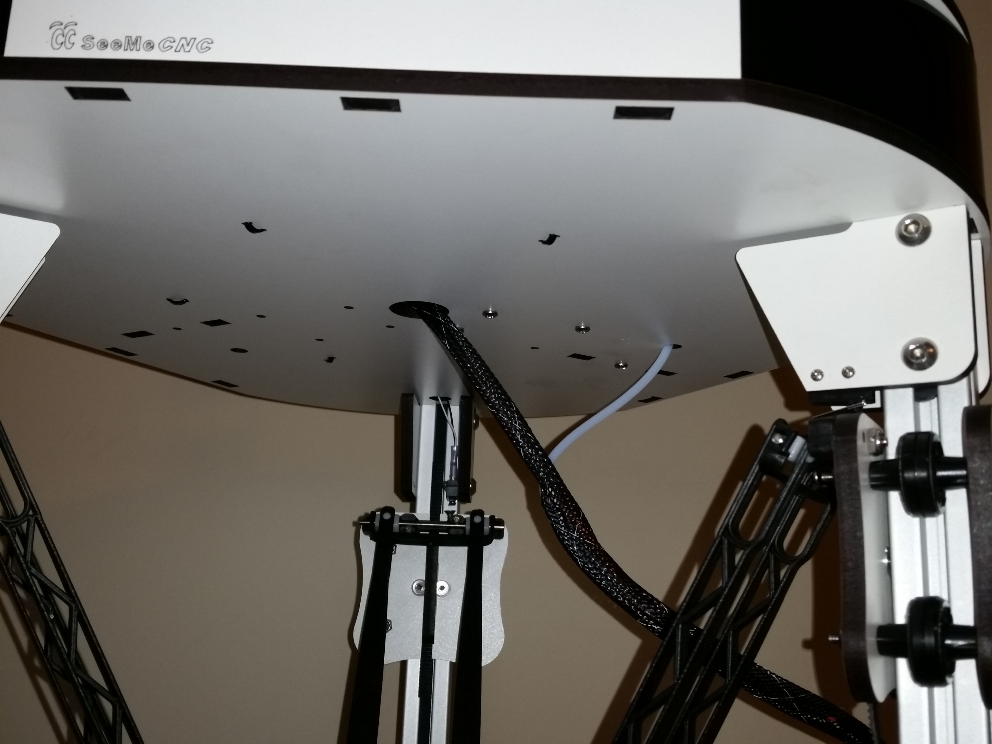

Nice setup guys, I just started to change my Black Max to Dual printing. I have the Legends pack from E3D and I like the idea of removing the extruder motor out of the enclosure at the same time.
I didn’t run extra wires into the towers last year when I assembled my printer, so I am toying with putting a tube down the back Z tower to create a new channel for the extra wires. With the belts in 2 channels and the cheapskates in the other two, I hope to get the wires inside one of the cheapskate channels. What have you done for the extra wires?
Thanks for posting your parts for the dual extruder mod.

I just got dual extrusion working myself and that's exactly what I did, minus the tubing. jdurand had a good idea about using plastic strapping to isolate the wires from the cheapskate rollers, so I went to home depot and scavenged some from their lumber department. It was scrap and they were happy to let me take as much as I wanted.techstorage wrote:I didn’t run extra wires into the towers last year when I assembled my printer, so I am toying with putting a tube down the back Z tower to create a new channel for the extra wires. With the belts in 2 channels and the cheapskates in the other two, I hope to get the wires inside one of the cheapskate channels. What have you done for the extra wires?
I'll post some pictures of everything when I get back in town next week.

The plastic strapping sound easier to deal with then tubes. Thanks, I have plenty of scrap strapping to use also.
