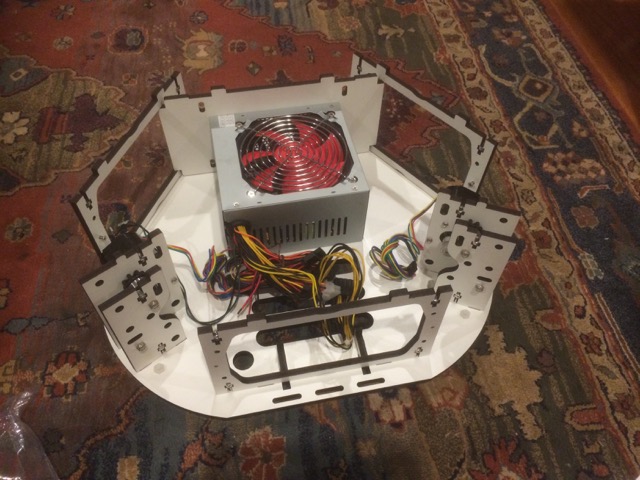

I've been saving up all my pennies for this puppy. I purchased it from MatterHackers since they are a local outfit.
I decided painting wasn't in the cards for me. Step 1, unpeel the tape. It took me about 2 hours while watching National Treasure.
I would have thought the final pile would be bigger, but I finally finished peeling and Nicholas Cage saved the declaration of independence.
Bottoms together. Kids are about to get home, so that's it for today.
My first solder! I'm more proud than I should be I think.
the 18 gauge wire did not have the secret "fish" inside the wire. I ended up using filament
only to find the secret fish hiding in the 22 gauge wire. And it was most helpful too!
Obligatory selfie with a major milestone completed. This thing is WAY bigger than I thought!
I realized later that I installed this extruder backwards. This extruder is pretty danged cool. I think I might need some dampeners for it though. I put cork on the other motors, but the kit only came with 3. Maybe some squishy washers on the bottom screws would keep it from rattling.

You didn't install it backwards.

I know what you are thinking: "that doesn't look very hard" but what you don't realize is it's not just a nylon washer that you have to use a small wrench 1/4 turn at a time on, it's a bunch of nylon washers! This took me HOURS!
