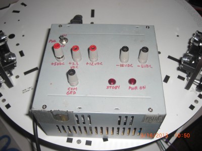

I'm using the gray wire as the positive lead on an led indicator (led comes on when power is switched on) and the purple wire as the positive lead for a standby power indicator.(stays lighted as long as the ac cord is plugged in)
here's an example of one that I modded A while ago for a bench top power supply. Same concept
