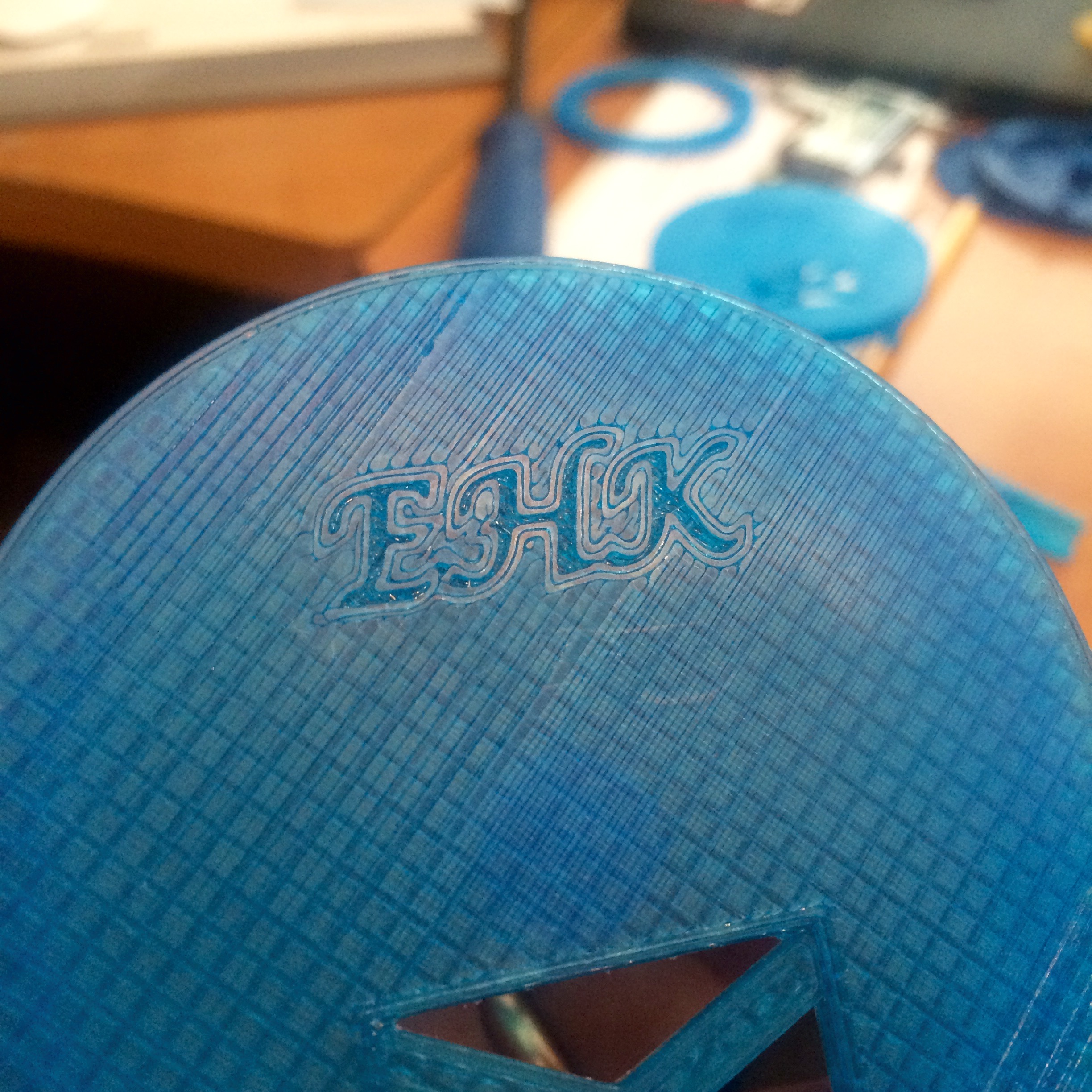

Here is an example of my "engraving" technique:
This is where first layer height and dead-on slicing parameters is critical. This first layer is just ever so slightly undefiled as can be seen by divots at the tops of the letters. A little tweak here with a special first layer factory should close those. This is quite a good embossing that rivals what I can do in KISS>

Check your infill outline overlap on the Infill tab - increase that to decrease the divots in the letters.
