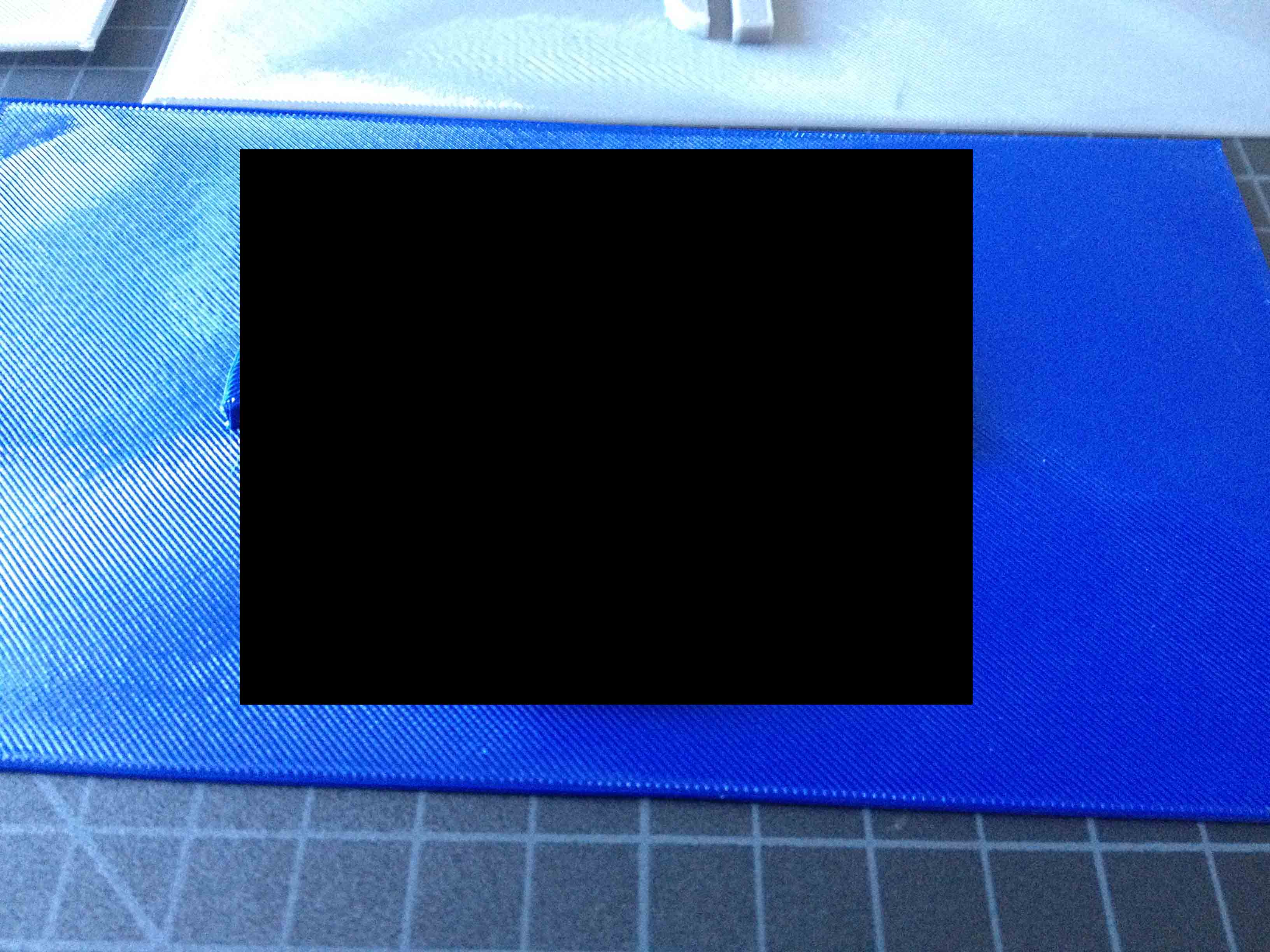

I'm still trying to figure out why v3, with basically identical settings to v2.2.2, produces a crazy terrible top surface. Did they change the volume calculations? Do I need to adjust my flow down? Why would they change something so drastically? At this point, I'm still using 2.2.2 because it is vastly superior.
Fancy infill is okay, but they removed two features in regards to infill: random infill placement, and the ability to alter the rectilinear angles for top surfaces.
One step forward, two steps back in my opinion.

The problem is on LARGE top surfaces... I cannot post a factory file of the exact models because they are for a client, but like I said, model yourself a rectangle that is 8" x 4" and .9mm tall, print it at .3mm layers with 100% infill, same settings, both versions.

large small, whats the difference? Are you running 1% infill or something? Export out your print profile(.fff) if you can't post a factory file. I'd be very curious to see what your settings are that you're working with to have such issues.
The default settings going from earlier versions of S3D are very different than 3.0, I can only imagine its some default setting that you haven't changed that is bugging you. I posted up my FFF files - download the ABS file and try it out.

Of course big and small makes a difference. I don't really appreciate how you're treating me as if I'm an idiot. If I had a setting "wrong" it's because they changed how the setting acted without proper documentation.
Here's a factory file, because FFF profiles are in a mysterious place in 3.0. And actually this factory file has settings that I modified while trying to fix the problem, but the problem still exists. I originally was running a 15% outline overlap and a 10% thin wall overlap, not that the thin wall comes into play.

First thing I see in your settings - your infill is set to 25% printing every other layer with 100% infill - this is how they did it in previous versions and the latest version allowed it to be set to "print all angles on one layer" - or use the "grid" option.
Your extrusion width is set to less than nozzle diameter - at .38mm vs .4mm, .3mm layer thickness at .38mm width will give you troubles. Print speed is at 70mm/s which is quite fast - the solid infill underspeed is at 100%, lots of settings are working against you.
Suggested settings: .44mm extrusion width(use the extrusion multiplier or filament diameter to adjust actual extrusion width), .20 or .25mm layer thickness, 50mm/s or less for solid infill(you can adjust this with the solid infill underspeed) and use grid or hexagon infill. If you want to keep using rectilinear - turn up extrusion width to 150-200% but it won't be as good as grid or hexagon.
x/y and z axis movement speeds can all be set to 300mm/s - some people like to turn x and y down for large prints(like your 4x8" print). I choose to leave them be as I haven't had any issues.

Those were all variables I was changing. Just try and print that shape with any settings, and show me, then I will try the same settings, and we'll see if it's the machine or the g-code that is the difference. I suspected a hardware problem at first, but it went away the instant i changed back to 2.2.
I'm sorry if you were really trying to help, it seemed like you were just trying to be condescending. I tried everything you suggest, I went through half a kilo of PLA trying to troubleshoot the issue. I can guarantee that there is something different about the g-code that is causing the problem. I tried to compare the two gcode files, and couldn't figure out what the difference is. If you can print that rectangle with 3 solid .3mm layers and have a nice finish on the top one with gcode from v3.0, I will eat my hat.
Notice that the object is solid. There are no portions where internal infill becomes relevant.

Here are a couple photos illustrating the difference between 3.0 and 2.2... and these two examples were printed at the EXACT same settings, minus the settings missing from 2.2 that are in 3.0.
It wasn't just the different filament, the problem was present regardless of the filament used.
