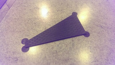

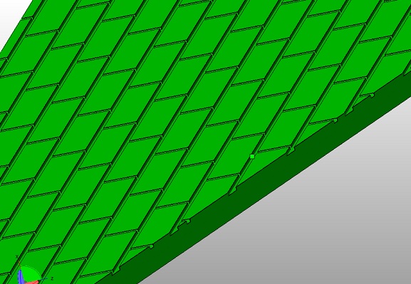

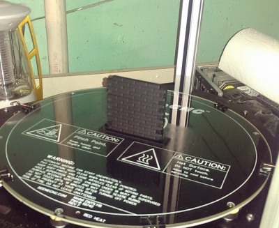

While it is painted, the texture of the bricks is there.
I wanted to initially do the bricks in sections like this, but it used too much material.
So I split the thickness in half and broke the back wall up into sections. The suggestion about "mouse ears" to keep the corners from curling worked flawlessly. Thanks to (I can't recall who) posted about that.
