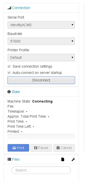

on the left hand side we have our printers connection info:
[img]https://lh3.googleusercontent.com/-Ypqg ... pture8.PNG[/img]
serial port is where the printer is plugged into, if you have the webcam installed there will be 2 options of possible connections.
select one of the serial connections, set the baud rate to 57600 and try to click connect.
if that was the correct serial port you should get a updated "state":
[img]https://lh4.googleusercontent.com/-_DkQ ... pture9.PNG[/img]
