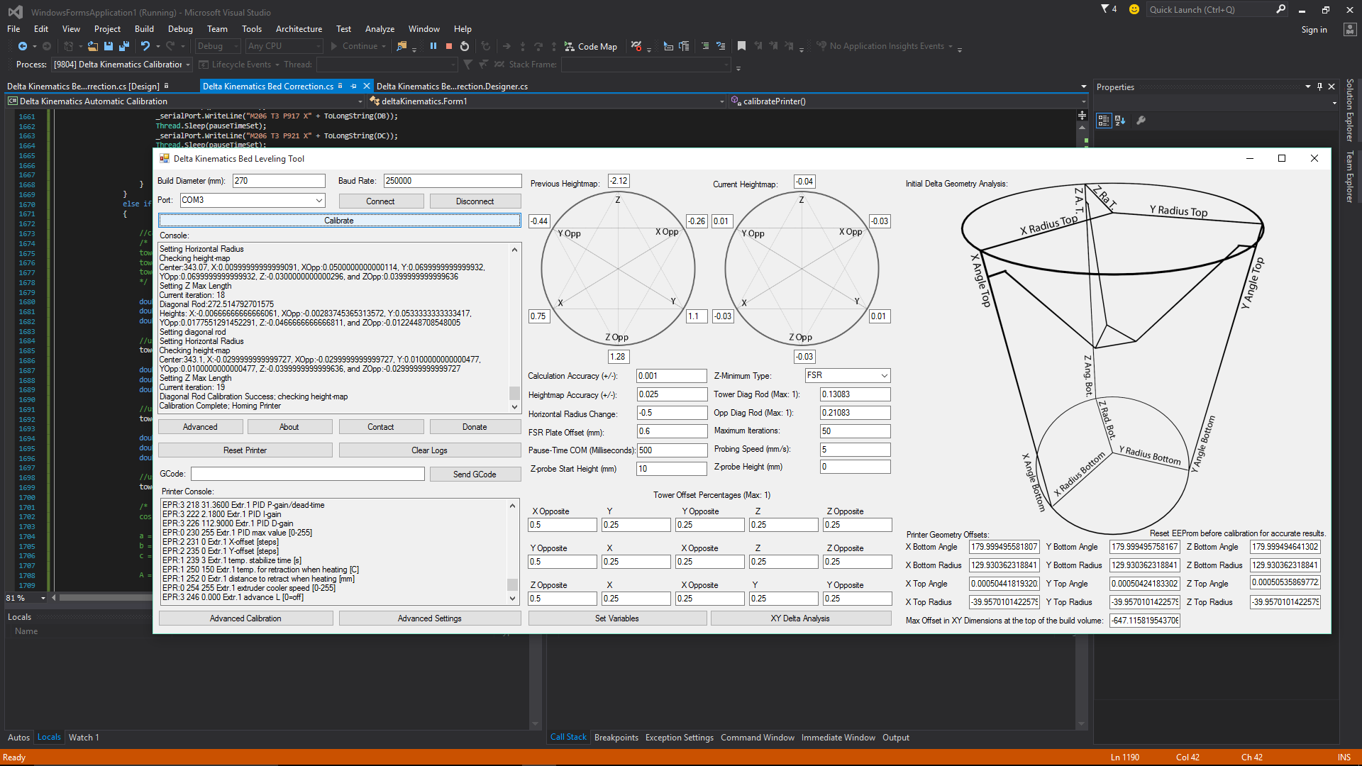

OpenDACT(open source delta automatic calibration tool) is an automatic calibration program meant for delta style 3d printers running the repetier firmware.
Update Log:
Version 3.1.0A - Timing fixes, calibration fixes, tons more
Changes:
-The program now utilizes responses from the printer to initiate the next step of the height map generating process.
-Also, the calibration algorithm is ran on a separate thread than the reading thread. This prevents the printer console from being locked up.
-There is also a manual calibration included on the third tab of the advanced area - which utilizes the same exact algorithm as the automatic calibration.
-Slight changes to the calibration control flow, the steps per mm is now corrected afterward. This reduces the error between the horizontal radius changes and the steps per millimeter.
-Heuristic mode fixes
-Disconnection fixes
-Stop button for calibration
-Basic mode is now fully iterative
From default settings on my printer, I got a successful calibration in 3 iterations. After randomizing values (tower offsets, horizontal radius, alpha rotation), I had a successful calibration after 9 iterations - would be faster if heuristic was enabled.
-Do not run this if you zheight is off by more than 10 millimeters(without changing settings), your nozzle may crash into the plate.
-Make sure you change the Zmin type before running.
-Use G31 to check your probe.
-The advanced calibration does not differ much from the basic calibration at the moment, use either.
I will be changing the basic calibration eventually, but for now it uses the advanced calibration code without checking the offsets. It works the same, if not better, but it will take way longer.
How to:
-Run setup for first time use, run .exe for 2nd+ use.
-enter build diameter
-enter baud rate
-select COM port
-check settings
-press calibrate
-when log says "Calibration Complete", disconnect and close application
-print
This program has not been vigorously tested, there may be some errors, so keep close to the kill-switch. If this causes errors, then copy the console and send it to my email with a description of what you think may have happened.

To give an explanation of how this program works, I will briefly describe each step.
/* The program in its current state has the ability to calculate your steps per millimeter for your printer if you do not know it(you Really should however), but it is needed to accurately changed the XYZ offset. */
//XYZ offset
This is essentially virtual endstops.
//HorizontalRadius
The program simply averages the heights of the build plate at the towers and virtual towers at the edge of the build plate. This value is then subtracted by each tower to give the new tower heights, and multiplied by -0.5 then added to the horizontal radius. This simply balances the points around zero.
//Delta Radius
Delta Radius is currently bypassed due to changing XY scaling issues. (Replaced with XYZ offset).
//Alpha Rotation
Now, having all non-virtual towers calibrated, the opposing towers need calibrated. This is done partially via alpha rotation.
For instance, when you increase the base value of A by 210 to 211, it increases the virtual tower opposite of the Z tower by 0.5 and decreases the virtual tower opposite of the Y tower by 0.5. Alpha rotation does Not affect the opposite tower of the tower changed or any of the non-virtual towers. Given this, the virtual towers can all be balanced, i.e. the values will all be equivalent but greater than or less than zero (unless you are not from this planet.)
//Diagonal Rod
To give an example of what happens when you change the length of the diagonal rod, if you increase the base value, in my case 269 to 270, the XYZ towers will be increased by approximately 13% of the value changed (1, so 0.13mm) and the virtual towers will be increased by 21% (0.21mm) of the value.
This presents an issue, but nothing that can't be fixed! Given the situation, you could either increase or decrease the value of the diagonal rod until all values are equivalent, but then all values will be greater than or less than 0. But since these heights are all the same it can be canceled out by changing the value of the horizontal radius until all values are approximately zero.
Getting through these steps, it is possible to get a theoretical tolerance of +/- 0.0001mm(the programs settings), giving a perfectly flat bed. (Even if your bed was mechanically warped.)
Following these steps, it is entirely possible to calibrate a delta with only modifying values in the EEPROM. That is what the program does for you! Except all you have to do is enter your current settings and then get your new values right back.
And if your calibration wasn't close enough the first time, you can go through again! But that would only apply if you were planning on printing something 1/10th the thickness of a piece of paper.
//How to use it
Enter in your current settings, then press calibrate, then copy the change data back into your EEPROM. More information is available when you hover over the input boxes in the calibration tool.
Since this is not a compiled program (just Javascript/HTML, sorry I am lazy), I am making it open-source, anyone can improve it and modify it to their need. The current version can be downloaded off of my GitHub page - https://github.com/RollieRowland/Delta- ... ation-Tool
Version 1.0.3 is now up on GitHub, it is best to keep the program up to date, as I make corrections/improvements every day.
-This calibration has only been tested on my Rostock Max V2, although it is set up to work with any delta style machine.
-If the results are not very accurate, then you will have to modify the expert settings.
-If this does not improve your printer at all you can pm me or reply to this post, as there may be issues with the program.
-If you have any recommendations for me to change or add to the program, then pm, reply, or email me.
