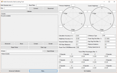

OpenDACT(open source delta automatic calibration tool) is an automatic calibration program meant for delta style 3d printers running the repetier firmware.

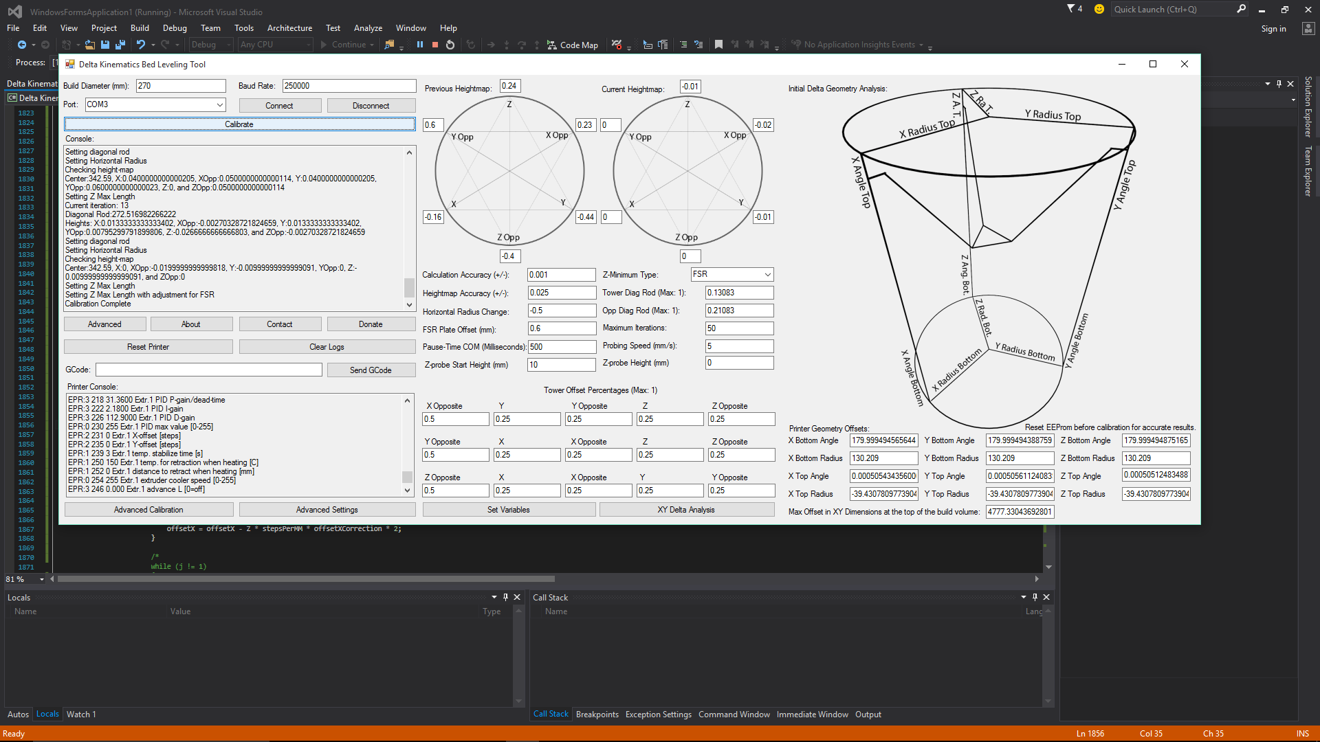

Version 3.1.0A - Timing fixes, calibration fixes, tons more
Changes:
-The program now utilizes responses from the printer to initiate the next step of the height map generating process.
-Also, the calibration algorithm is ran on a separate thread than the reading thread. This prevents the printer console from being locked up.
-There is also a manual calibration included on the third tab of the advanced area - which utilizes the same exact algorithm as the automatic calibration.
-Slight changes to the calibration control flow, the steps per mm is now corrected afterward. This reduces the error between the horizontal radius changes and the steps per millimeter.
-Heuristic mode fixes
-Disconnection fixes
-Stop button for calibration
-Basic mode is now fully iterative

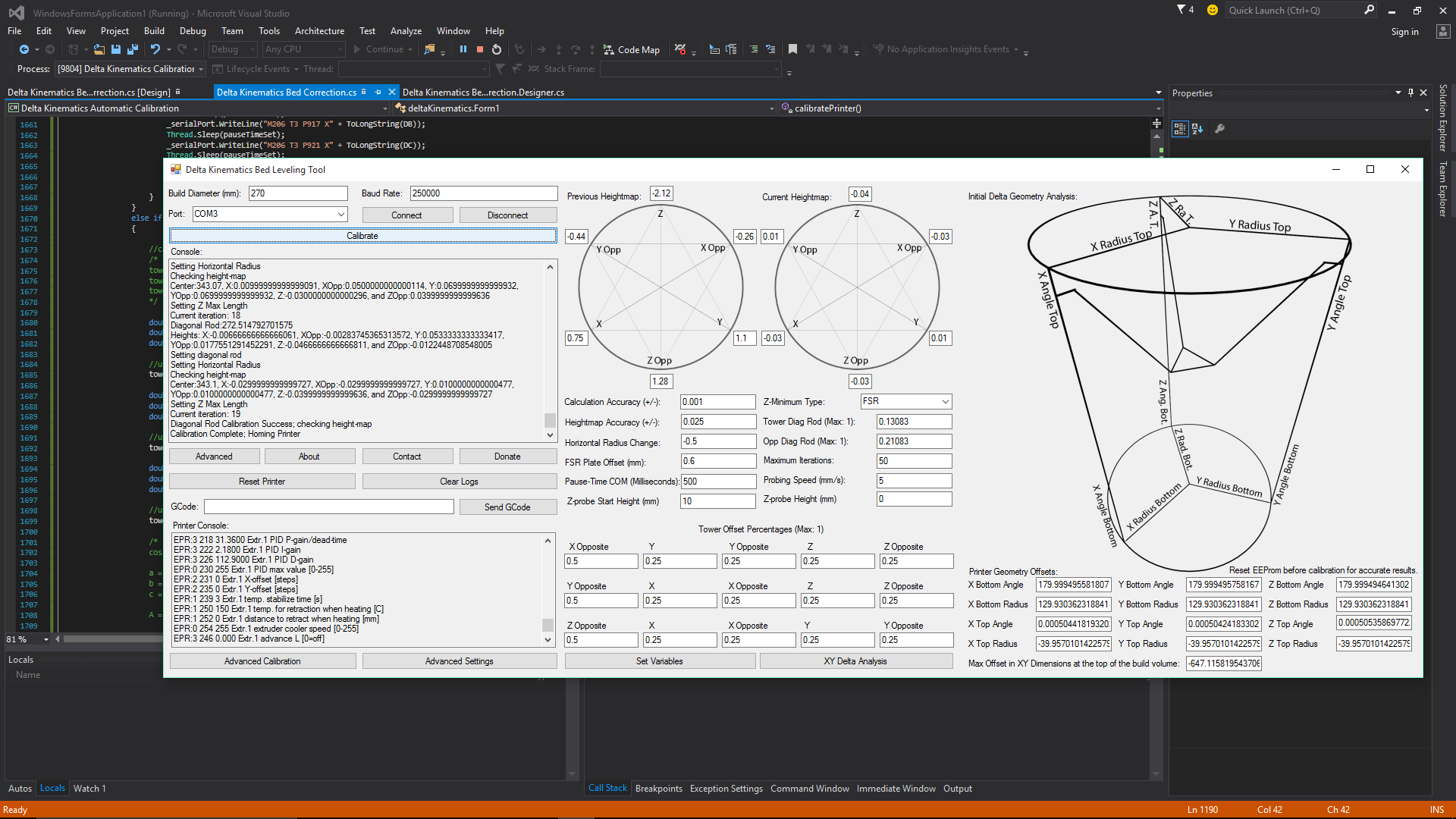

From default settings on my printer, I got a successful calibration in 3 iterations. After randomizing values (tower offsets, horizontal radius, alpha rotation), I had a successful calibration after 9 iterations - would be faster if heuristic was enabled.

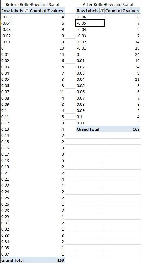

Ok, I've just corrected the issue that was causing the XYZ offset to send absurd (20,000+ steps) values back to the printer. This version will include scaling error minimization, 3 different calibration methods, a working UI, damage prevention(no values get sent if they will break your printer), and a still not yet completed tower analysis. The tower analysis is not pertinent to the calibration, which is why I am going to upload the version anyway.
Tests(all EEPROM values reset prior to testing and at 270mm build diameter):
Test 1: Basic Calibration - Tolerance: +/-0.01mm - 6 iterations.
Test 2: Basic Calibration - Tolerance: +/-0.01mm - 8 iterations.
Test 3: A.I. Calibration - Tolerance: +/-0mm - 17 iterations
Test 4: H.A.I. Calibration - Tolerance: +/-0.01mm - 30 iterations

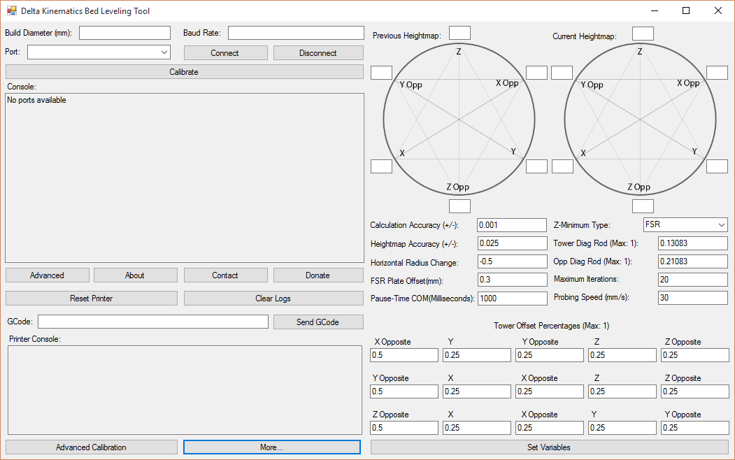

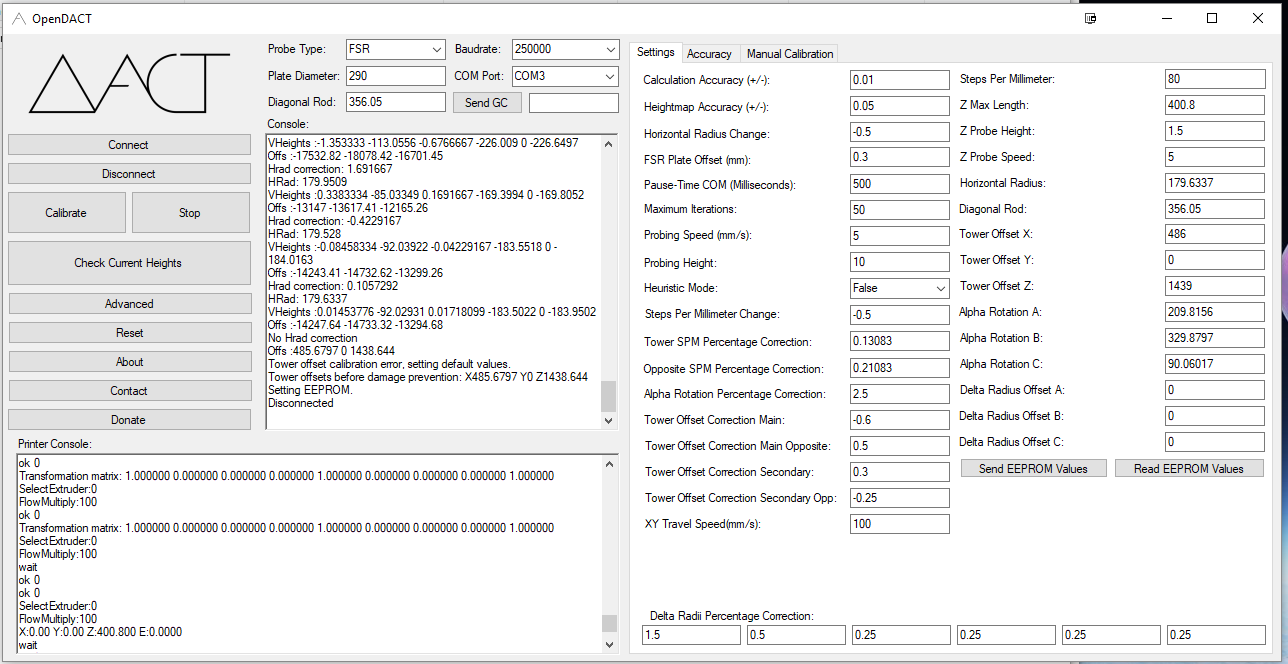

How To:
Basic Calibration:
-Enter build diameter
-Enter Baud Rate
-Select COM port
-Click connect
-Click Calibrate
-Wait for console to read Calibration Completed
-Disconnect
-Close application
Advanced calibration mode:
-Enter Baud Rate
-Select COM port
-Click connect
-Click the advanced button
-Click advanced calibration
-Acquire patience
-Once finished, you can open the "More..." tab and write down the changed values to save your self time in following calibrations.
-Disconnect
-Close application

TLDR Update: This is an automatic calibration tool for delta printers running Repetier 0.91+. Also, you need a Z-Probe.
Currently, the program is set to only calibrate within a tolerance of +/- 0.05 mm, however, my printer finished with a tolerance of +/- 0.02mm. (Second test was +/- 0.015).

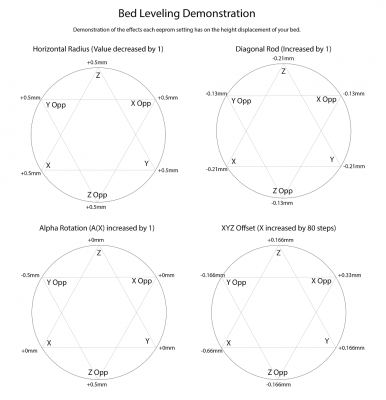

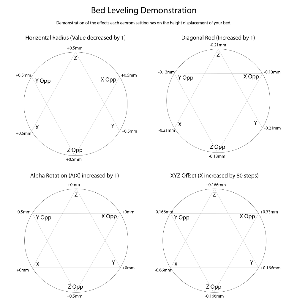

I very recently started to work on a program which will calibrate a delta style 3d printer, which I made to calibrate my Rostock Max V2. This calibrates my printer without even touching the endstops, shimming the bed, or any other interesting method with which I have seen. But with recent tests, I have corrected my printer from a tolerance of about +/- 2mm (yeah, it was far off) to a tolerance of approximately +/- 0.015 in less than ten minutes.
This program corrects the Alpha Rotation, XYZ offset, Horizontal Radius, and Diagonal Rod length. I will go into more detail on how this is done later on in this later on in the post.
Based on tests:
This WILL calibrate your bed even if your towers aren't square.
This WILL calibrate your bed even if your endstops are off, in fact, you won't even need to touch your endstops with this calibration.
This WILL calibrate your bed even if your borosillicate plate is warped. (Of course only to a certain extent)
This WILL calibrate your bed if your bed is slanted.

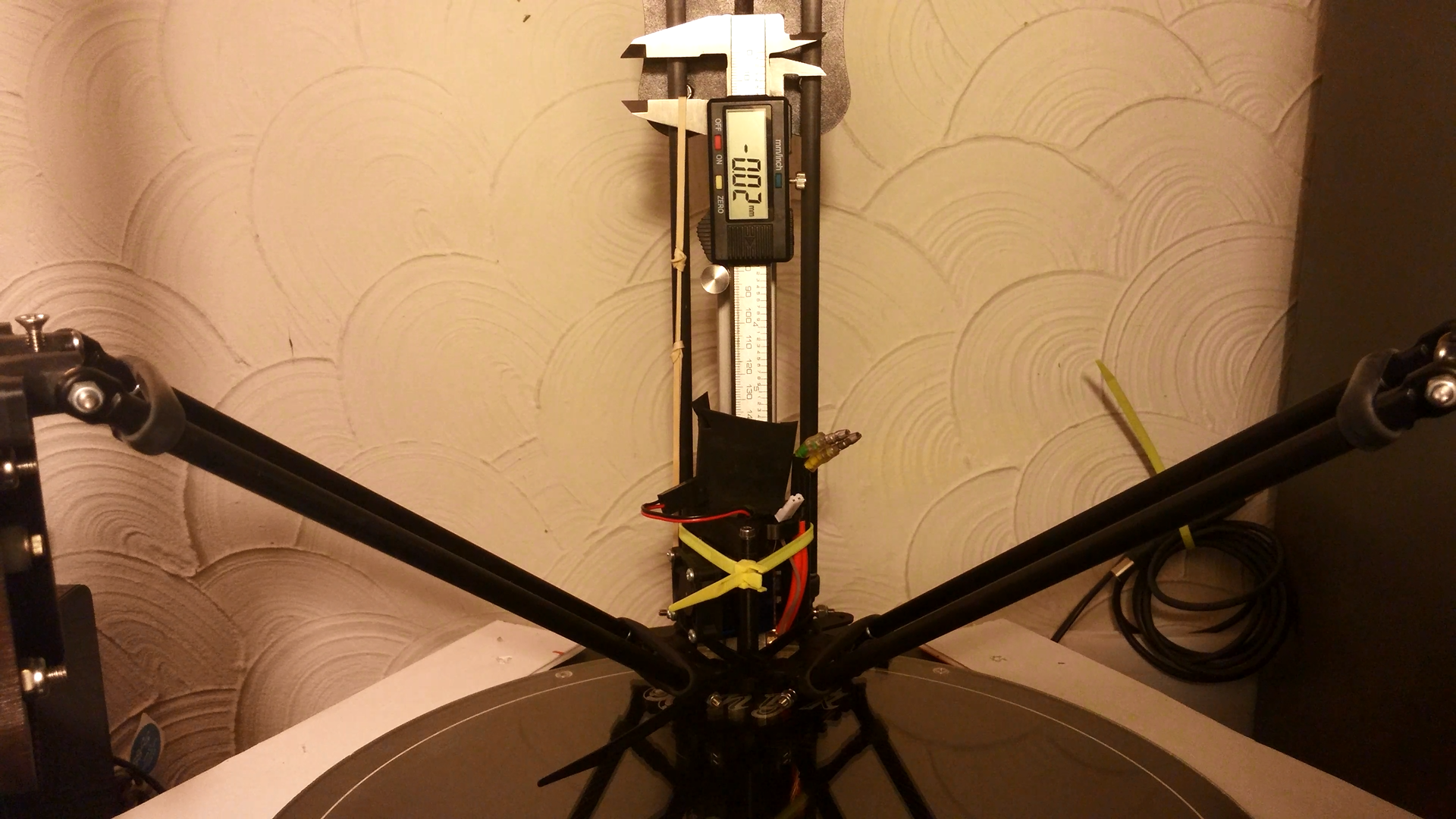

if you don't have a Z-probe. I attached my calipers with 2 zip ties to the side of my hot end, and attached a rubber band to the slider on the calipers and the other end of the band to the hot end as well, this just allows the calipers to have a slight amount of pressure against the plate, giving more accurate results.
Once you're set up to measure the plate, enter this g-code after setting all of your EEPROM configuration back to it's original settings:

How to:
-Run setup for first time use, run .exe for 2nd+ use.
-enter build diameter
-enter baud rate
-select COM port
-check settings
-press calibrate
-when log says "Calibration Complete", disconnect and close application

How To:
Basic Calibration:
-Enter Baud Rate
-Select COM port
-Click connect
-Click Calibrate
-Disconnect
-Close application
-Enter Baud Rate
-Select COM port
-Click connect
-Acquire patience
-Disconnect
-Close application

//What
Based on tests:

To give an explanation of how this program works, I will briefly describe each step.
/* The program in its current state has the ability to calculate your steps per millimeter for your printer if you do not know it(you Really should however), but it is needed to accurately changed the XYZ offset. */
//XYZ offset
This is essentially virtual endstops.
//HorizontalRadius
The program simply averages the heights of the build plate at the towers and virtual towers at the edge of the build plate. This value is then subtracted by each tower to give the new tower heights, and multiplied by -0.5 then added to the horizontal radius. This simply balances the points around zero.
//Delta Radius
Delta Radius is currently bypassed due to changing XY scaling issues. (Replaced with XYZ offset).
//Alpha Rotation
Now, having all non-virtual towers calibrated, the opposing towers need calibrated. This is done partially via alpha rotation.
For instance, when you increase the base value of A by 210 to 211, it increases the virtual tower opposite of the Z tower by 0.5 and decreases the virtual tower opposite of the Y tower by 0.5. Alpha rotation does Not affect the opposite tower of the tower changed or any of the non-virtual towers. Given this, the virtual towers can all be balanced, i.e. the values will all be equivalent but greater than or less than zero (unless you are not from this planet.)

To give an example of what happens when you change the length of the diagonal rod, if you increase the base value, in my case 269 to 270, the XYZ towers will be increased by approximately 13% of the value changed (1, so 0.13mm) and the virtual towers will be increased by 21% (0.21mm) of the value.
This presents an issue, but nothing that can't be fixed! Given the situation, you could either increase or decrease the value of the diagonal rod until all values are equivalent, but then all values will be greater than or less than 0. But since these heights are all the same it can be canceled out by changing the value of the horizontal radius until all values are approximately zero.
Getting through these steps, it is possible to get a theoretical tolerance of +/- 0.0001mm(the programs settings), giving a perfectly flat bed. (Even if your bed was mechanically warped.)
Following these steps, it is entirely possible to calibrate a delta with only modifying values in the EEPROM. That is what the program does for you! Except all you have to do is enter your current settings and then get your new values right back.
And if your calibration wasn't close enough the first time, you can go through again! But that would only apply if you were planning on printing something 1/10th the thickness of a piece of paper.

can you please upload the video so we can all see how you connected the clipers ( i dont have a z probe)

Sorry, I tried rendering the video 2 or 3 times last night before I found out I had a bad driver and it was locking my ram. Anyway, I am rendering the video on another computer, but for now I have attached a picture of my rig. It uses two zip ties, folded piece of rubber(so the calipers don't slider), rubber band, and of course calipers.
As I said, it is a rig, but it works.

2. can you plase take some closeup pictures of how toy hooked the cliper in place?

2. I can't at the moment as I am currently printing parts for a new frame for my printer, the print has about an hour left. Once it is done, I will set it up again and upload a couple pictures from different angles.

Jimustanguitar, how my measurements work (also how the program works), if the bed is physically higher then the values should be negative. Since, some dial gauges/calipers invert measurement, I will add another setting to the program that will correct this, i.e. invert measurements for you.
JFettig, no this simply corrects the horizontal radius. Also, the horizontal radius is not a setting that you can change for each tower, it is for all towers.
The settings that this program changes Do Not affect anything in the XY dimensions, just Z to clarify.

So after 3 iterations I measure about +/- 0.01mm on the points of your gcode.RollieRowland wrote:Jrjones -
Let me know how it works out!
When I measure 169 points starting from the center and going radially outward, all points improved. Here is a chart of my measured points before and after:
[img]http://i3.photobucket.com/albums/y69/jr ... g~original[/img]
Its still not perfect, but it is much improved. I may need to play with the expert settings?
 Measure 169 points.gcode- For reference I included the gcode I used to measure the 169 points
 - (7.2 KiB) Downloaded 1425 times
