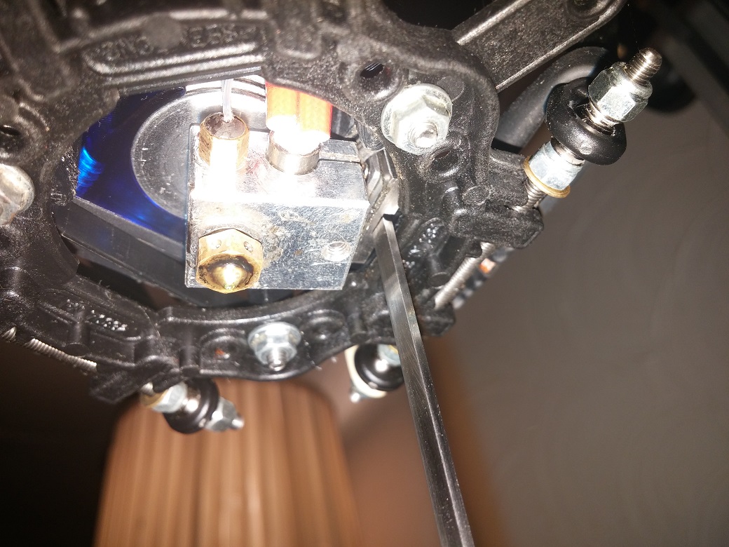

Also, DGBK, since I corrected the XYZ offset to calibrate bed height, the central Z-height WILL change through each iteration of the program. I forgot to mention that.
New post just came in when I clicked submit, when I calibrate the Z-height, I always use a folded over piece of paper and if you can feel it grip the paper but you can still move it easily, then you are fine. This does depend on the layer height that you print at, I always use low resolution - 0.3mm.
I am assuming, I don't know for sure, that the printer starts laying plastic AT zero. I haven't tested this, nor have I looked into it, so if this is wrong then someone correct me.
