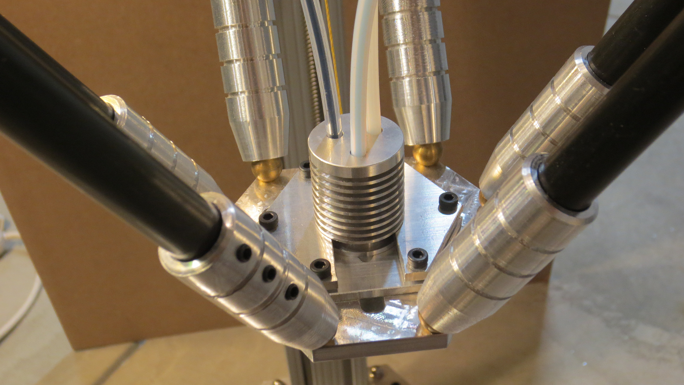

Words are boring, so I'll keep them to a minimum in this thread.
I'm building a large Delta printer. Print space is ~17" (430mm) diameter, ~22 inches (550mm) tall. Right now my design is using fast travel precision leadscrews for linear motion, but the frame is compatible with belt/pulley drive as well. Almost all of the parts are aluminum or steel, made adjustable with tight tolerances. The printer will be fully enclosed with temperature control up to at least 150C, probably higher. I can't yet disclose some of the details of the enclosure. For now I'm using my Tri hotend for triple extrusion on a non-magnetic ball joint effector.
I'll post more pictures as I make progress, and I'm actually further ahead on design and prototyping than I'm showing on these forums.
Check out the Tri hotend!

These are the balls I'm considering. They're 0.375 diameter with 8-32 tapped holes. They come in plain brass and nickel plated brass, shown next to a 3/8 chrome steel ball bearing for comparison.
Unfortunately the threaded balls are not perfect since they were made on an old automatic screw machine. They are round around their central axis, but distorted around the other axis. Sort of like how planets are slightly elliptical because of spinning. The plain brass ones are about 0.0015 to 0.002 shorter than they are wide, and the nickel plated brass ones have backlash flat marks that look to be caused by about 0.002 of backlash in the lathe that made them.
0.002 will show up as imperfections in printed parts because the balls mate to a cylindrical hole. The ball bearings don't have this problem because they are spherical to about a micron. The surface finish is perfect with the ball bearings, but I think it is still workable with the turned balls. The 0.500 CF arms have aluminum cups on them that rub on the ball surfaces, and I don't know how well aluminum on brass or aluminum on chrome steel will work. It feels rigid and it has low friction, which I want, but I want to know how long the arm cups will last with sphere-on-circle wear. I think the surface finish of the ball will matter a lot.
This is what the effector plate looks like mostly assembled. All of the parts are milled flat because 1/8" extruded aluminum bars are bowed. I wanted to make sure this part turned out perfect because the hotend and effector set up is critical to print performance. This thing is as rigid as it gets, and the hotend is perfectly level to the effector.
I'll get pictures of the frame and linear motion parts this coming weekend when I have time. I'm working on the enclosure now.

I had to make a jig to ensure that all of the delta arms are exactly the same length.
I don't have any saws so I can't cut my 0.5 inch CF tubes to equal length. The aluminum ball sockets on each end of each CF tube can slide a bit, and have close concentric tolerances with the CF tubes. They are locked in place with set screws.
The jig consists of two printed parts on a 24 inch long T slot extrusion. The black block on the right has a 3/8 socket with a 3/8 chrome steel ball glued into it. The left black block is flat except for a small detent pit to accurately position a 3/8 ball.
The CF tube with the aluminum ends is placed so the right socket mates with the 3/8 ball on the black jig block, then the other end is positioned with a 3/8 ball in the socket into the left side detent. The left side aluminum end slides to the left until it is pressing the 3/8 ball into the detent, then the set screws are locked. All six delta arms are calibrated this way.
So long as the room temperature is kept within a +- 1 degree Celsius range, the arms will all be equivalent in length to within 1 thousandth of an inch over a 500mm span. I can't think of any way to get more accurate than this without metrology measurement machines.
A delta printer will work pretty well so long as the arms are consistent in length to within about 4 thousandths of an inch; any more will tilt the effector near the edges of the build plate. The black blocks on my jig are printed with PETG.

This looks awesome!
I really like the Tri Hotend effector - any chance you would be willing to share the source for that? It looks to be exactly what I was planning to build for my own large Delta

thetri hot end is a polystroooder  http://www.polystroooder.com .....  they have some pretty awesome engineering inside of them!

Thanks, I know about the Polystrooder and am thinking about using one myself.
I was interesting in the aluminium effector platform for the hotend - it didn't look like the one at Youmagine from Generic Default

Hey sorry for not responding recently, my computer died and I haven't had access to one for about a week. I won't be able to do much here for another week or so when I get another computer in.
The hotend mount is made from machined aluminum extrusions. I do plan on making them to sell later this year. I'll get a picture of the whole setup pretty soon, it's pretty cool looking.
The Youmagine one is meant to be printable and easy to work with. Most people don't have CNC mills or waterjets at their disposal. I'll try to get the gcode and CAD files for the mount shown on this thread if I can recover the data from my old computer, otherwise I'll have to remake that stuff.

If this thing is even near the quality of the Polystroooder I think you'll have the best printer around

I finally mounted one of my Tri hotends on the effector. Looks awesome. I wish I had more than 2 minutes a week to work on this thing, though!
At this point I have the machine moving at standard printer speeds of up to 150mm/sec. Next, I have to wire the hotend and test print, then install all of the parts for the enclosed chamber and wire that so I can print in a 100C oven and eliminate warping.

That is the best arm - effector combination that I have ever seen, absolutely fantastic work!
