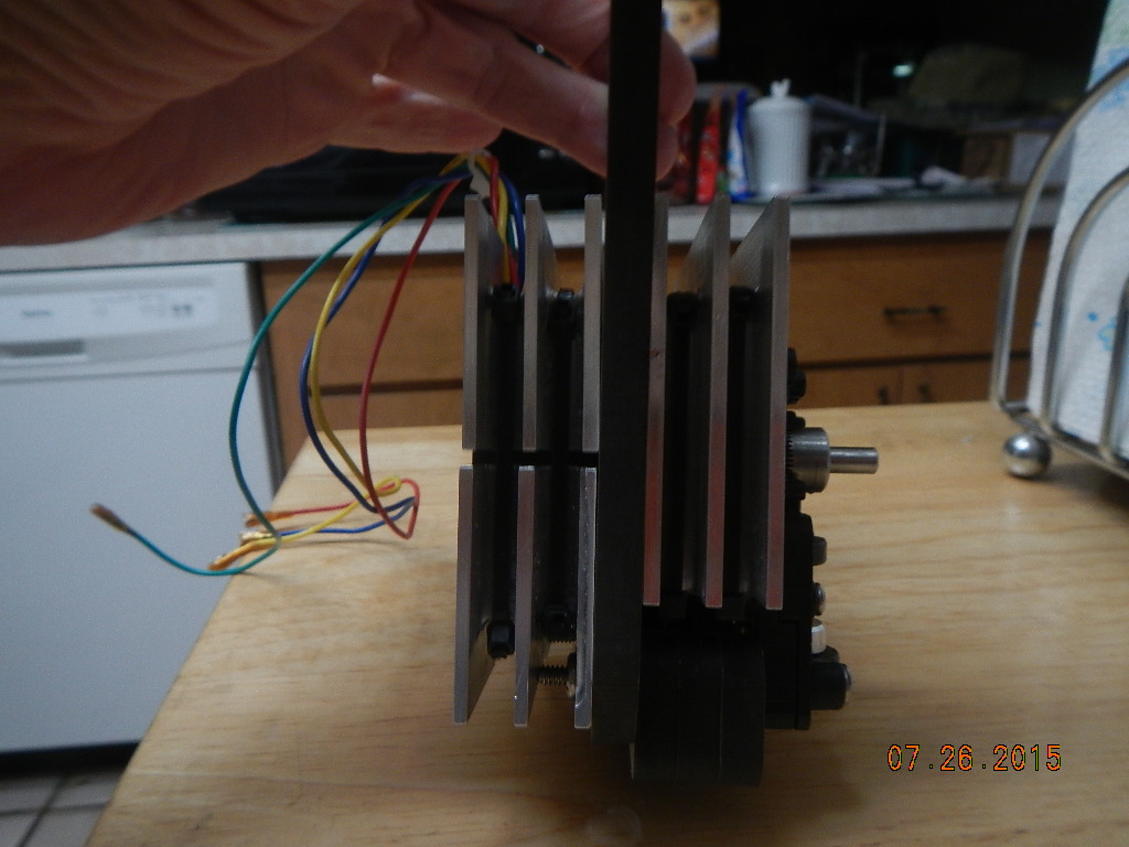

A few days ago I posted about the high heat of the extruder motor, causing the hobbed gear to eat the filament instead of pushing it at the correct speed. I was printing a disk about 5” in diameter and found the problem, the stepper motor was at 68 C which says the gear is the same temp. I made these heat sinks that will fit the Max2 without modifications, attaches with tie wraps. I did the same print which took 9 hours. I painted the hobbed gear black so I could get a good temp reading. Without any heat transfer paste or Fan the temp went from 68C to 38C. After the print I checked the gear, absolutely no plastic in the gear. Heat transfer paste should be even better.
Jack
Draw-Tech

Hi draw-tech,
That's a good idea. Seems like you reduced the temp by almost 50%!?? Either way, even if I read wrong, the temp is lower. So with the lower temp, was the noise reduced? Mine squeaks and is pretty loud. BTW, i figured out my problem. it's the RED TAB on the filament tensioner. I didn't think much of it at first, but there was a small crack that was starting to propagate in the clear cover at the middle screw area. I noticed it shortly after assembly and printing. I didn't think much of it because I just thought the screw was too tight. After about 1.5 days on the LCD print time, filament started to slip (after my post). I decided to take off the clear cover to see what's going on. I tugged on it and it pretty much just separated, so i removed it. Turns out when it's retracting, the RED TAB would move out at an angle. Only does it when it's retracting. Continuous retract would cause the tab to move out enough to have the bearing slip from the filament and would not contact it at all. Small "pop" noise. Assuming, the extra heat played a role, the tab also pushed out and bent the clear cover for it to crack. My solution? Zip tie!!
On another note, I did use Gene's commands and it seems like it did lower the temperature, somewhat. It did help. I noticed reduced temp, but when printing for a couple hrs, it's still close to 80C. But now, it's more like 70-75C and it doesn't just climb to 80C right from the beginning. Temp would actually fluctuate from high to low. Before, as soon as I turned on the the machine and extruded, it'd shoot straight to 80C.

Hi dajay23D
Still running at below 39C no fan just tie warped to the motor, front and rear. I also noticed the red lever deflecting, maybe make one of aluminum, may help to cool the bearing.
I have noticed that the hobbed gear runs only about 3 degrees C lower than the rear or front of the motor. Take a black sharpie and coat the shaft of hobbed gear the inferred thermo reads better. My solution for the cracked cover, trash it now we can see the filament feed.
Draw-Tech
Draw-Tech

You had me at "fits without modifications". And at 30 C less. And at no additional power consumption. How much for a set? I live in Puerto Rico which gets the same rate for USPS as anywhere in the US.draw-tech wrote:Hi dajay23Ddajay23D wrote:well, literally the very next day after I posted, first failed print. Print failed from extruder slipping. I'm not sure what it is, i'll need to take it apart to find out.
Jack
Draw-Tech
