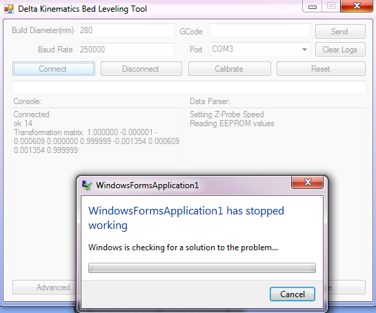

Re: Delta Automatic Calibration Tool - For Repetier Firmware
I thought I would try out the latest but it keeps crashing. Known problem?

mhackney wrote:I thought I would try out the latest but it keeps crashing. Known problem?
Yeah, you will get this occasionally I haven't found the exact problem, but make sure that the com port is open. So, disconnect from any host, and if else try restarting your printer. What version of repetier are you on? Might even be Windows 7, I haven't had a chance to test with that version of Windows, just 8.1 and 10.
Also, I ordered the kit on Ultibots that KAS linked yesterday, from what I read it should act just like what you are saying! I can't wait to get them installed!
I'm running Windows 7, I avoided the Windows 8 "disaster". I have rebooted both printer and Windows. Repetier .92-3 but still have the problem. I can run Mac OS X too if there is an option for that. Otherwise, I guess I'm dead in the water.
Yes, the FSRs are great. I started using them when Johann first presented them and they interfaced into the thermistor port. Frankly, that was a PIA and required using a modified Marlin. This little board lets you tune the sensitivity and has LEDs for visual confirmation of a trigger. From my experiments with 626Pilot's Smoothie calibration, it is very repeatable. You'll like them. The printable holders I designed and posted are perfect. You can find them starting at post 700in my thread.
You want the one with the term "short" in its filename as that matches the Ultibot FSRs.

mhackney wrote:I'm running Windows 7, I avoided the Windows 8 "disaster". I have rebooted both printer and Windows. Repetier .92-3 but still have the problem. I can run Mac OS X too if there is an option for that. Otherwise, I guess I'm dead in the water.
Alright, what I will do is have the program write the unhandled exception to a log in a separate file, that way we can figure out the issue. I am going to downgrade an extra computer to Windows 7 and see if I can find anything out if that doesn't help.
