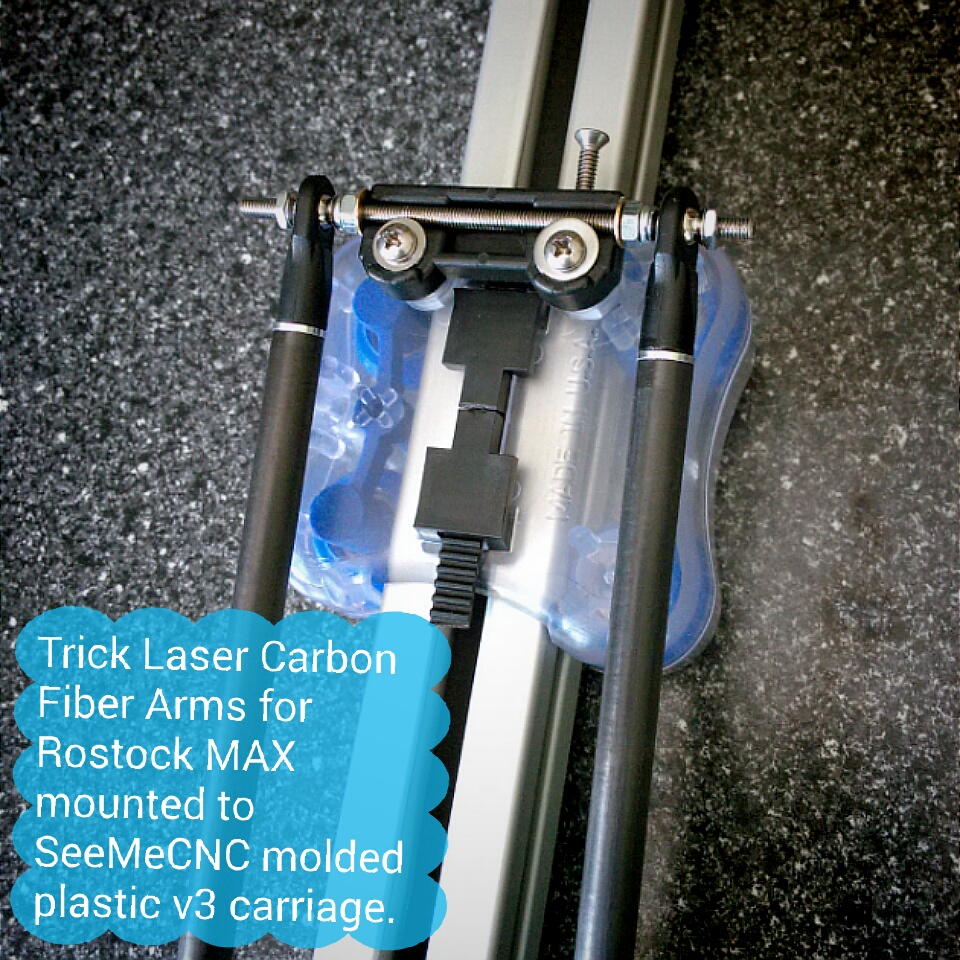

Just a FYI ... the Trick Laser CF Arms do work with the new molded plastic v3 carriage.
We now included M3 fender washers with arm sets to better grip the axles on the new plastic carriages.
The stock washers DO work, but barely, the larger washers insure a firm grip.
(the photo shows stock washer on left and the larger washer on right.)
bvandiepenbos
Posts: 923
Location: Goshen, IN
Re: [25Jul15] Rostock MAX v2 3rd Edition Manual!
Post by bvandiepenbos »
@geneb
We discovered that some of the GT2 belt is thinner than others, possibly allowing belt to slip from the new plastic clamp.
A simple quick fix is to cut a small piece of business card to approximately 6 MM x 15 MM and put it under belt in clamp area.
With the shim the belt will not pull out.
typical card is .010"-.012" thick ( .25 - .3 MM )
I strongly suggest people give their belts a strong pull test to see if shimming is needed.
It all depends how thick belt is, it does vary from supplier to supplier.

geneb wrote:It would be a better long-term solution for them to tweak the clip design a bit, although if the clip engages the belt teeth properly, it shouldn't slip.
When I was at SeeMeCNC last Friday talking with Steve, he said they are planning on revising the injection mold to accommodate the thinner build.
