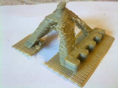

I'm beginner or first time user of 3d printing machine (just assembled Rostock MAX). Now I'm trying to print calibration pyramide object and need help on slicing settings (g-code generation). How to get rid of defects shown in the picture.
Probably it's connected with retraction or z-lift settings.

The calibration pyramid is a little tough for a first print. Too many setting that will impact the quality. You should start with a single wall cube or cylinder to get extrusion rates dialed in. Retraction and lift should not be enabled during the single wall prints to reduce the variables you are dealing with. You do want to watch speed and size of the part as too small and too fast will introduce too much heat in the part which can cause collapse (the top of the pyramid is a challenge area for heat).
Once you get single wall dialed in go for infill then lift/retraction.

Use the essential Calibration set on thingiverse:
http://www.thingiverse.com/thing:5573
Start with the thin walled cube, then solid cube...
