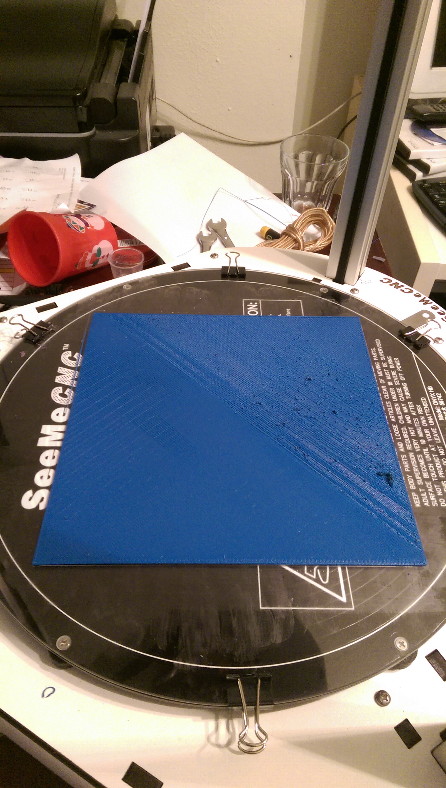

Ok, so I partially disassembled the towers. Took it down to just the cheapskates, no belts. Adjusted them all to what I thought was the same resistance. Then reattached the belts and did the same. Set my horizontal radius to 130 and start calibration from square one. Got it calibrated, and now the nozzle is only slightly off-center, but in the opposite direction. Still along the X-axis though. Z-axis end-stop screw is slightly higher than the other two, but not as bad a difference as before. Any suggestions?

Re: Strange behavior after recalibration
That's what I thought too! So I started the big print that I hadn't been able to get moving yet. Got about three layers in and the nozzle jammed, best I can tell.
I noticed that on the first layer the machine had trouble printing the perimeter lines at the extremes of the X-axis. I guess I should have stopped it, but I wanted to see how it would go, since the model didn't need to be perfect anyway. As soon as I can get back to the machine, I'll put up my EEPROM settings. Maybe there is something I'm not seeing.
