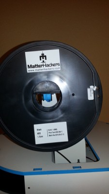

I grew tired of seeing the entire machine shake everytime the extruder tried to pull in some filament. Obviously, it's square up there and the inner part of the spool is round. So, here is something I threw together. Need a little bit of super glue to hold it together, but it sure made a difference in the smoothness. I've seen a lot of complete spool overhaul prints, but nothing that just snaps onto what you already got. Does anyone think this is Thingiverse worthy?

I like what you've done with the mouse ears in the model for bed adhesion, and the thinking behind the "no support" two part approach.
If it works, that's a bonus too!
My concerns (and you'll only know by trying) would be that it still had enough friction to bump, and might be too big to fit into some spools - the nylon from Amazon (desert extrusions, I think?) has tiny holes on the spool.
As to Thingiverse, the amount of crap on there - especially "here's a model I designed, I've never printed it or used it but I'll just throw it here anyway" type of models that can't physically be printed - would indicate that the concept of "thingiverse worthy" is utterly non-existent.
It's a cool design. Do Thingiverse users a favour though. Run your print it for a few prints and if you still like it, post it. With photos to prove that it can be done

Ah, I didn't know that there were spools with smaller holes that the ones with the matter hacker filaments I bought. I can always revise the design so that there are two models for it. I am not sure if the photos showed up, but I did print it successfully (after adding the mouse ears) and it now spins very smooth! No more machine jerking that I can hear from across the house.

I like Genes for the simplicity. Mine is quite a bit more complex. I think the difference may be that for larger spool holes like what I have, the larger semi-circle gives a little bit of resistance so there is a little bit of tension. With the thinner one, you gain simplicity and also the ability to use spools with a smaller hole, but for large spool holes, I don't think it will give you the resistance the larger does because there isn't as much surface area in contact with the mount. I think I will print the one Gene linked so that if I get a spool with a smaller hole, I can leverage that as well.
